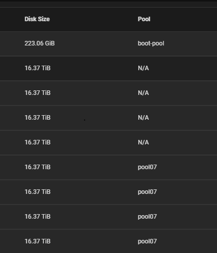

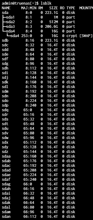

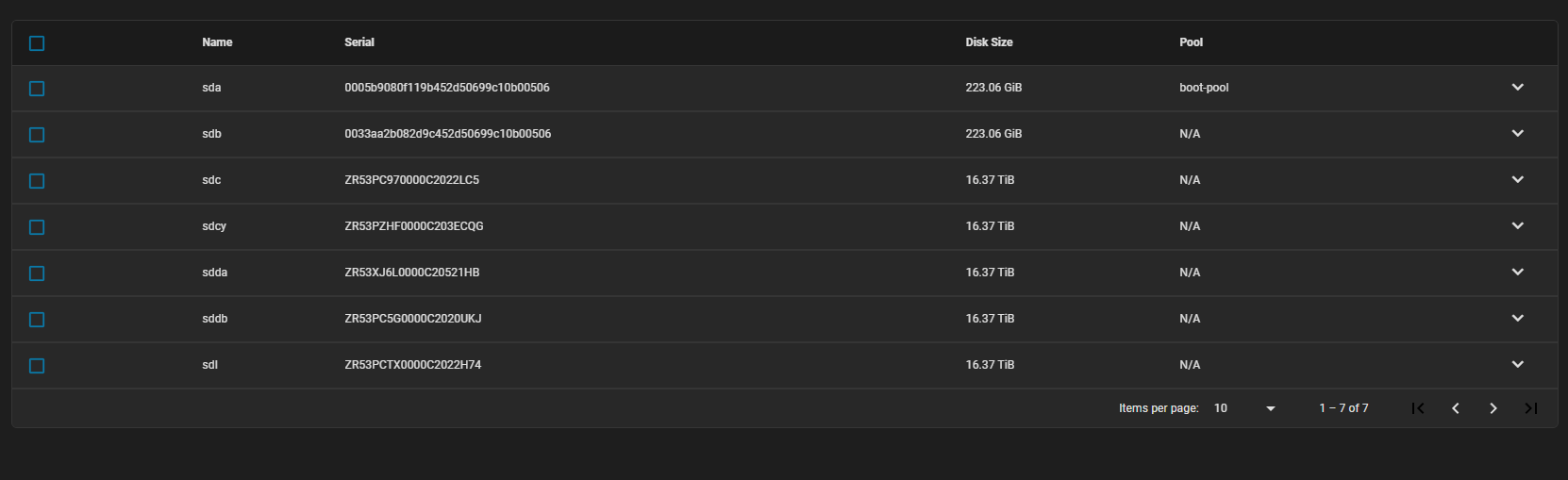

I've recently encountered a peculiar issue with my TrueNAS SCALE setup that I'm hoping to get some insight on. I have several hard drives that are properly connected and appear to be functioning normally. When I use the `lsblk` command in the Linux shell, these drives are listed as expected. However, when I switch to the TrueNAS SCALE GUI, these same drives are not showing up under the "Disks" section.
This is quite puzzling as it indicates the system recognizes the drives, but they're not being reflected in the GUI. I've checked the usual suspects like connections and drive health, but everything seems to be in order. I'm wondering if there's a configuration step I might have missed or if this is indicative of a deeper issue.

Drive model numbers indicate standard SAS drives. Looking at LSBLK, the Smart Data, and pci data, it appears that the serial numbers of the drives are not being passed through to Truenas. That is a requirement if you wish to use Truenas. Truenas currently has no way of knowing what drive is what or where it is located in the system. A result of not passing the drive serial numbers is the duplicating each drive (maybe each time they are accessed?). Currently there appear to be around 34 duplicate entries for each drive in the Smart data which corrousponds to the amount of duplication seen in LSBLK. You are using 2 RAID cards the MegaRaid with the megarais driver and the Adaptec RAID card with the Adaptec card using a RAID driver. One or both cards are not set to IT mode or passtrough mode and Adaptec products are generally not recommended to be anywhere near Truenas from what I understand as they just do not work.
