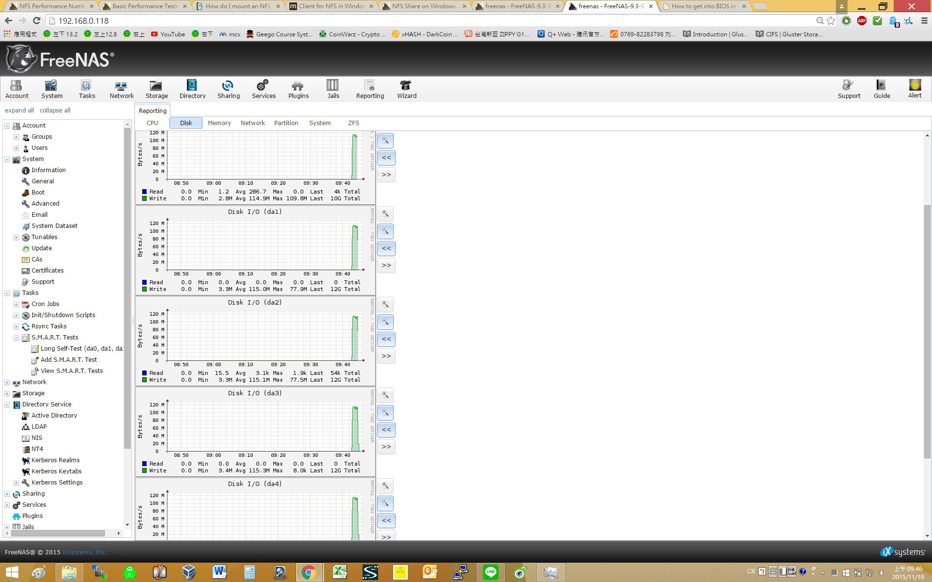

At first I installed Freenas on a SSD then I did some DD for performace test, I was able to hit around 400MB/s and the graphs in the reporting sections shows above 100MB/s per disk.
When I got my transcend USB from home, I did a fresh installation but my performance somehow dropped to 50MB~60 MB in the graphs , and DD test shows 110678105 bytes/sec.
Between Switching the SSD to USB, I have the switched my Sas cable to other cables but upon write test results I switched both the cables and SSD back.
I don't know what I did or didn't do that caused the performance drop. Hopefully someone could suggest me on what could cause the problem. Thank you

problem solved. as it turns out, I set the record size to 4k when creating data and that's what slows down the performance
