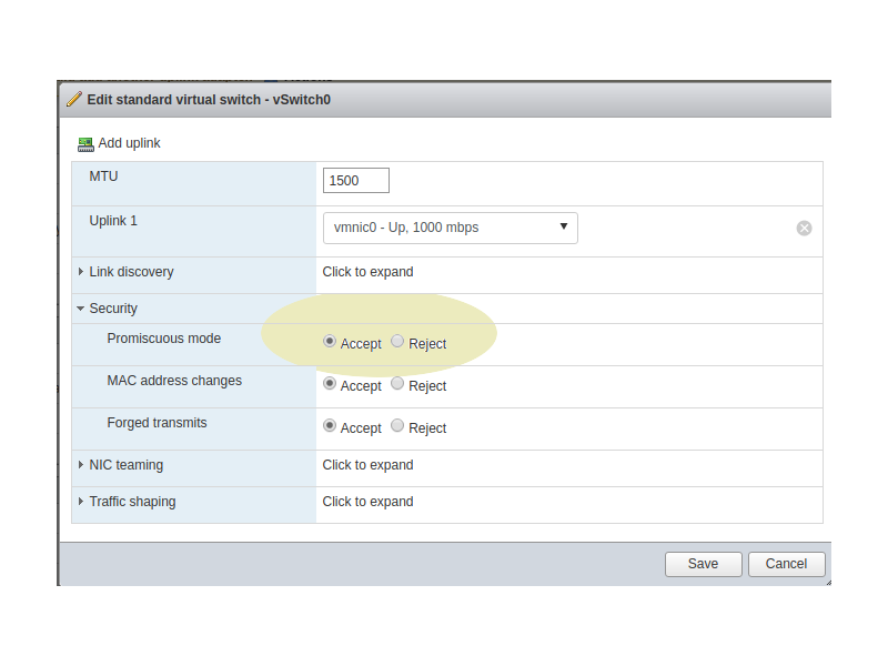

Running FreeNAS on ESXi VM 6.5 and 6.7, jails only obtained an IP address from DHCP in two scenarios:
1 - Host interface passed through, used as the FreeNAS VM interface; or
2 - Host vSwitch configured to promiscous mode, using vSwitch as the FreeNAS VM.
Below vSwitch configuration, highlighting the option changed - Can't speak if that breaks anything else.
