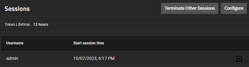

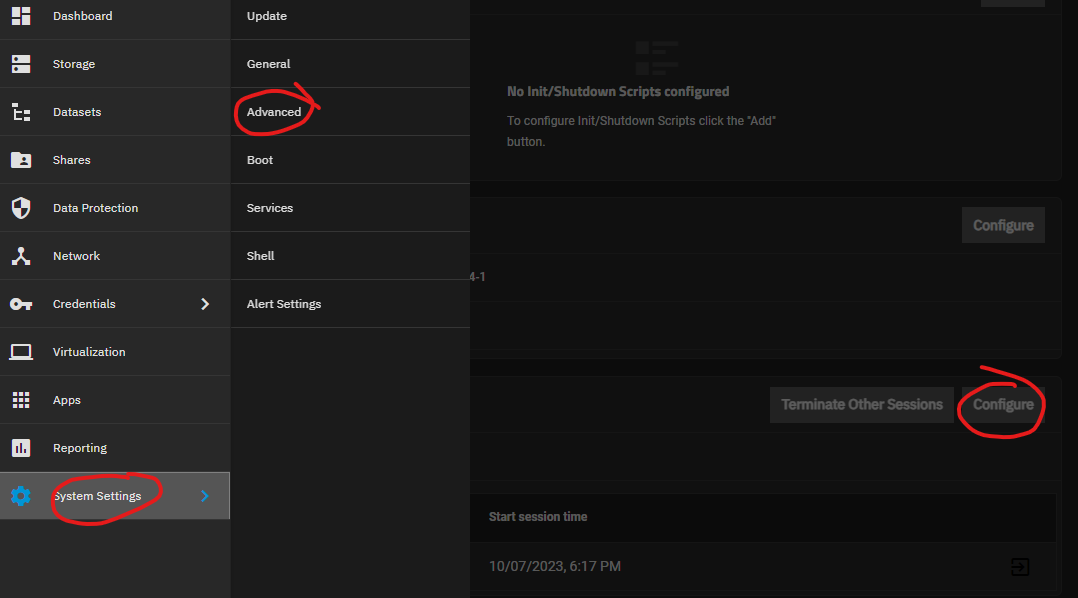

System Settings > Advanced > Sessions
EDIT: Attached snip for future readers of this forum thread.

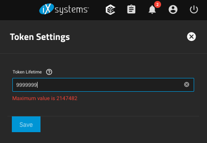

From what I could gather from the following link, the maximum is a around 20 hours:
The default lifetime setting is 300 seconds, or five minutes.
The minimum value allowed is 30 seconds.
The maximum is 2147482 seconds, or 20 hours, 31 minutes, and 22 seconds.
But there must be a typo because 20 hours is 72000 sec
Anyway, I tried with 72000, and some values under, but it still doesn't work.
It seems to extend the timeout above the default 5 minutes, but I'm still not sure what the new real max is.

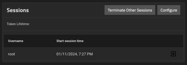

indeed confusing, the max value validation in the field seems to be completely wrong. If I enter for example 86400, 24 hours, I get an empty time in the GUI:
Should we fill a bug... somewhere?
