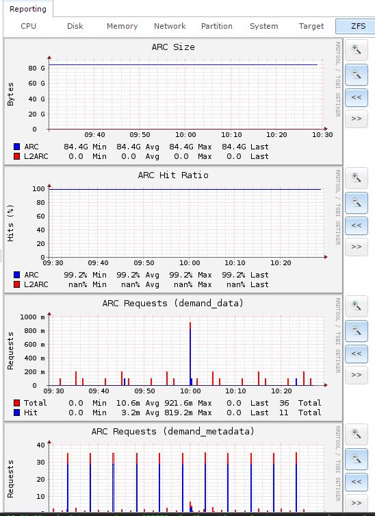

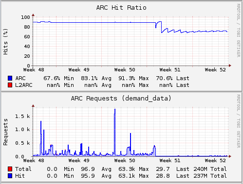

After updating to FreeNAS-9.10.2 (a476f16) the ARC reporting graphs look substantially different than with any other 9.10 version before on my system. In the attached screenshot two reboots after performing the update in the morning of Doc 20 are visible. While the ARC Size graph looks pretty usual, the ARC Hit Ratio and ARC Requests graphs look substantially different that before, using 9.10.1-U4.
Using Bidule0hm's ARC statistics script shows a very low ARC Hit Ratio on my system after updating, too, so it's not only the reporting graphs that are different in FreeNAS-9.10.2.

I think I found the reason why the ARC reporting graphs in 9.10.2 look different on my system. The Changelog for this version has the following entry:
#16901 Bug Ready For Release Nice to have Periodic snapshots - autosnap - generate large demand on ARC metadata.
The ARC Requests (demand metadata) graph showed a rectangular wave behavior in prior versions with high level between 6:00 and 23:00 on my system, exactly the time span during which snapshots are scheduled.
So it seems that the high ARC Hit Ratio I saw on my system prior to 9.10.2 was biased by the (now improved) autosnap functionality.

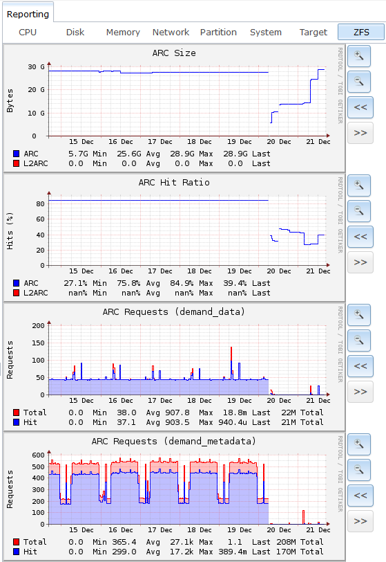

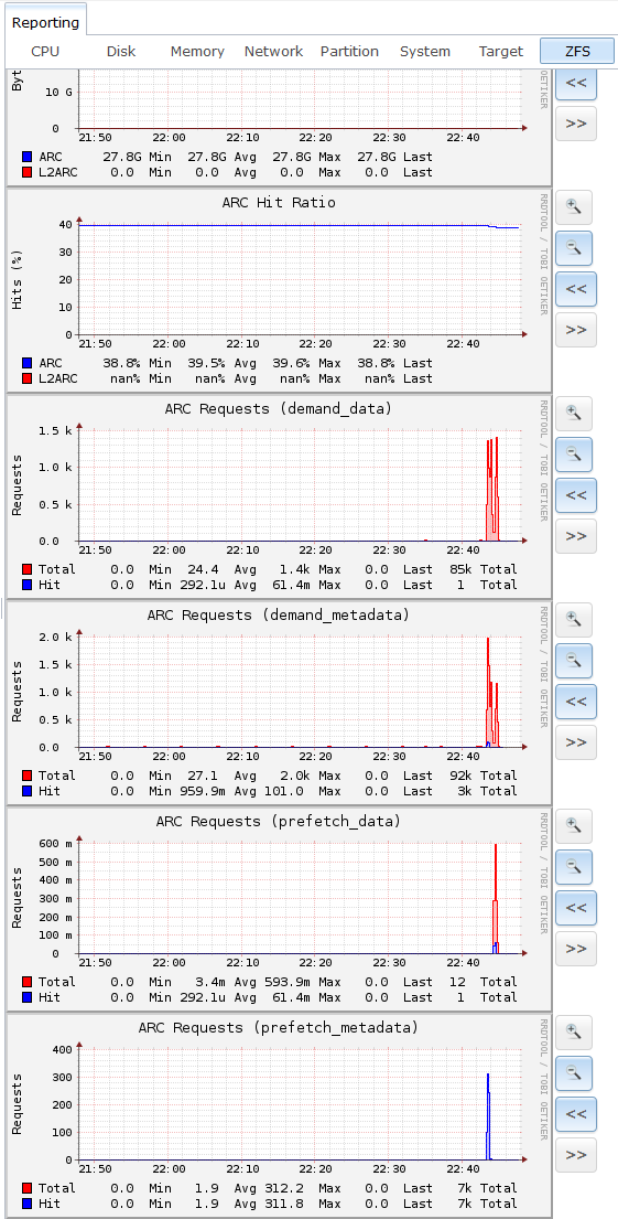

Yeah, something is definitely "wrong". My graphs are below:
As you can see, at least if I'm reading this right, the big data requests look like they are mostly hitting, but the demand_metadata stuff is missing almost everything. This accounts for the low hit ratio, it would seem like.
That ARC usage of about 40% seems pinned. I have watched a few GB of movies, and it didn't budge the needle. Something is definitely up, here. Perhaps we should escalate this. Or, if it's normal behavior, and the old 90'ish% hit rates that we were accustomed to were red herrings given the new snapshot behavior, then we all need to be re-trained, so to speak. Either way we need something in the way of explanation or investigation.

Also, the ARC has been seasoned since the release of 9.10.2., and has had several hundred GB run through it by now. So the ARC is at least semi-mature, and the behavior we have up here seems to me to be the asymptotic reality.

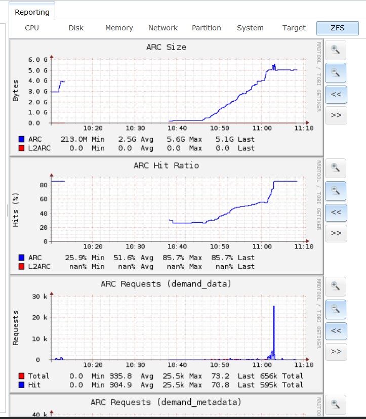

Seems to be depended on actual usage, which is no surprise (see attached screenshot, which shows two consecutive client side file searches using Windows Explorer, both after 22:40).
The fact that usage (no movies stored here) and RAM/ARC size of my NAS system seems to be different, but I also see a almost pinned 40% ARC Hit Ratio in 9.10.2 is at least remarkable.
I always wondered why the reported ARC Hit Ratio in pre-9.10.2 versions was so unrealistically(?) high, I regularly saw values in the 85% range on my system ...
Let us know if you have ideas how to investigate this further.

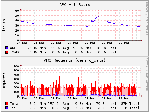

Ahh, if you hit full image it shows the image in the post... Neat!
Anywhoo, those are my ARC stats since December 24th (9.10.2 installed on the 21st). I rebooted after removing L2ARC on the 28th.
While my system was never a hit ratio monster, it used to be a lot better than it is now.

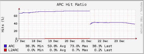

I'll include mine for reference. Not as low as some people people but clearly a drop after the upgrade.
