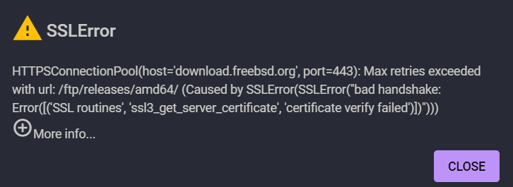

Something new, when clicking on the add button in the jails I get
All of my work lately has been in one jail or another working out problems.
Any help appreciated.

Thanks Patrick. I am on the latest 11.3, and see that I need to update my info.
Further details on the error hitting the more info button shows multiple python 3.7 errors.

Out of curiosity, does anyone here know who to prod to get that certificate fixed? Or perhaps some method to adjust which mirror is being used by my server so that I can actually continue with what I was trying to do?

I looked at the Cert, says expired on the 21 so we can assume it's been dead since midnight. I would think they are aware of it since anyone going there by browser or by software is getting the error. Perhaps Sunday has more to do with it than anything

I'm having the same problem. I just upgraded from 11.3 to 12, and was unable to upgrade or even start my plex jail. I deleted it to just make a new one but I cannot even create a Jail. I don't know what to do. The CA isn't expired. It just isn't working.
The release menu is just blank and I'm unable to select a release.
