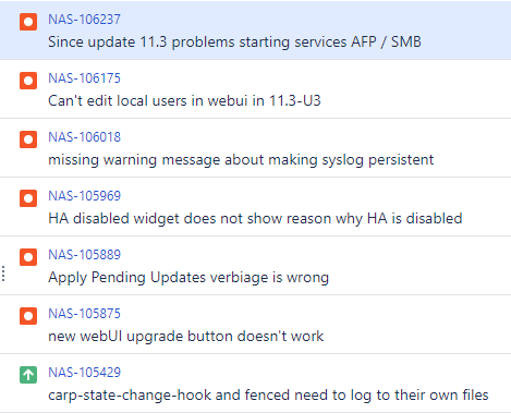

Looks like the user edit bug NAS-106175 is fixed. The Save button is now available for non-system accounts.
Samuel Tai
Apr 24, 2020
5,399
11.3-U3.2 Jira issue tracker shows the following fixes:
