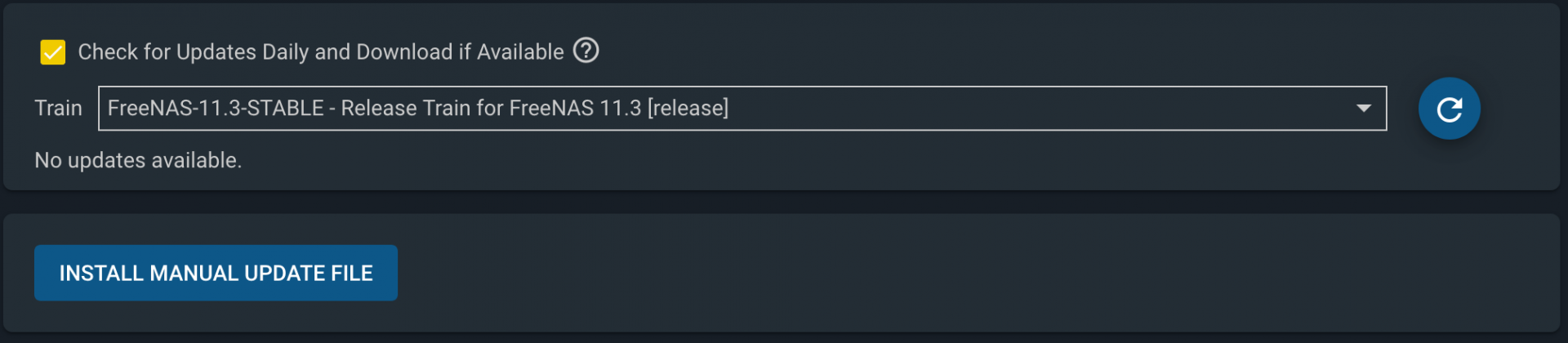

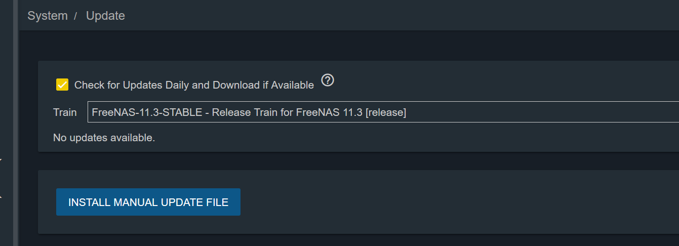

11.3 running perfectly smooth on 4 systems that I personally manage. And why would one boot from an install image to upgrade instead of just using the UI?

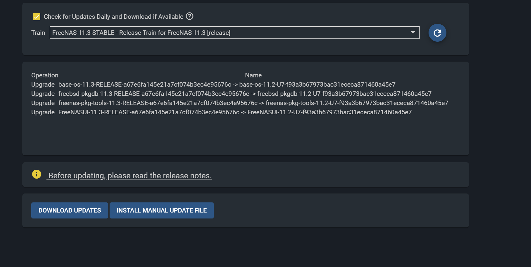

Either you don't understand or don't get my point. It is not relevant, how you install 11.3 because once you run it and get the following upgrade offered to install (see image) you will get screwed
There are more users sitting for a week with this problem
so perhaps you care to help them with how you got your 4 systems work and avoided to be hit by this (for me NOT a Valentine) joke.

You don't get my point. One of my many FreeNAS also shows the same picture you took
But that obviously is not the point and we are not discussing "smooth" but buggy installations. Under certain circumstances users who installed 11.3 are offered a 11.3-RC2 release which for a not yet understood reason installs back to 11.2 and then fails to boot.

The docs say either method can be used. I upgraded all systems via UI as I always do. Boot environments are the best thing since sliced bread, We use them on stock FreeBSD and FreeNAS does the same for you automatically.
Your system got hosed when after the update to 11.3 you clicked for another "update" from 11.3 to 11.2-U7 ... did I get this correctly? Why did you do that? The version numbers are so obviously bogus. I got the same offer from the UI on one system, but checked the forum first, since it was obvious something was wrong.
So, everyone, it is for most installations perfectly safe to update to 11.3. There is currently no newer version than 11.3-RELEASE. So do not apply any other updates afterwards.

"The UI tells you what it will do" This is a good one. See my picture above posted 10:11PM, it tells it will install 4 updates and after that screws the installation. Where do YOU read that it says I WILL SCREW UP?
...and it tells you that those "updates" are a lower version that what's already running on your system. And you blindly charge on ahead, and blame the system because you aren't paying attention to what you're doing. Yes, it's a bug. But yes, it's also on you for not simply reading what's on the screen.

In the section of "system - update" where everything talks about "update" it says "Operation - Upgrade - base-os-11.03..."
So WTF will continue reading that after 53rd character when it continues "-> base-os-11.2" it actually means "downgrade" and not "upgrade"?
Yes I am to blame not to read up till the last character to get suspicious! Come on, in which world do you (we) live? I report a bug and all you have to say is to blame me for not understanding that announced upgrade by big IXSYSTENS means downgrade to a little vafk? Is that how you became WIZARD just by putting your finger into the wound of NEWBIES? Where were you when you discovered this bug and why did you not post the warning? Why did you not call the software architects to correct the bug or even better to stop spreading the upgrade=virus until it gets fixed?
