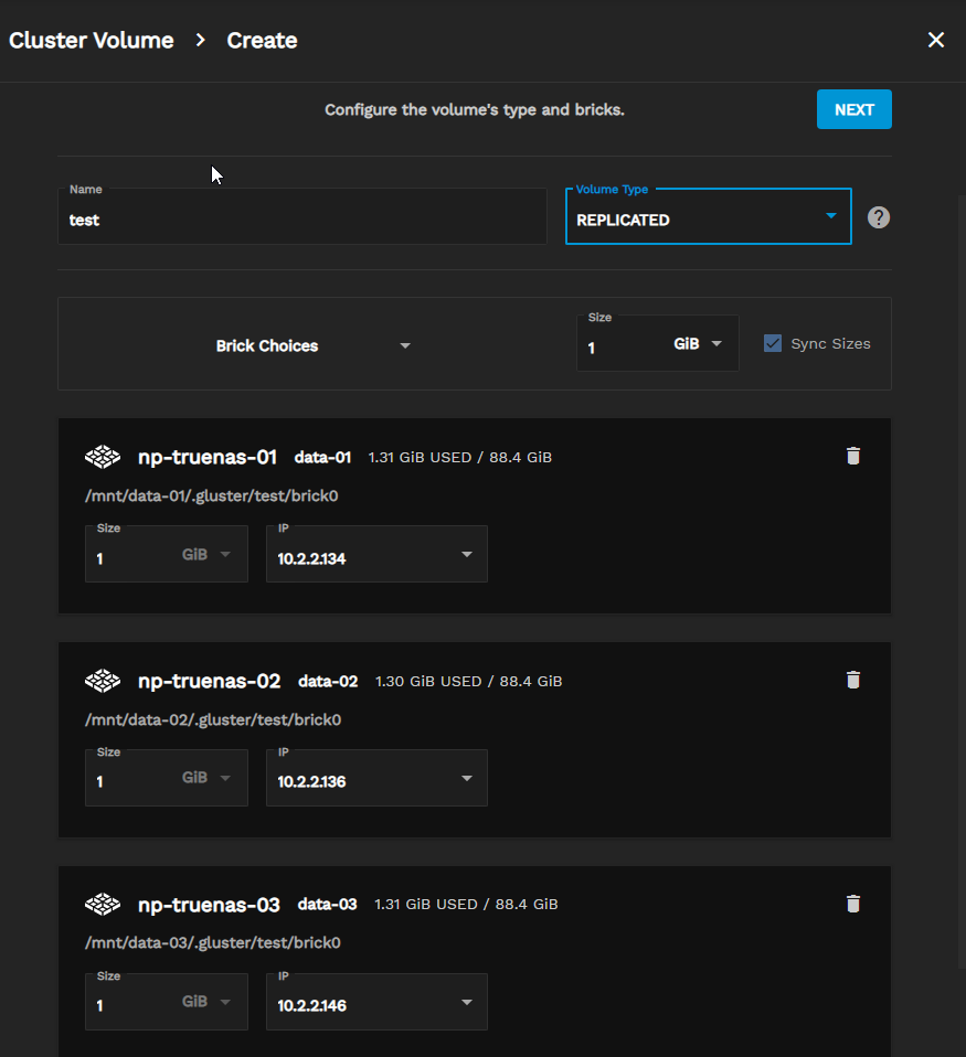

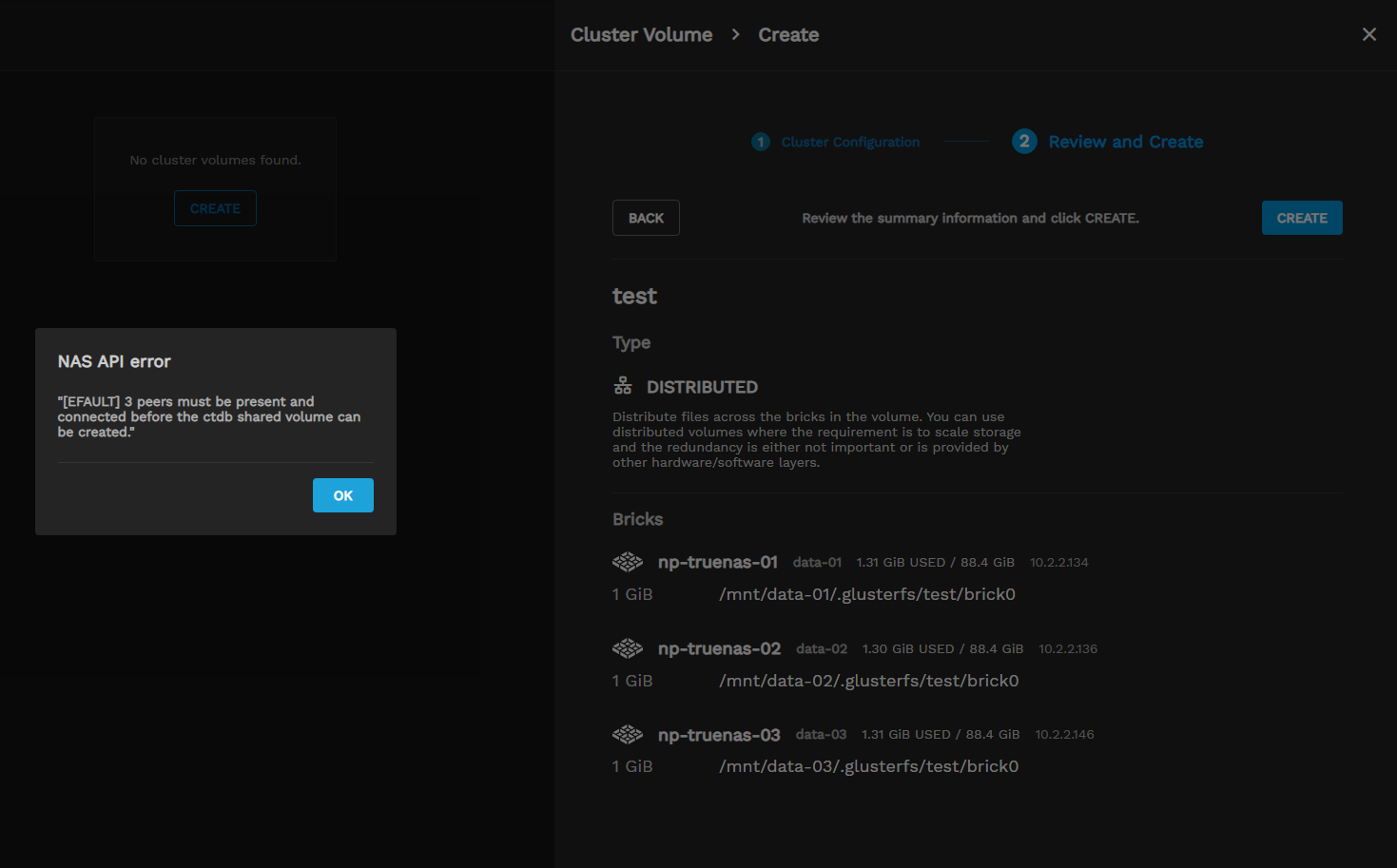

I installed 3 truenas scale systems each having a pool and now I get this error on cluster volume creation:
"[EFAULT] 3 peers must be present and connected before the ctdb shared volume can be created."
I chose 3 bricks but this error still appears. How can I fix this?
I cant edit the post though. So how can I connect the 3 peers? I did not find anything in the TrueCOMMAND GUI to do this?
Dec 2, 2020
6
You connect the peers as you create the clustered datasets...
I did that but I got the error from above.
Dec 2, 2020
6
Were you able to solve this issue? Im recently trying it out on my VMs in preparation of official release of SCALE, just cant really get past this part. Not sure what the issue is. :(
I reinstalled all scale nodes with the latest version and did pass it. But im not sure if it is a random error that might happen from time to time.
