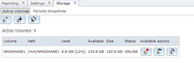

Hi Guys,
I'm trying to create a snapshot of our 1 disk volume. When adding a periodic snapshot, my volume is not in the drop down menu. I realise that I needed to have use ZFS in my volume setup but I can't remember if I did indeed use the ZFS rather than UFS.
Can someone tell me how I can check to see if I did use the ZFS option? or maybe there is another issue at play here
Thanks in advance.

On the volume screen itself, if the volume has a manual snapshot button, it's ZFS. Easy sanity test there.

Hi Ben,
I think you may have answered my questions. Please see screen grab.

That looks like UFS to me. You can copy data from a UFS volume to a ZFS volume easily through many different means. However, I want to urge you to STOP and extremely carefully plan out your next moves. ZFS is not forgiving of mistakes when setting up a volume, and there are many, many stories of data lost and volumes sacrificed on this forum due to ZFS misconfigurations.
