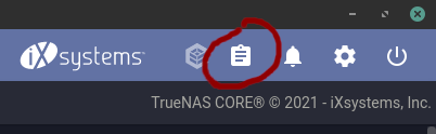

Is there a way for me to monitor the progress of a Snapshot being cloned? I have a 10TB one and the dataset showed up immediately after I triggered it, but its empty and doesn't seem to find any place to track progress or know that it made the dataset but then failed or what. I'm sure this is covered somewhere, but man I can't find it. My one pet peeve with Truenas is how light to non-existent its documentation feels regarding recovery actions. Like here is how to set it all up, including backups systems but if you ever actually need to use those, good luck.

You might see a progress bar, error, and/or log by clicking on the Task Manager icon in the top right corner, then clicking on the process in question (and with a chance to download the attached log file if applicaple.) You'll find middleware processes in the Task Manager, and I believe they are listed in order of the most recent at the top.

That was one of the first places I looked, it seems so obvious that it should show up there, but I see no running processes, just a list of old 100% complete entries.
