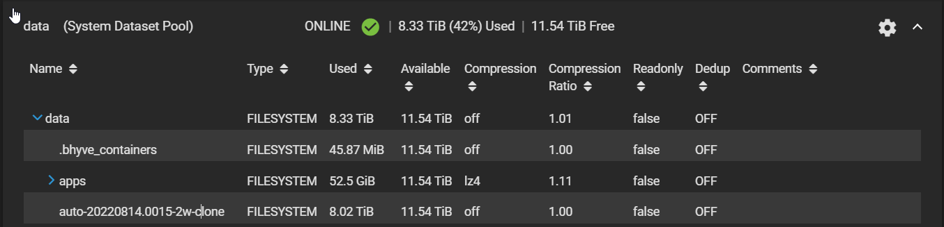

I'm totally stuck here as well. I cloned a snapshot to recover a deleted file. The snapshot was an auto snapshot of the entire dataset.
There's no way in the GUI to destroy the dataset (that I can see)
If I try to destroy from the cli I get:
# zfs destroy  data/auto-20220814.0015-2w-clone
cannot destroy 'data/auto-20220814.0015-2w-clone': filesystem has children

If I use -r, it goes through and shows all the snapshots from the "data" dataset but at the end the data/auto-20220814... dataset is still there.
guermantes
Sep 27, 2017
213
@KenNashua Don't you have the three menu dots at the very right on every line for each dataset. Sort of under the cogwheel in your image. From there you can perform GUI operations on individual datasets, such as deleting clones.
I still don't understand why one would promote the dataset in this context. That seems as bad advice to me, if the purpose was to recover a single or a few files, as it overwrites the newer version from before the cloning with the older version of the snapshot. What if other files had changed?
