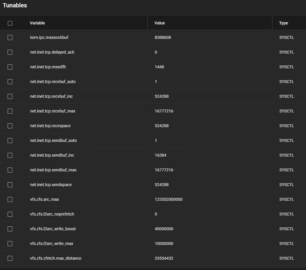

Tuneables

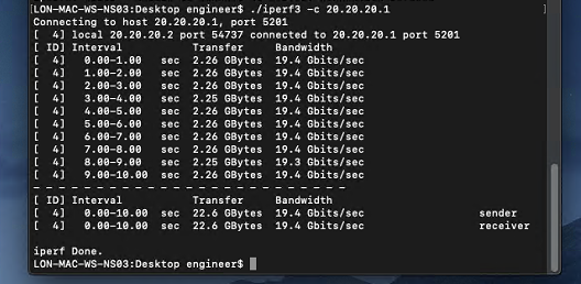

Directly connected at 25Gb with Mellanox Optics, MTU 9000
iperf looks pretty much as expected:

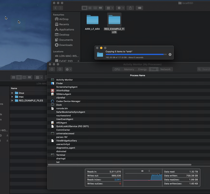

We're trying to move Arri camera media around for either ingest or backup to LTO. I've been testing with test media for the time being, just simple copies to and from the storage.

Moving larger RED files (approximately 5GB in size) I get 1.8/1.9GB/s
which for such a small array of disks is pretty good, read is similar.

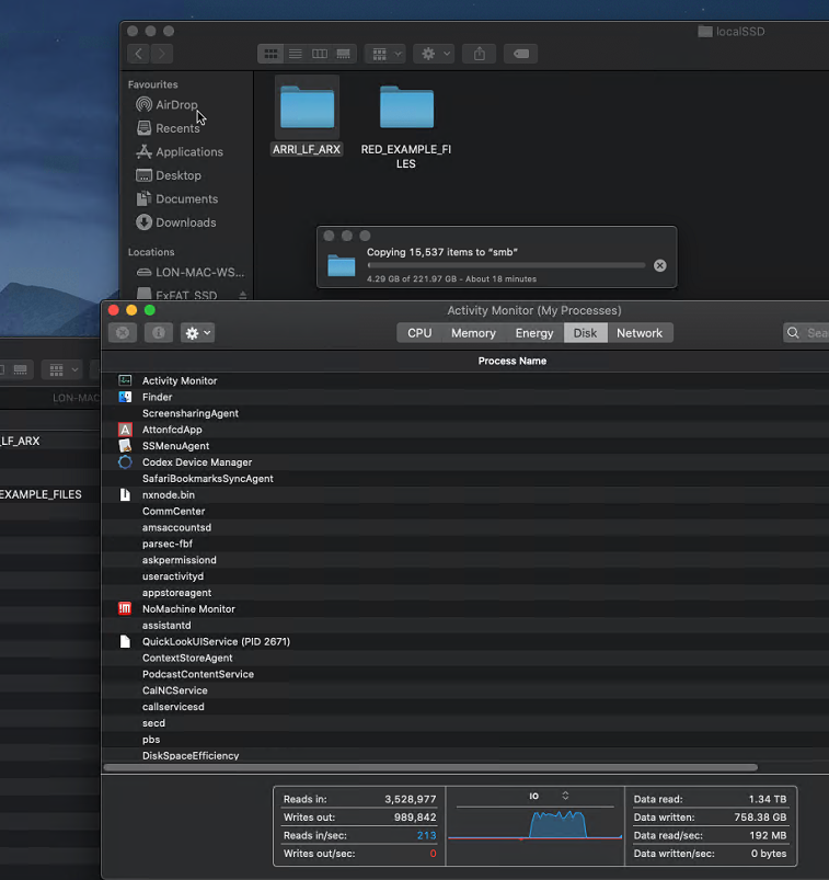

For the 10MB Arri files, however:
200MB/s. Rubbish.
