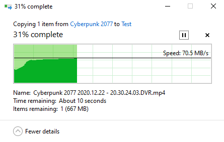

So my main problem is getting useable speeds over remote internet access to my NAS via SMB share. So far I have been only able to achieve 20 mb/s up/down over the internet. This setup was using OpenVPN on my TP-Link AX1800 router, I tried with UDP and TCP with little change in speed. Recently I got OpenVPN working on my Truenas server and tested speeds of 20 mb/s received when port forwarded as TCP. I tried changing the port forward to UDP and speeds dramatically increased to +200 mb/s received to the server.
My main concern learning about UDP vs TCP is UDP safe for an SMB share, data integrity is very important to me (having ECC ram). Does SMB need a TCP port or is UDP perfectly fine in this scenario? I read in one conversation that I could be possibly TCP stacking and hurting speeds?
Local Transfer Rate: 560 mb/s up/down
