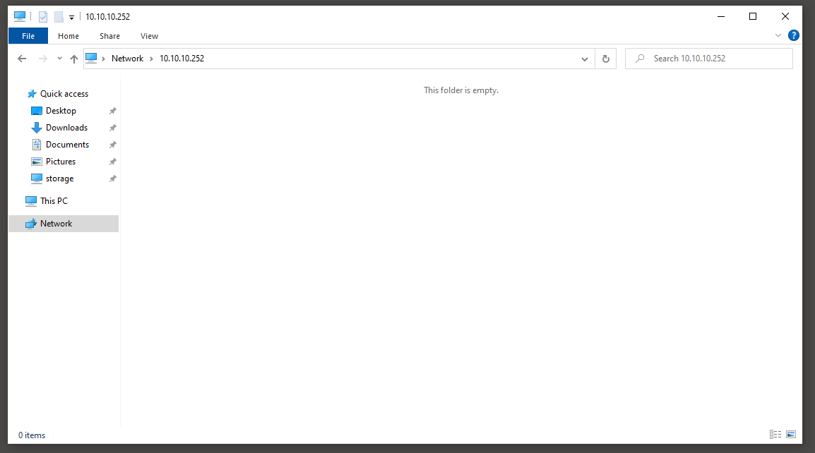

Visseroth
Nov 4, 2011
546
No, it shows as empty.
It's as if SMB is answering but has nothing to show even though I have SMB shares setup and they were working before the U3 update.
