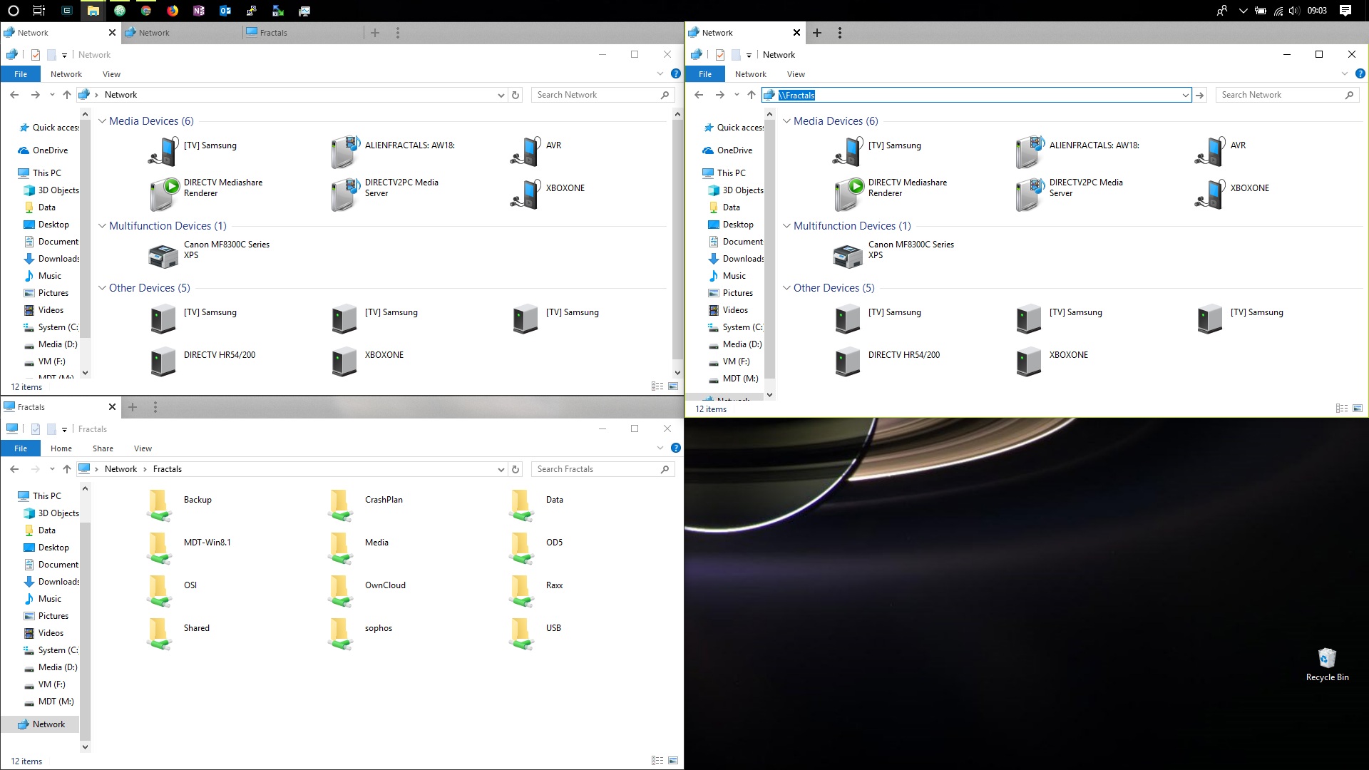

None of the necessary ports you mentioned are being blocked. It looks like the advanced settings are correct as well.
I agree it is easier for clients to use hostnames rather than IP. I'll go ahead and use the %WinDir%\System32\drivers\etc\hosts edit in the short term. However, I'm going to continue to look for a more ideal solution as this solution has two shortcomings.
1) It requires individual editing for each Windows 10 machine as there is not domain controller to push changes in this environment. This is not insurmountable for the current project as there aren't currently very many clients, but I will not be available to make the changes for new computers as they are introduced to the network. Also, this solution may not be viable for larger workgroups.
2) If the FreeNAS system ever changes IP addresses, each of the hosts files will need to be edited with the new address. It would be better if the configuration details remained at the FreeNAS server or router.
I am going to see if I can't get the router to push a hostname entry to the Windows 10 clients (and everyone else) so I don't have to manually configure each client. I still believe that, given this step is unnecessary for other clients, there must be some Windows 10 and/or FreeNAS (SAMBA) configuration that could resolve this issue.

Didn't know this could be an issue as it never seemed to be a problem with any OS except Windows 10 and specifically to a Samba server.
I'm not sure why you're having issues, as I've never been able to replicate the issue you, and others, have had in this thread. Also, I don't believe my last post was accurate, as I conflated two separate issues and just realized it as I was reading your reply. Provided the router, samba server, and samba client are all on the same local domain, there shouldn't be an issue accessing the server with only the hostname of the server in Windows Explorer.
  • Windows 8+ changed how network devices are laid out in GUI form to the user (I forget what the specific Control Panel screen is in Windows 7, but it allows you to see a GUI layout of the LAN you're connected to).
  • When it comes to Samba and Windows 10, there are some issues that are environment specific that I have been unable to find a fix for, let alone how to troubleshoot, however your issue doesn't seem to be Samba related, but network related.
It doesn't make sense to me why navigation occurs perfectly fine via IP, but not via hostname, as they're mutially exclusive provided the router, Samba server, and Samba client are all utilizing the same local domain & workgroup (the latter is specific to Windows).
  • It may prove more beneficial for you to configure an Event Viewer filter to see what's going when Windows is trying to access the hostname via Windows Explorer and what errors it's throwing.

Windows 10 will show all devices under Network, except for Samba servers, so provided one has done the previous things mentioned, all one needs to to do is enter the host name of the Samba server in the address bar in the format of \\HostName
