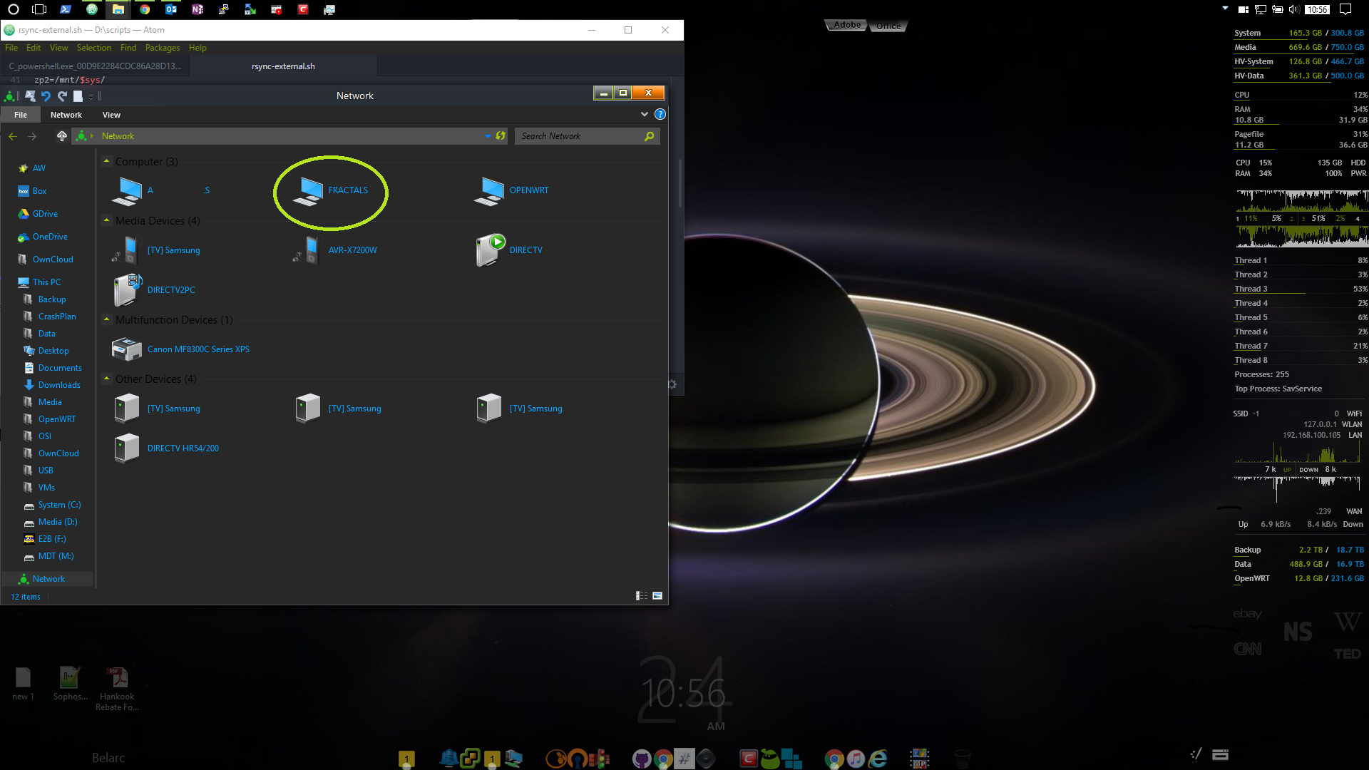

Why would you expect Network not to list a Samba server serving shares? ...That's the purpose of Network after all, to display networked devices the Windows machine is connected to. See screenshot...

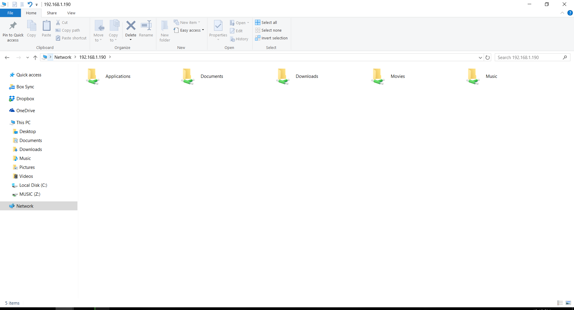

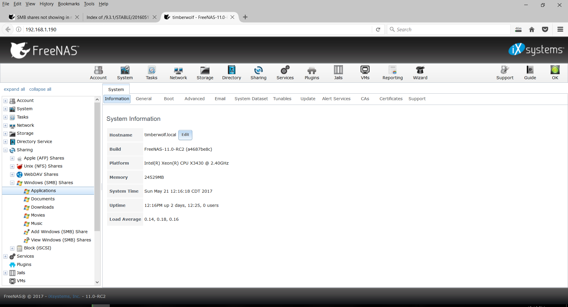

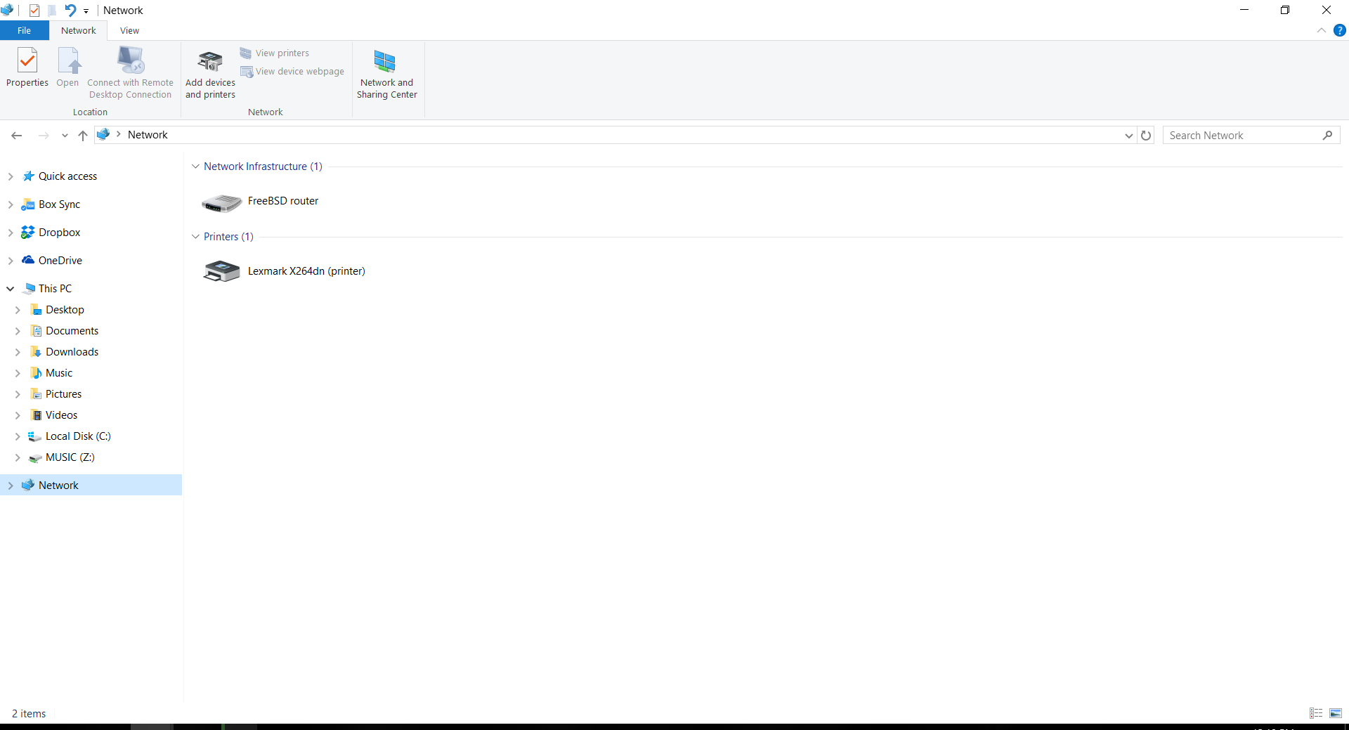

As I said it does not show up unless I type in the ip address. See the attached before and after screenshots with the shares added in freenas and yes they are browseable I typed in my username and password to get access.
