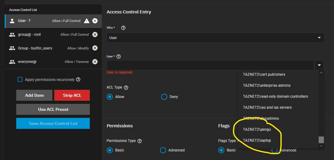

Upgraded to 21.08 and trying to learn my way around.

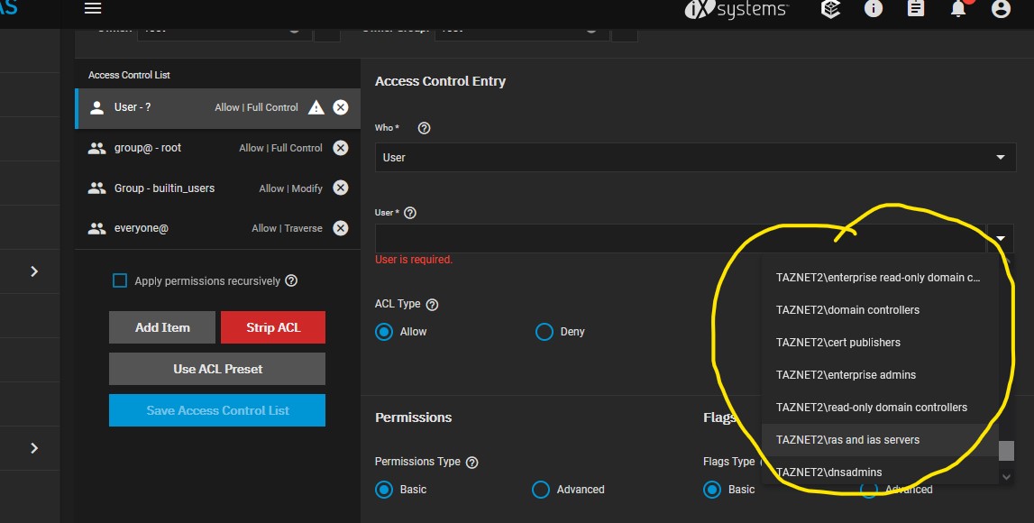

If I create an SMB share and try to give a specific domain user permissions, not all domain users are listed:
Same with a group:

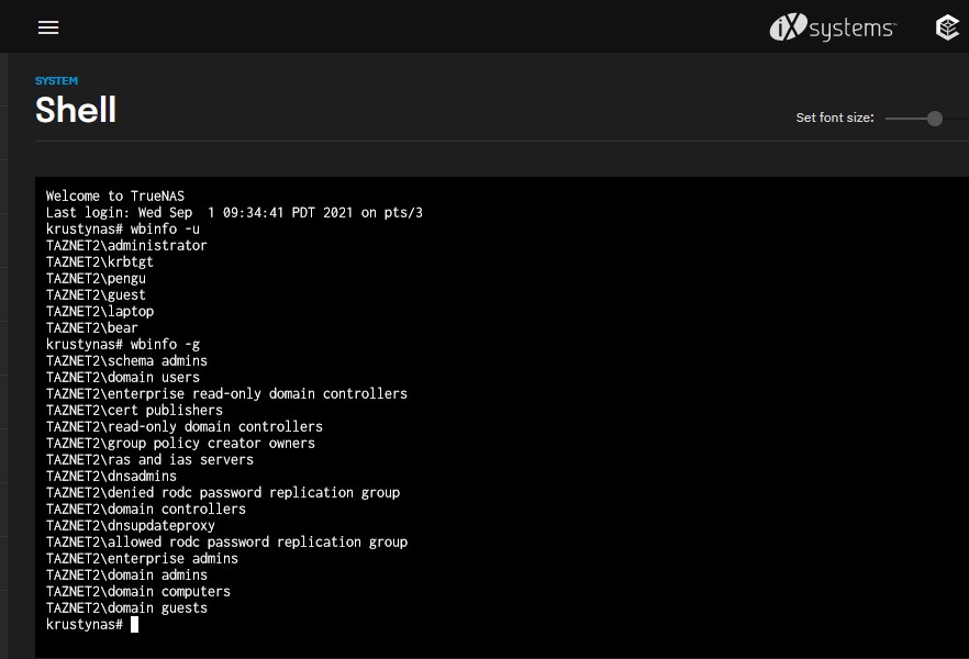

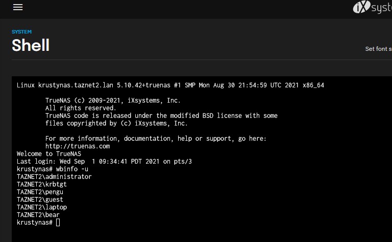

Issuing the command wbinfo -u shows all the domain users:
Same with wbinfo -g
Shares created before the update to 21.08 still work, but I can't give permissions to say the domain admins group. It is not specifically listed.
I don't know what to make of this. Thoughts?

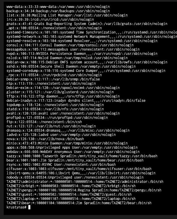

I think I don't know the right syntax for that command.
I tried it and got this:
So I tried a user:
I did a brief search and tried passwd:
And groups for good measure:
It seems fine here, so maybe this is a bug in the new code? Maybe I have something set wrong?

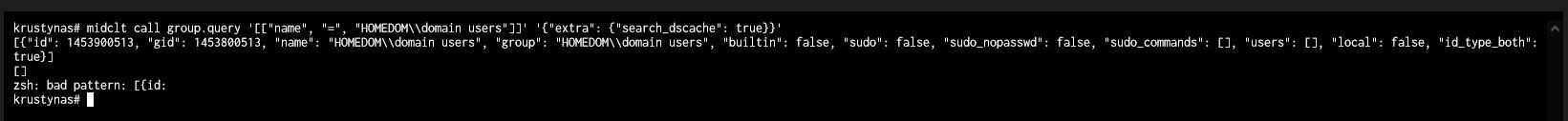

tn23# midclt call group.query '[["name", "=", "HOMEDOM\\domain users"]]' '{"extra": {"search_dscache": true}}'
[{"id": 1453900513, "gid": 1453800513, "name": "HOMEDOM\\domain users", "group": "HOMEDOM\\domain users", "builtin": false, "sudo

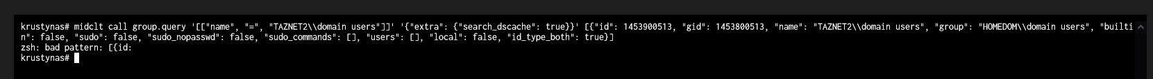

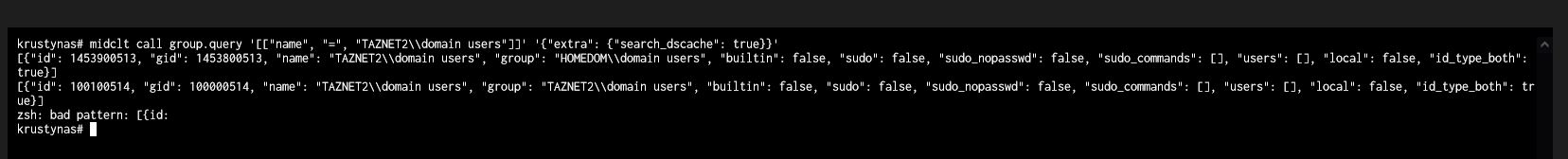

I tried to follow along but your commands are way beyond me. I'm assuming 'HOMEDOM' I would change to my AD domain name? I did that and the command output was:
I tried leaving it the same:
I thought maybe there's some goofy word wrap happening here so i tried connecting the command:
Yeah, I wasn't able to get this to work. What did I do wrong?
