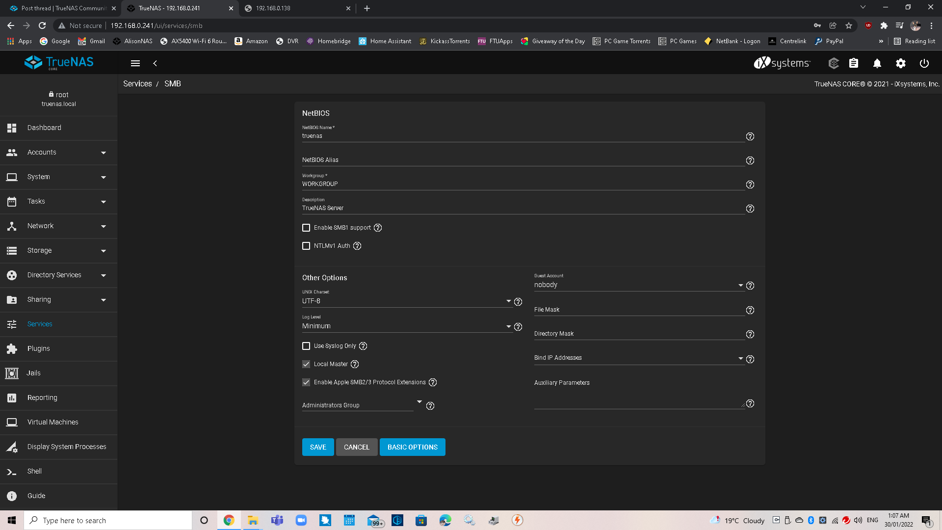

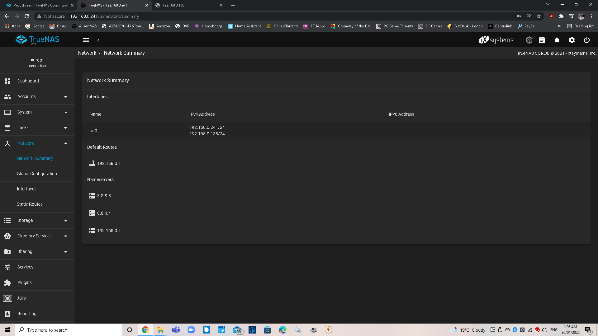

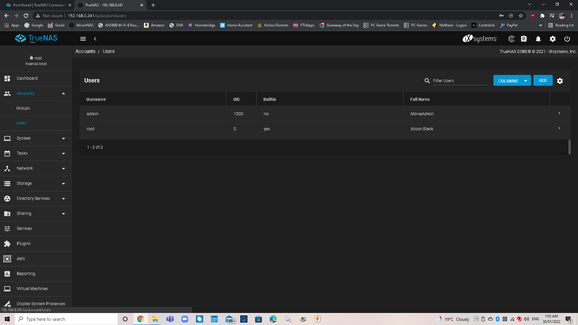

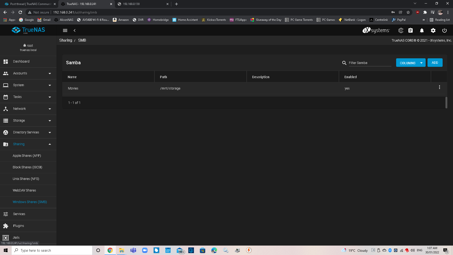

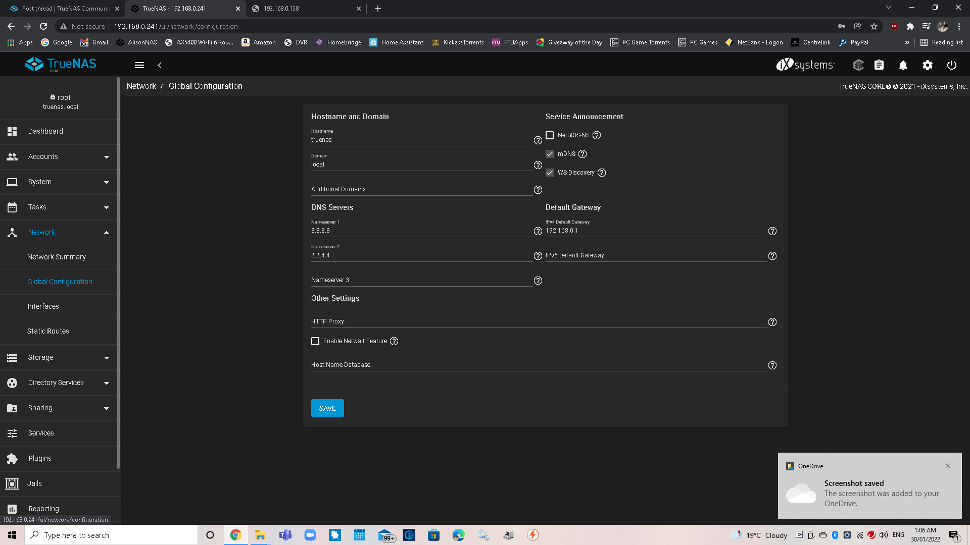

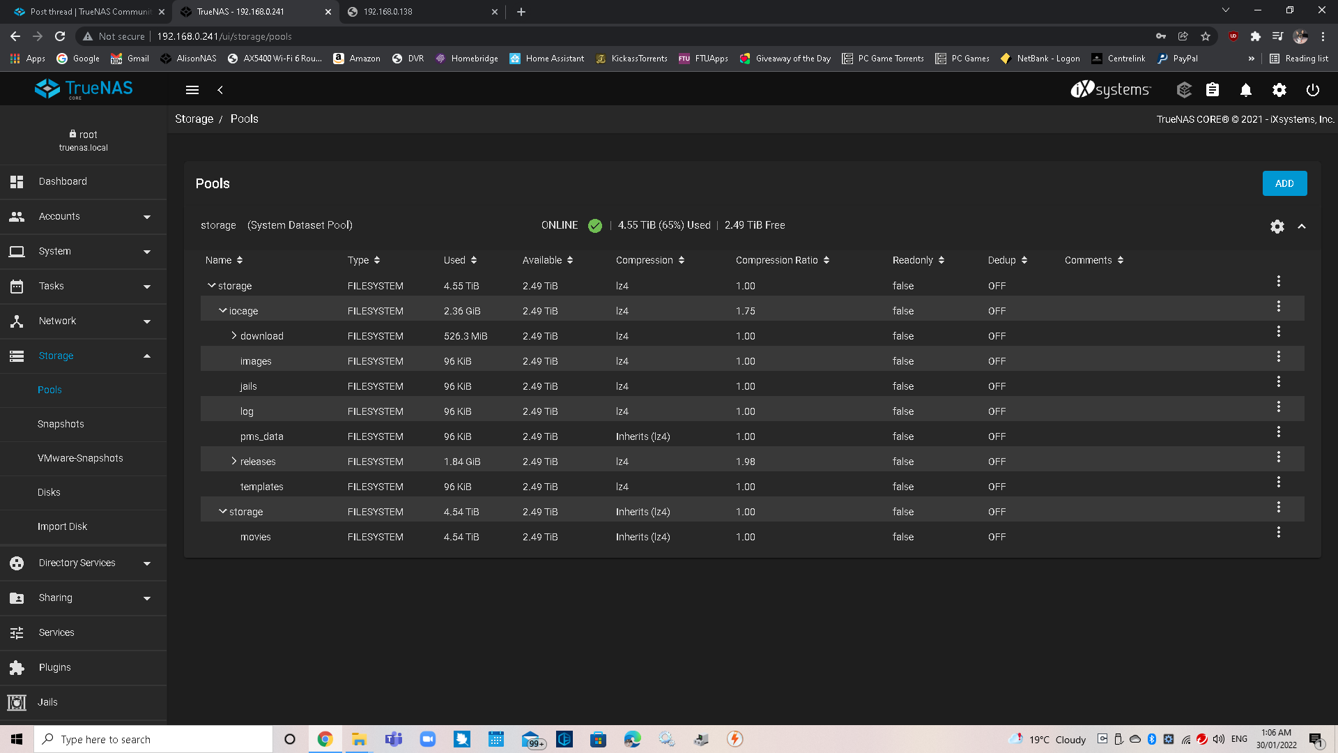

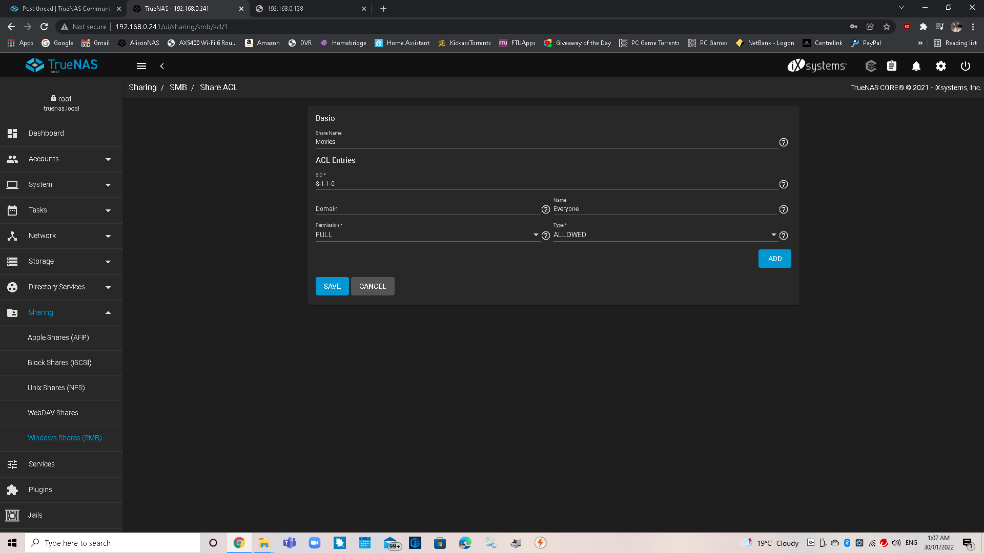

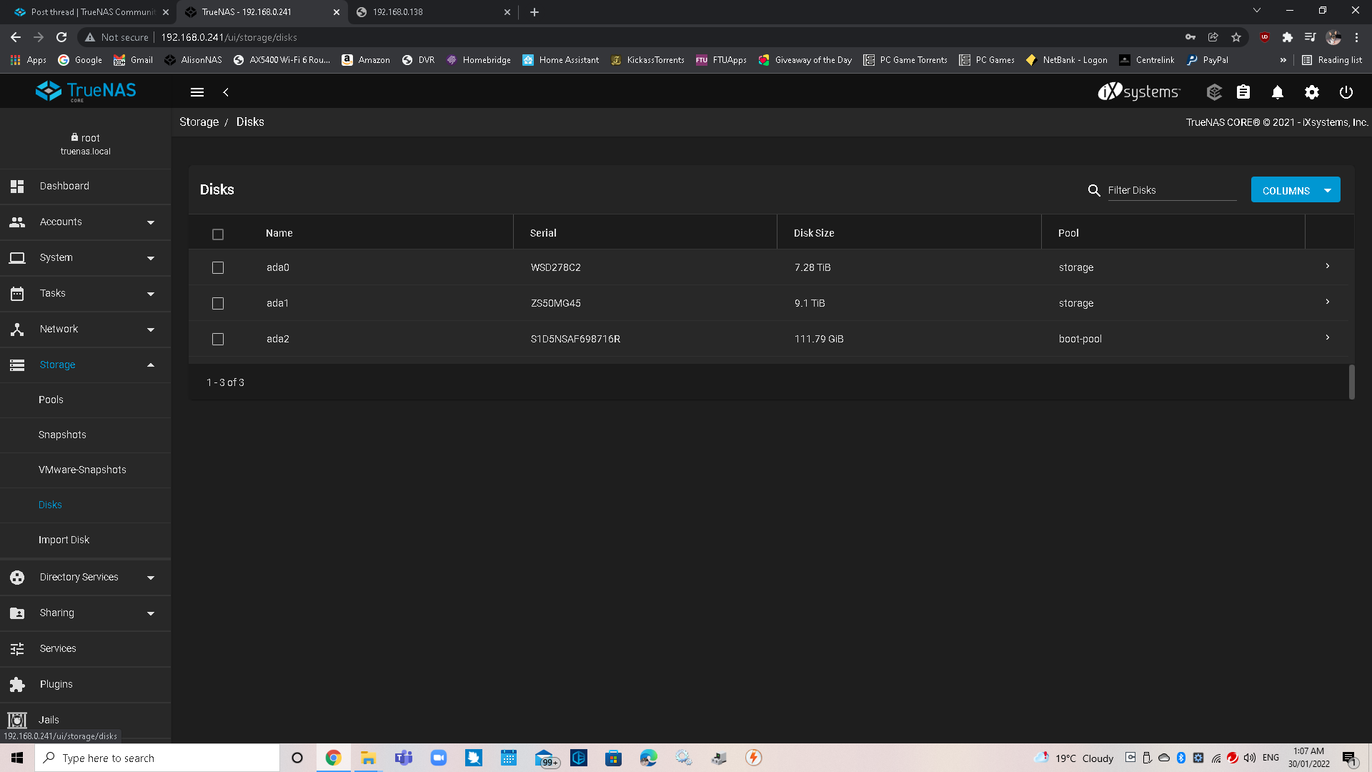

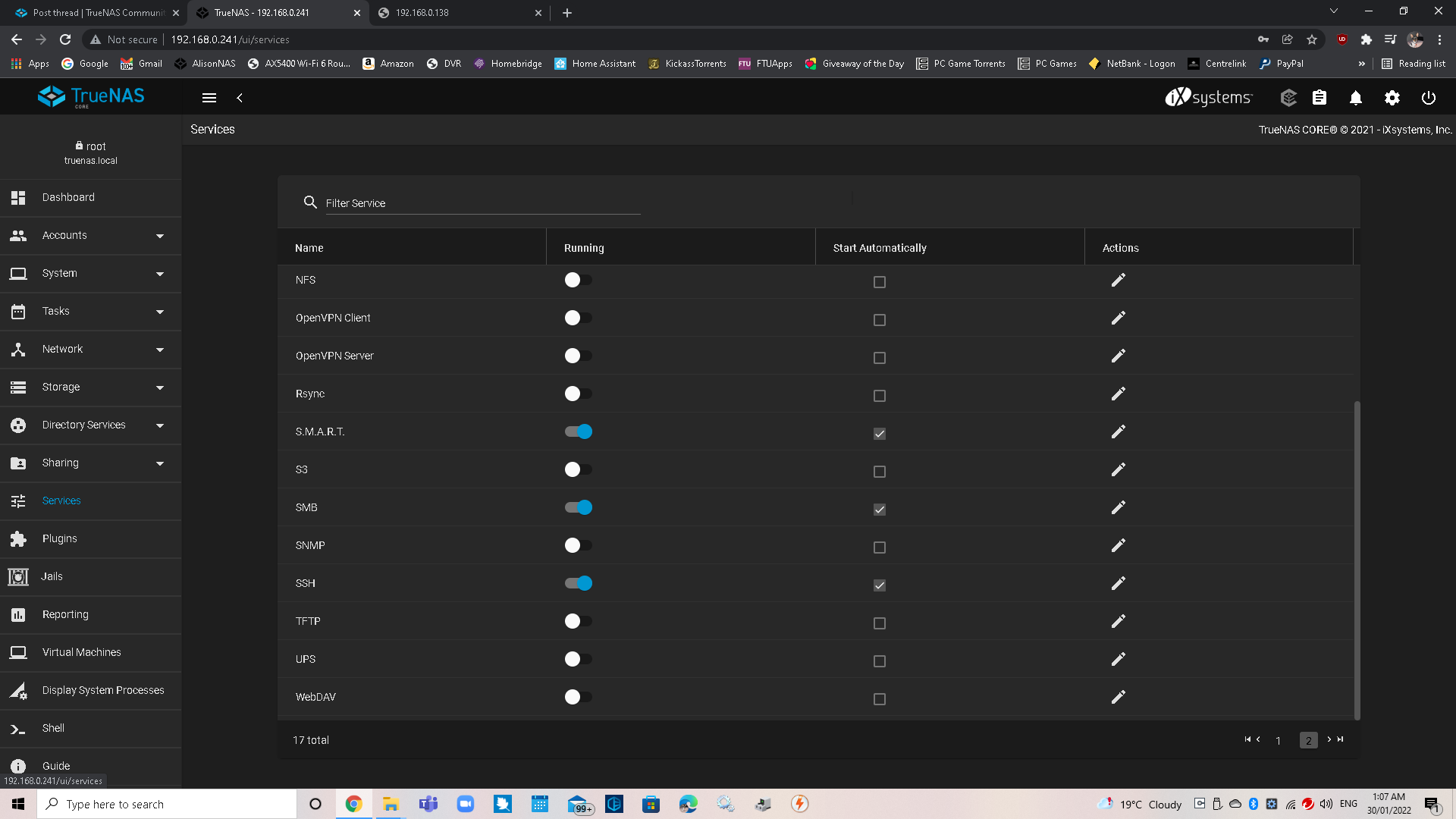

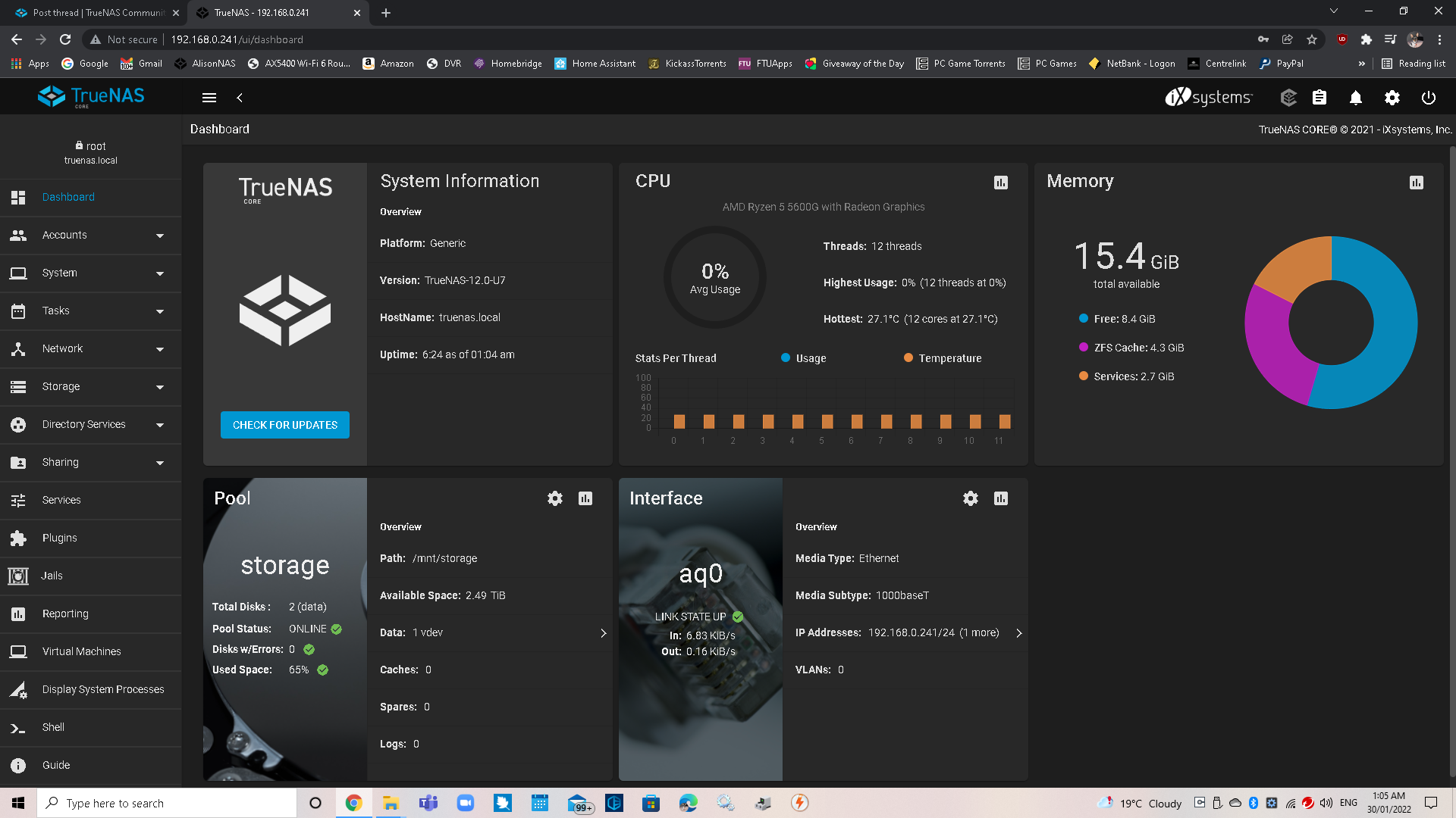

I am having an issue with SMB share. For some reason the system just does not connect. I am forced to reboot my NAS in order to access my files and movie server. I watch my Movies from an Application on Apple TV called Infuse. I have ran SMB share perfectly fine with QNAP and UNRAID before I switched to TureNAS to keep a RAID type configuration. QNAP had disk number limitations and UNRAID worried me. Though I am having some other issues with TrueNAS that the others didn't have, such as plugin problems, which I am trying to solve.
I can reboot my system and watch a full night of movies without any issues at all. When it gets time to be watching movies again the next night, I cannot get the movies to load. I am told by Infuse that TrueNAS is not responding. I then need to login and do a reboot. There is nothing I understand that can be causing this. I am not very knowledgeable in this type of area, but I have checked all of the common settings that I know. There is nothing out of place with my network or settings, somehow it just becomes Unresponsive. I have also noticed the Mapped Network Path for my NAS keeps disappearing on Windows 10, but I know this can be a common issue. I have created a shortcut to help this and hoping the 2 are related. I will post screenshots of my system and all network and settings for SMB and ACL etc.
I am running TrueNAS-12.0-U7
16 GB RAM DDR4 3600 Mhz.
Ryzen 5 5600G 6 Core CPU
Gigabyte B550 Motherboard
ASUS XG-C100C 10GB NIC
Samsung SSD 840 EVO 120GB Boot Drive connected through SATA
Storage 1 x 12TB and 1 x 8TB Seagate Ironwolf Pro NAS Disks running Mirror (temporary configuration, upgrading to RAIDZ2)
I wont post Modem values as I know it isn't the culprit.

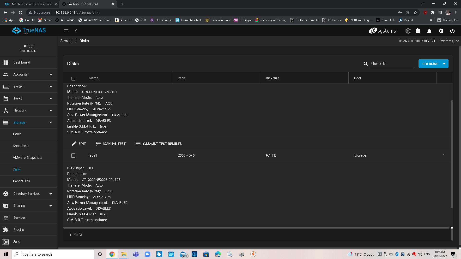

I have included my HDD' Power management settings and standby settings (Unsure if they are the culprit)
Edit: Last Screenshot will be added in a reply post due to limits on images.

>Infuse is connecting via SMB share name.
You never really connect through a share name. You connect through a <server name>/<share name> or <ip address>/<share name> in most clients. The former case relies on either hosts file, DNS, mDNS, or NetBIOS name resolution in order to find the server. Working in one case but not the other also gives clues about where the problem is.

Thank you for the explanation. Which would you suggest me to connect for best results? The IP address/share name ? From looking at your explanation, I can see how I am currently connected could cause some issues. It is just connected using truenas.local at the moment.
If your IP address is static and this is at home I see no issue with just using that. It's probably the most reliable way of doing this.

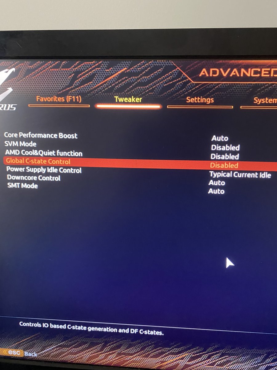

I have changed some settings in the BIOS, I have included a photo of the current settings. If there is any others there you can suggest, please let me know. Thanks

It appears the settings we have changed have helped greatly. I’ve had 2 days without any lag or non responding shares. Thank you for your help.
