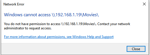

The Problem: Movies cannot be accessed by anyone outside of the wheel group. I have set all of my ACL's to what I believe is correct, and it always comes up with permissions denied.

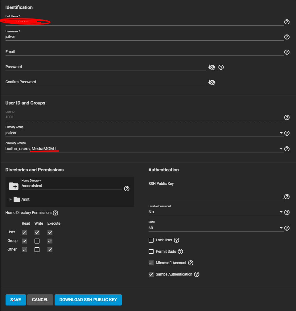

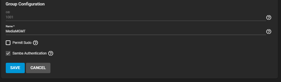

For reference: I am using two users for testing. One is "jflint" who is a part of the groups: "wheel", "jflint", and "MediaMGMT". The second is "jsilver", who is a part of the groups: "jsilver", and "MediaMGMT". I am not using root to attempt to login, just wheel group on jflint. Everywhere I have asked, people seem to just assume that is what is going on without reading it. It's been making me quadruple question if I am or not, so confirmation would be nice, but I assume they are asking if I'm logging into the share the same way I log into the webUI. I only log in using one of the two accounts previously mentioned. jflint, and jsilver. jflint is going to be used to connect to NAS on my personal PC's for management sakes only. jsilver is what want to use for plex service mount.

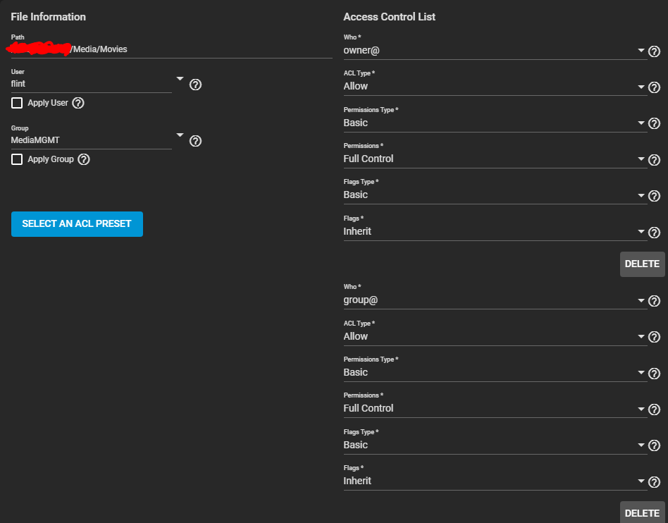

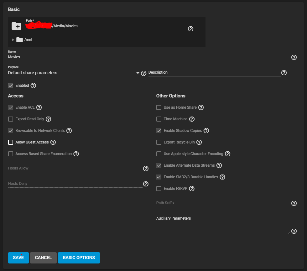

That's when I adjust my ACL. (More on this below as I assume that's where something is wrong and I spent the most time there). I then create my network share under Windows Shares (SMB). Make sure the path goes to Movies. {I have changed purpose a few times to NFSv3/SMB) but mostly I just do Default. It's marked as Enabled.
At first I was doing custom. More recent attempts I have switched to a preset. I normally use restricted changing the group@ to "Full Control". I have tried just about everything here. Owner: root. Group: wheel. Owner: jflint. Group: MediaMGMT. and every option in between. I have added full control ACL item for the Group "MediaMGMT" when the group owner was "wheel". I have tried adding User ACL item for jsilver. I have played with advanced flags. (99% of the time they're just basic and "inherit". I have played with advanced permissions over and over again. Deleting the dataset. Creating a new. Deleting users and groups creating new. Renaming them 100 times incase some naming messed something up. Nothing will allow me to access "Movies" from jsilver.

I will attach some screenshots I have taken. Please take note that some of the names have changed, but flint is jflint and silver is jsilver. (I think the only difference here is flint.)
