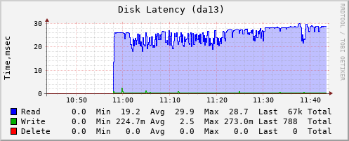

I am getting indications the drive is junk but no in your face error that says "I am junk - replace me"
The drive finishes a short and long smart test fine and are considered PASSED. FWIW I have the volume 83% full with random files from DD and no compression. I am doing and I have finished in the past scrubs with no errors, I am concerned about these drive(s) and do not understand why the FreeNAS creates an alert when smartctl says they pass. If I have to mark them bad that is fine. The drives are attached to a HP d2600 shelf via a LSI SAS2116e HBA and I have other drives on this shelf/system with no issues and other drives in the same ZPOOL without issues. This is a lab machine with lab drives doing nothing except a scrub at the moment.

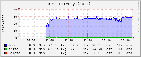

what I see in the legacy graphs is the disk in question has unpredictable latency and now the counters for "195 Hardware_ECC_Recovered" are skyrocketing, form 3988 to 28,029,079
Good dive next to it in the ZPOOL
Suspect drive:
Alert System :
CRITICAL: March 23, 2019, 1:07 a.m. - Device: /dev/da13 [SAT], ATA error count increased from 1 to 39

Chris Moore
May 2, 2015
10,080
See vendor-specific Attribute list for marginal Attributes.
This part right here where is says "PASSED" is totally meaningless. I have seen drives that were totally unusable that still claimed to be passing the self test. It is not worth looking at, ever, for any reason. Totally ignore that part of the report for all brands of drives.
199 UDMA_CRC_Error_Count 0x003e 200 200 000 Old_age Always - 57
This matters. It usually indicates bad cabling. Check the wire to the drive at both ends or just replace it outright.
5 Reallocated_Sector_Ct 0x0033 100 100 036 Pre-fail Always - 6
This matters even more. It means that there have actually benn bad sectors, six of them, that have been reallocated. For this, I would replace the drive.
