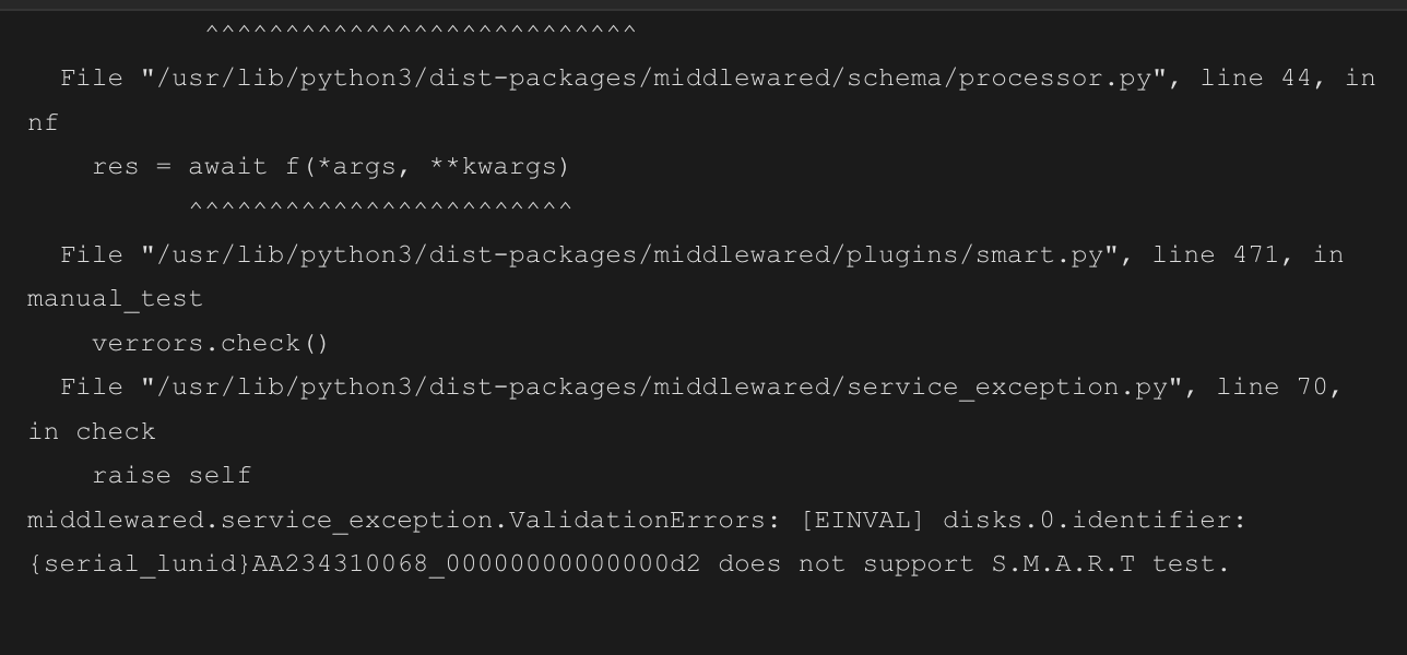

I've added an NVME SSD as cache vdev and setup smart testing but it doesn't kick off. Wenn I manually start a short test I get this:
AFAIK the SSD does support smart. Any idea why this doesn't work? It's a cheapo Fikwot FN950 I am testing to see what it does.

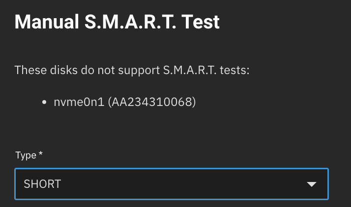

Found something. When I go to the disk menu and try to do a manual test there I get this:
The error I got initially when kicking of a manual test was from the periodic smart test menu so I guess the GUI doesn't handle it well from there. I'll do some digging why this NVME does smart test from a normal PC but not inside TN.
