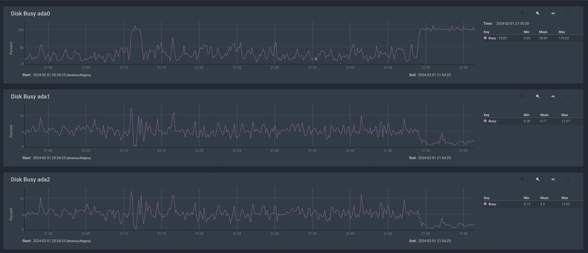

Also, here's an example of the metrics when doing a transfer. As you can see one of the disks is pinned at 100% busy, while the others are fine.

Are the drives SMR?
got hardware specs to share for everyone?
esalts
Feb 2, 2024
5
Are the drives SMR?
I ran this SMR check script and it turns out ada0 (the one with the issue) is SMR. The other two drives didn't come up, and I believe they are CMR. I suppose that is the likely culprit then, hey?

somethingweird
Jan 27, 2022
183
somethingweird
Jan 27, 2022
183
side note - Realtek NIC on motherboard *might* give you problems also.
esalts
Feb 2, 2024
5
Yup... SMR and ZFS aren't compatible.
Makes sense...definitely remember hearing that but I guess I didn't realize it would have this much of an impact on performance. I'll swap it with another CMR drive.
