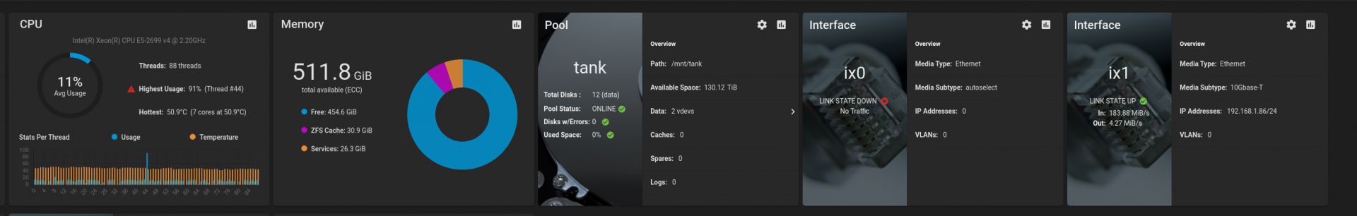

CPU and Memory utilization on the dashboard are minimal in terms of percentage.
While the transfer is going, CPU utilization ranges between 1% and 10%
Network transfer in: 305.77 MiB/s
Memory usage is -----------
Free: 474.0 GiB
ZFS Cache: 12.4 GiB
Services: 25.4 GiB

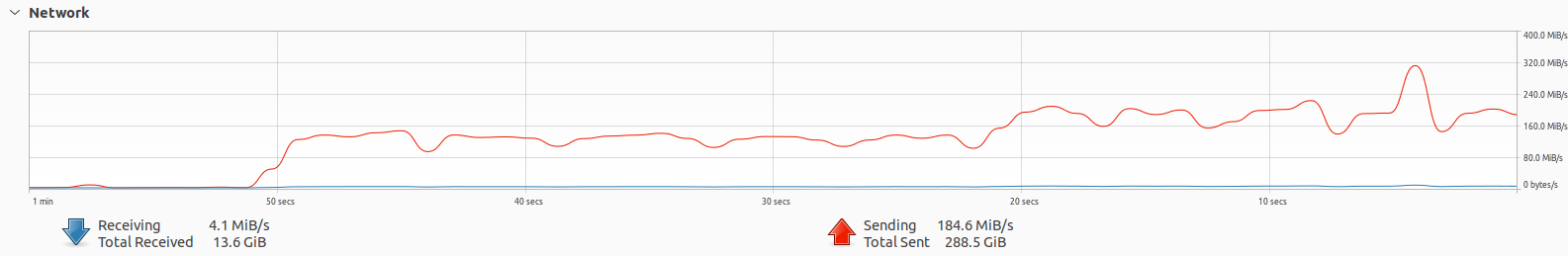

Trying a 200 GByte file now, here are the stats for that transfer
