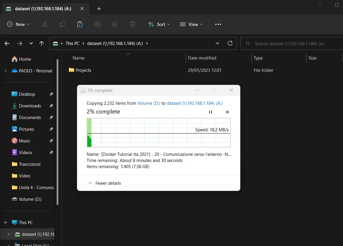

But when i Try to transfer from my Windows PC to this USB connected to the NAS it go at 20MB/s... really slow...

I leave below a screenshot while transfering a 8GB folder.

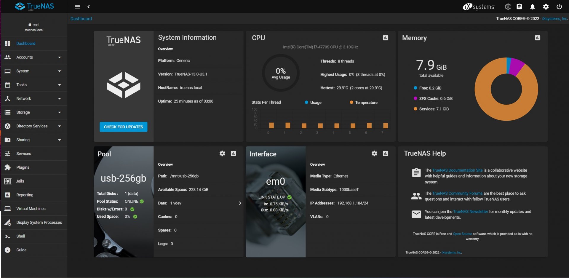

Does this 8 GB folder just contain one large file or a lot of files totalling 8 GB?
I also just noticed this. I think there is something not configured correctly on your system, cause the system is taking up like 90% of your RAM (unless you're running some kind of VM that you didn't mention).
Run htop on the console and see what is taking up all that RAM.

I think the system i this screenshot is taking only 100mb of ram, in fact the previous screenshot tells 7,9GB of ram avaiable, not occupied...

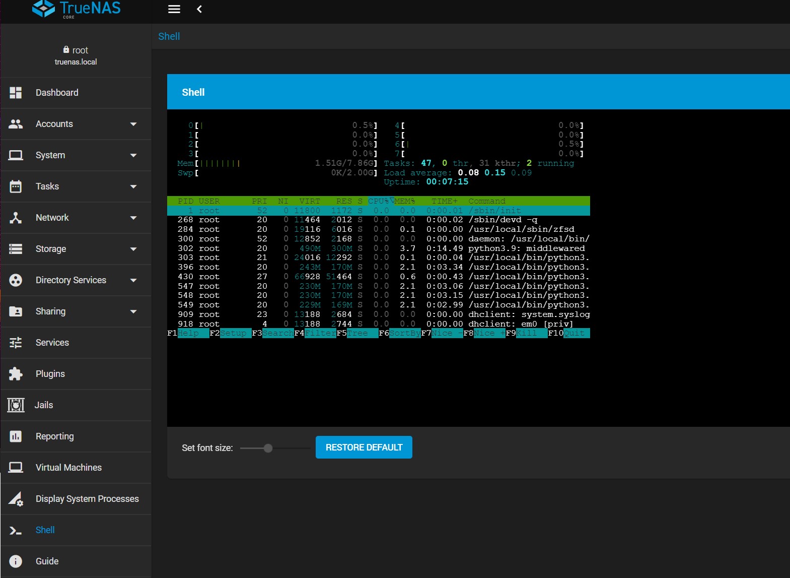

Below the htop comand result
I forgot the screenshot, sorry.
You are misunderstanding that. Admittedly, that wording is misleading. iXsystems probably should change that from "total available" to "total installed". That total is just specifying how much RAM you currently have installed, not how much is FREE. The first screenshot shows that 7.1 GB is currently taken up by "services", which is concerning. Your second htop screenshot looks fine though.

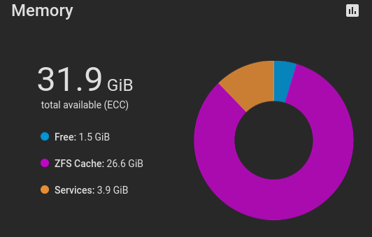

For reference, here's how mine looks like. You can see that services only take about 4 GiB and the rest is just ZFS cache.
