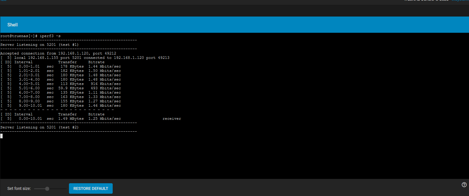

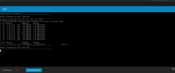

Sorry, kB/s. I'm not too familiar with running iperf, so I hope this is helpful. iperf -s returned:
TCP window size: 64 KByte (default)
Yeah, that's not a successful run, you need to run the server on one end and a client on the other end so that it can actually test anything.
twhornback
Mar 20, 2023
11

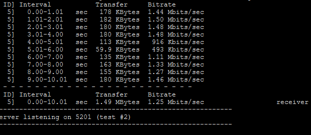

Apologies, here are results from a successful run:

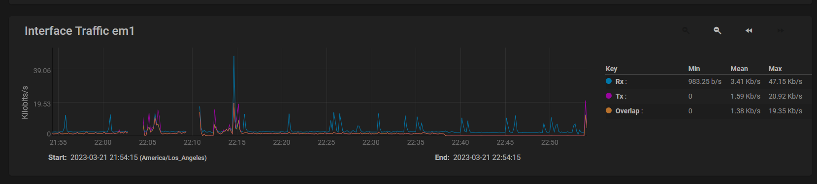

I just installed TrueNAS-13.0-U4, my In/Out speeds on em1 hover around 0.25 kB/s. Same with em0. I also tried switching ethernet ports on my router.
Any ideas? Here are some screenshots. Hardware/network details in signature.

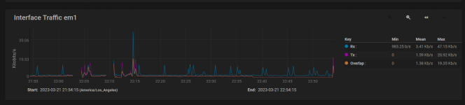

What's the other end of the Iperf test (what other device are you talking to at 192.168.1.120)? How is that device connected to your network? Is it connected wirelessly, plugged into another Ethernet jack on the same router, etc? Can you confirm the other computer is working normally If you have 2 known working devices which can access the internet etc at normal speed... can these other known-good devices talk to each other at full speed using the same ports on the same network equipment?
twhornback
Mar 20, 2023
11
Thanks for your reply. Attached is the other end of the Iperf (Windows 11 client), it's over WiFi.
Other known-good devices can talk to each other at full speed using the same ports on the same network equipment.

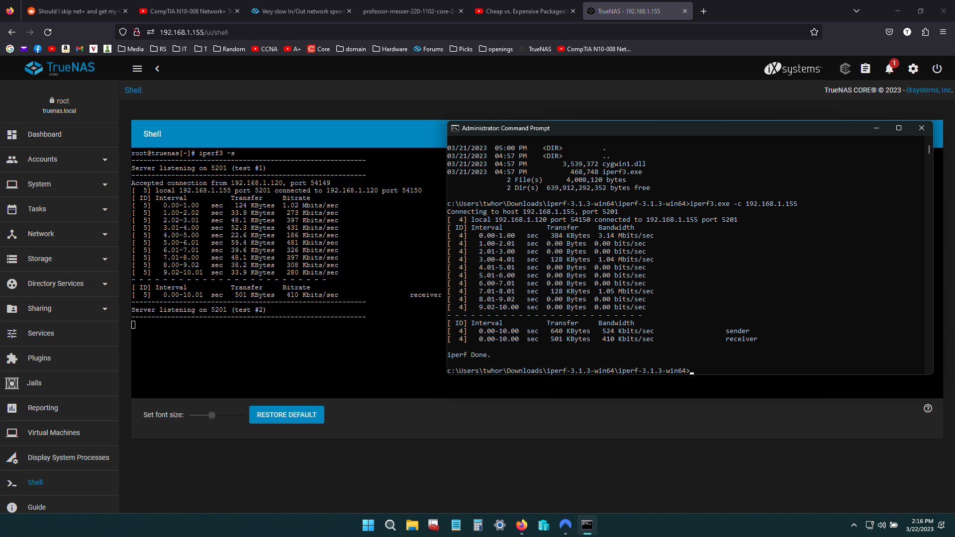

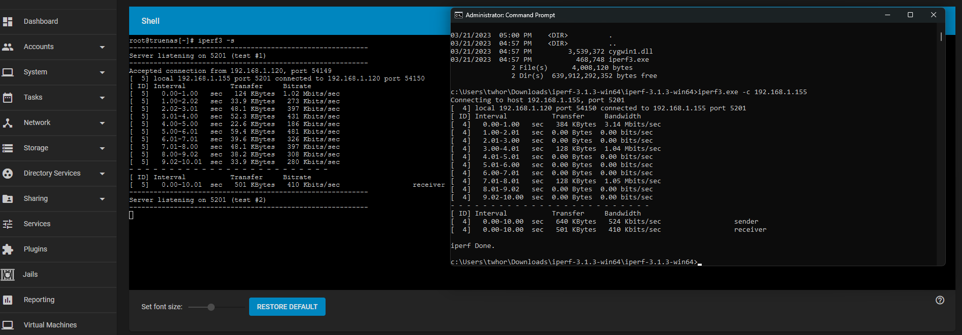

twhornback
Mar 20, 2023
11
Test results from both sides.
Yeah, your network is not in great shape, as evidenced by the bitrates that rival 2008 cell service. We can try to offer some advice, but you'll need to tell us more about what's going on with your network.
