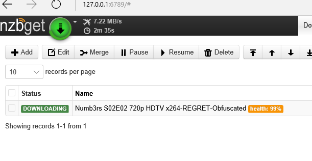

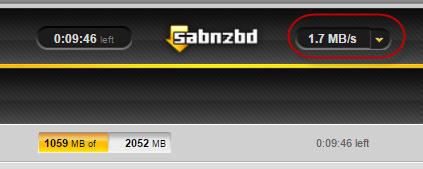

I get no more than 1.7MB/s downloading using the Jail Plugin for Sabnzbd. The Jail is running on a 6GB/s MSATA 128GB SSD drive.
Even if the max speed is set to 99999999 Kb/s, it will never go over 1.7MB/s. Before using a Linux server with an I5 on the same network/same location I could get the max from my connection 8.9MB/s.

I thought this might help, so I tried it, but nothing changes.
http://wiki.sabnzbd.org/highspeed-downloading
[SABnzbd:1306] CPU Pystone available performance is 64000
2016-01-25 18:06:32,609::INFO::[SABnzbd:464] _yenc module... found!
Set cache as 120MB

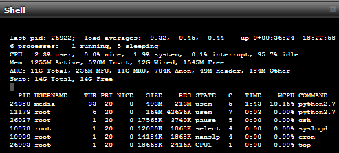

top does not seem to be doing much either.
