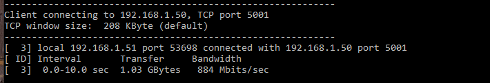

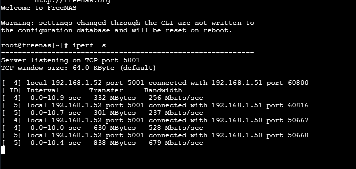

I've done the ipref test and this is the result.

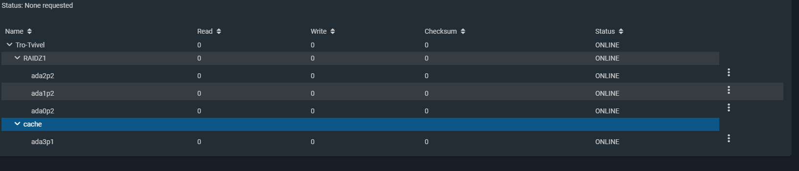

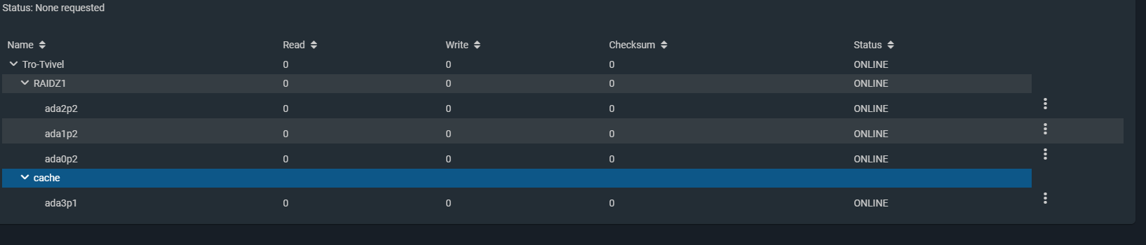

This is my pool configuration

The hard drives I use are WD red WD10EFRX.
I've done the ipref test and this is the result. View attachment 38424

This is my pool configuration View attachment 38426
Remove the cache it's not helping you in any way.

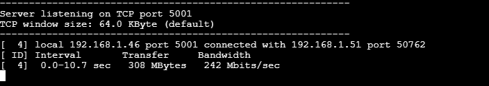

Tried running iperf between my mac and an intel nuc , this result is when both are connected with cable

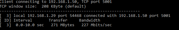

And this is when one is connected with cable and one on wifi
Is this a normal result?

That's about expected for an Intel Gigabit Ethernet adapter. Wireless throughput is always pretty bad, but 227 Mbps is pretty close to the maximum for an 802.11n connection (300 Mbps).

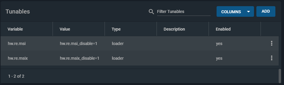

I'm not sure if I did right

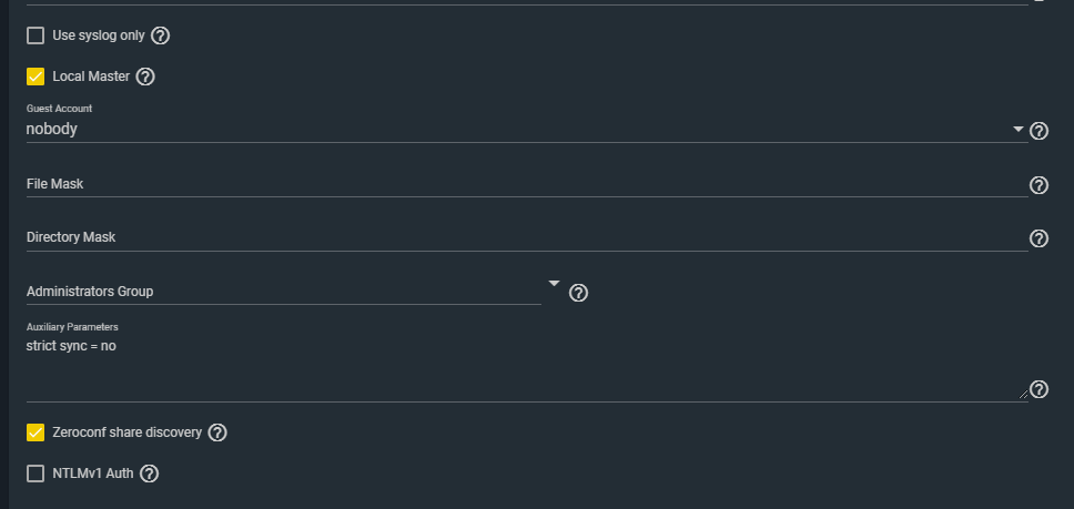

I have changed the SMB auxiliary settings ,strict sync = no.

Yes, you set the tunables in the correct place. However, both values should just be 1, instead of what you have, and the variables should be hw.re.msi_disable and hw.re.msix_disable. They won't take effect until after a reboot. You'll have to experiment with each one, to see whether 0 or 1 gets you the best performance.

Also, after changing the SMB parameters, you'll need to restart the SMB service to make the new parameters take effect.

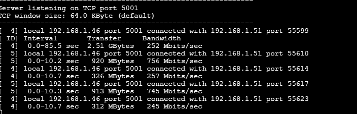

I have borrowed this card from a friend Intel 82574L Gigabit Ethernet Controller which I understand is compatible with this list
FreeBSD Hardware Compatibility Guide. i still have poor speed between windows pc and freenas when i run the same test from my mac i get almost double speed, still not full speed.

The low iperf scores are pointing to network issues; there's no reason that a direct link should be that slow.
Start with Layer 1 - Replace your network cable if possible. Is the path to your FreeNAS machine going through a "home hub" or other ISP-provided "router" that might be hitting a limit on its ports?
Also, what is the network card in your Windows PC?
