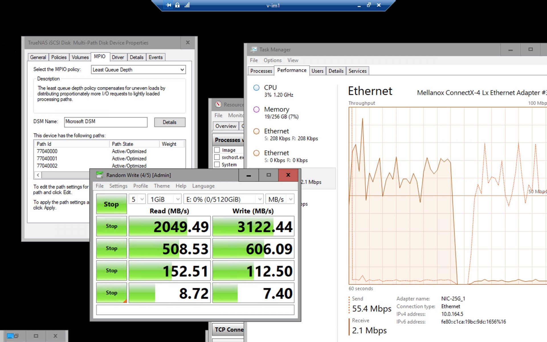

I'm working on implementing an all NVMe san using dell a Dell R750 and 6 NVMe drives in a 2-to-a vdev config, each drive pair sharing a processor. I chose a thin provisioned pool and have attached the target to a MPIO initiator using two separate connectx-4 25gbe nics, one directly connected to the R750, the other through a FS switch.
My thin provisioned pool was setup this evening--I've seen some file systems that require a "build" time, even with mirroring, perhaps this is what's going on??
My sequential 1M read/write speeds seem to be better than expected-- 2050MB/s read, 3100MB/s write, but I cannot seem to get the random single thread 4K read/writes past 8MB/s on both ends!
Is this a reflection on the limits of iscsi connections?? If so, my dreams of a SAN with three failover cluster hosts attached will have to go out the window. Please help!

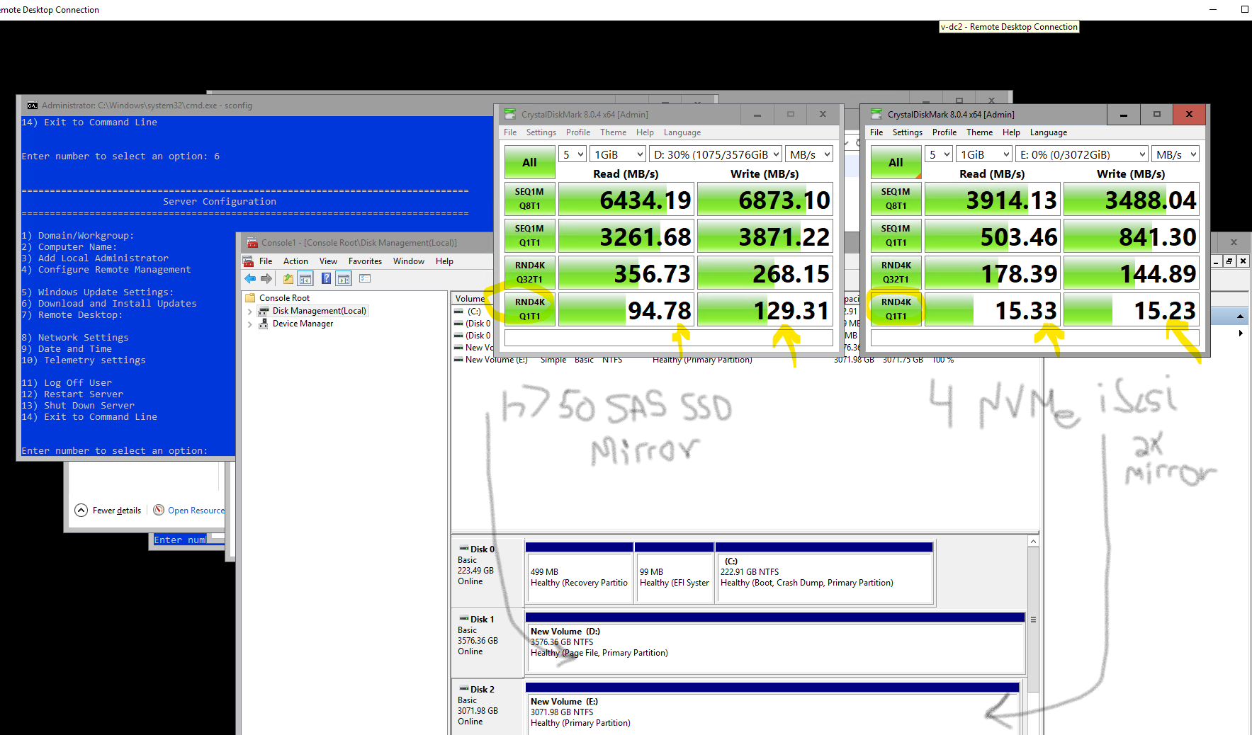

Sorry for the vague question--I'm trying to increase single-thread throughput, specifically, 4000bit sized files from adjacent iscsi connected hyper-v hosts. Random IO will be the majority of queries in my 3 hyper-v host environment. We have two win file server vms, two win database vms and two win terminal vms, along with misc utility linux vms where latency isn't as important. Sequential throughput has been pretty amazing, but I'm concerned that users are going to complain about a sluggish response when making sql queries or opening small files.
My particular test is using a truenas scale bare metal install on a Dell R750 using 2 pairs of 7.6TB Samsung NVMe drives for the main data pool, along with a pair of 900GB Dell NVMe metadata drives (because the host I bought came with the two drives, along with the sata BOSS drives that run the OS)
The R750 is then connected via two pair of connectx-4 25gbe cards directly connected (bypassing a switch) to a Dell R740xd w/ a connectx-4 25gbe adapter and two Dell R630 with connectx-4 adapters. Each hyper-v host is put on its own subnet for its main iscsi connection (eventhough I've experimented w/ bridging these to one subnet, and it seems to work!)
MPIO is then achieved using a connectx-4 100gbe adapter on the truenas bare metal host going into a FS S5860, with the hyper-v hosts connected to an additional, off prod, subnet. I've connected each hyper-v to the iscsi target twice, using a least queue depth MPIO strategy.
I use perc H750 and H730 adapters on the hyper-v hosts with 3.8tb Dell SAS SSDs in a mirror array for local data storage--this achieves strong random read and writes in the 4000bit range during testing, perhaps due to caching, but it's so much faster than what I can get out of my NVMe iscsi array at the moment!
I'm $15k into this build, with two hosts purchased, numerous network cards, a new switch, and 2 months of testing. It looks like I'll have to keep my VMs tied to physical hosts instead of creating the cluster I was hoping for. Local storage appears to remain the strongest performer here, especially where sql is concerned!
For the file servers, I'm going with my R750 truenas, but sql will most likely remain on the SAS raid controller.
Thanks y'all for your input, I do appreciate it!
Ryan

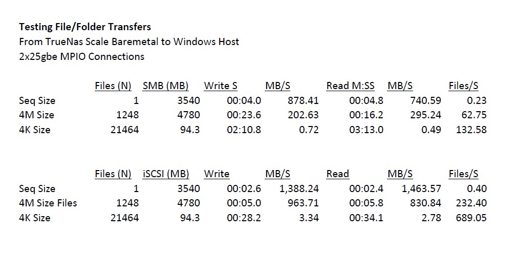

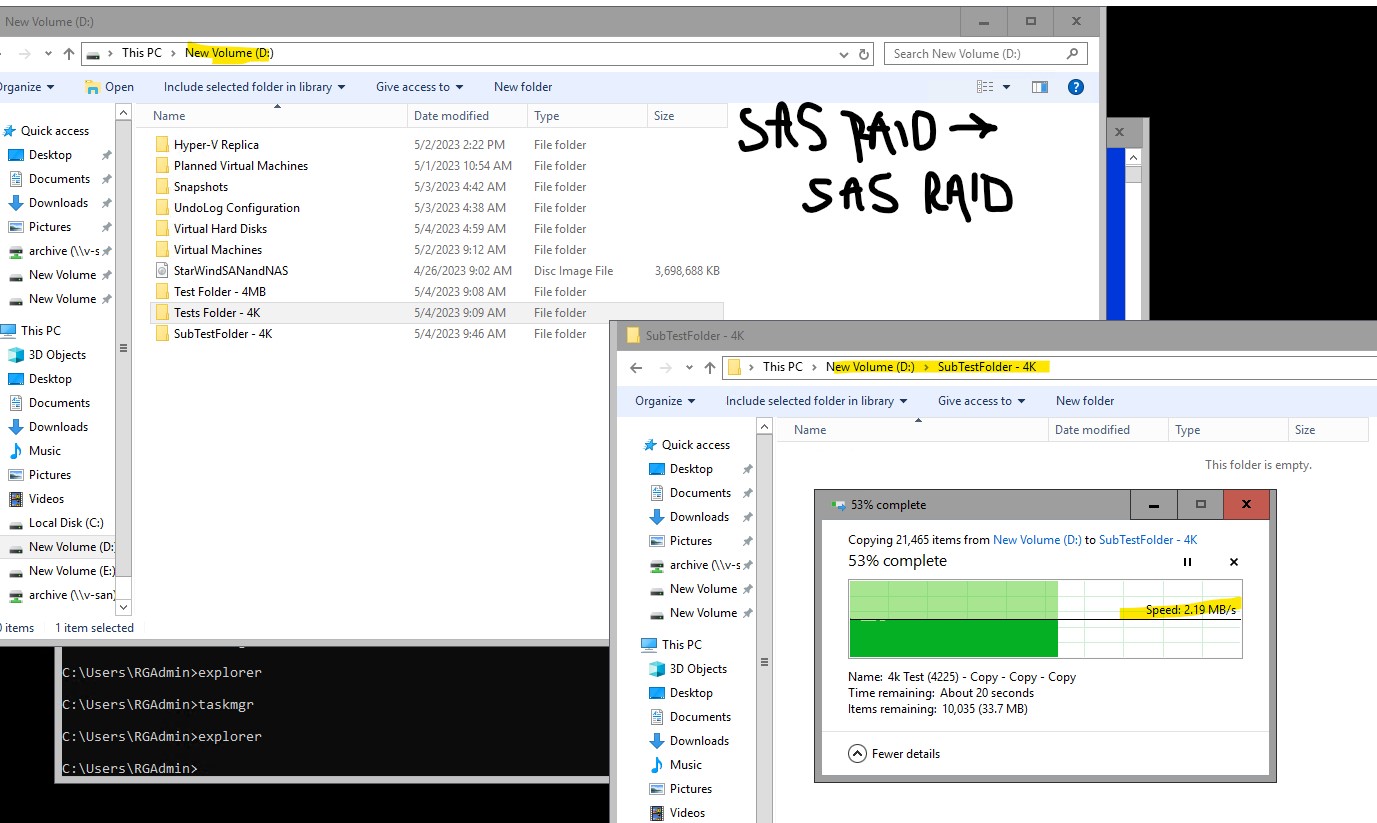

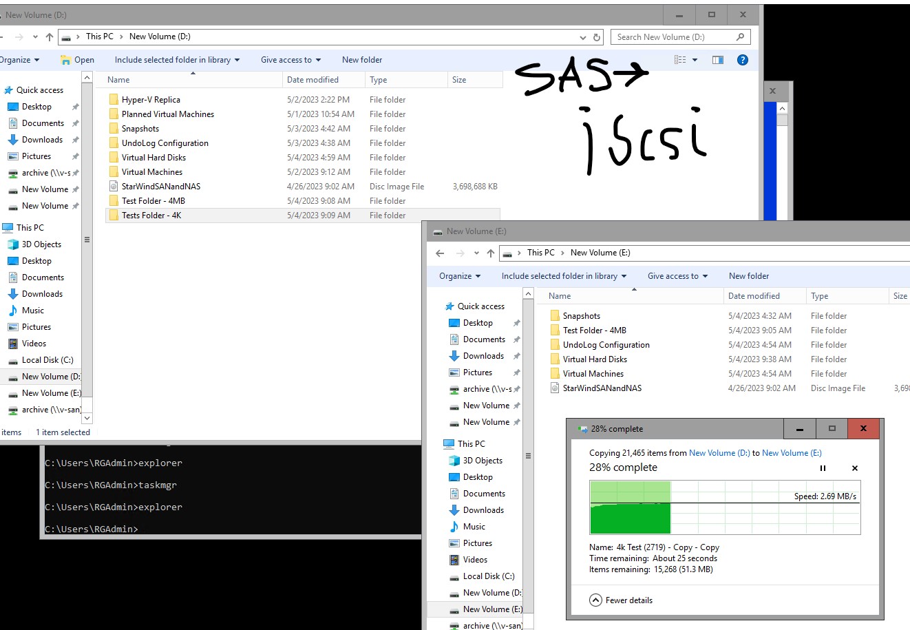

I created a real-world test of my truenas setup using actual 4MB and 4KB sized text files. I then copied these files to and from a local mirrored sas raid array--the results were very encouraging!
I found that copying the 4KB sized files inside the exact same array actually yielded SLOWER results than copying the files from the SAS array to the Truenas iscsi target. I've compiled the results, at this point--I'm encouraged to say that crystaldiskmark may be misrepresenting real world file access and transfer capabilities, at least where my servers are concerned.
I've also benchmarked windows filesharing speed capabilities compared to iscsi--I'll use these same tests to verify that our file servers are equal or better once we fully implement the new cluster/san topology.
Ryan

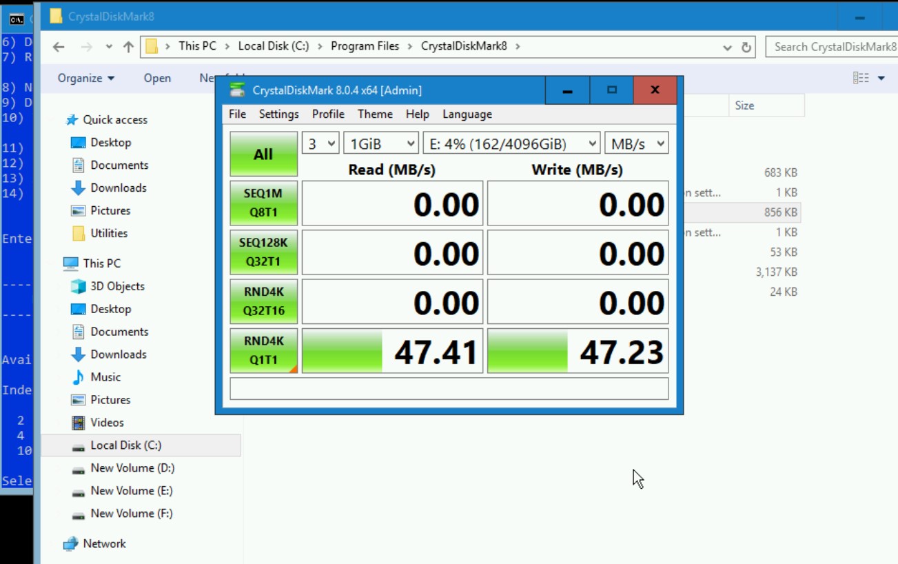

I had to rebuild my truenas scale setup due to some DNS issues after leaving the domain. After re-creating the iscsi targets, I noticed that my once fast iscsi single thread benchmarks ground to a 3.8MB/s halt.
In messing around with jumbo packets, I apparently added a ton of latency to my system. I moved the MTU from 9000 back to 1500 and brought my IOs back up and now Read and Write at 47MB/s!
