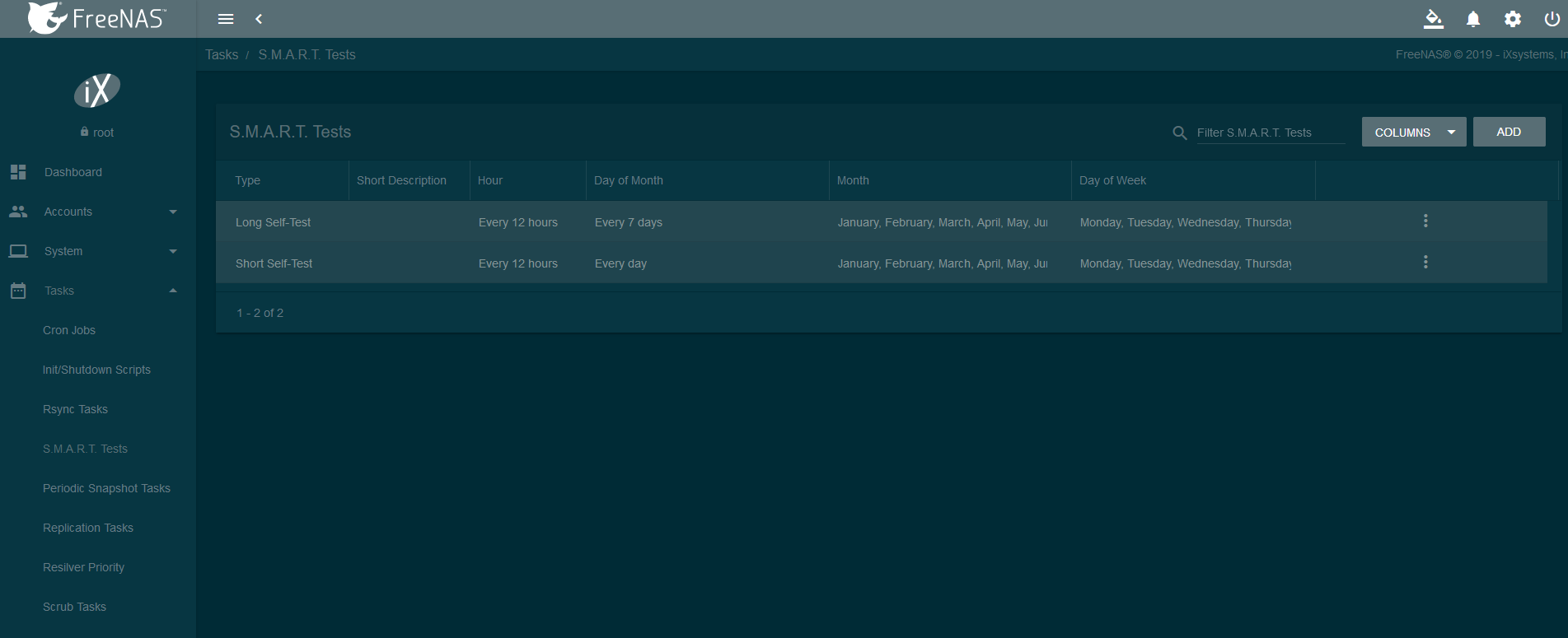

I run smart tests on all of the drives - Long Self-Test every 7 Days and a Short every 12 HRS.

Since I have the drives listed there should I really be concerned at this time with any of the others ?
Having a look at FreeNAS It looks like I have them Setup for every 7 days?

Does the Log test look to be setup correctly ?
I was told in a previous post months ago that I should do Long 7 day and Short 12 hrs. So what should I change Short to? Every 24 ?
Also can you please let me know what you are looking at to say that I should keep an eye on DA7 for ?

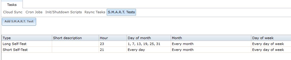

Change the Hours to Every 24, or if you can select a specific time that would be fine to, that is for both Short and Long tests. It looks like you are running the short tests twice a day. While that isn't a problem really, but it rolls the SelfTest Log over so we cannot see that a Long Test was completed to pass. I'll bet the DA4 drive doesn't pass right now.
As for DA7 and DA6, I suspect that these are connected to a different I/O card from the other drives (let me know if I'm correct), and the error messages you should keep an eye on but because there are nor other related errors, I don't think the drives are failing yet.
Anonymous71458
Jan 27, 2017
162
Okay so I have switched the Short to every 21 HR every day. The Long tests are now Set to every 23 HR every 6 days. ( So confusing )
Does this look better??

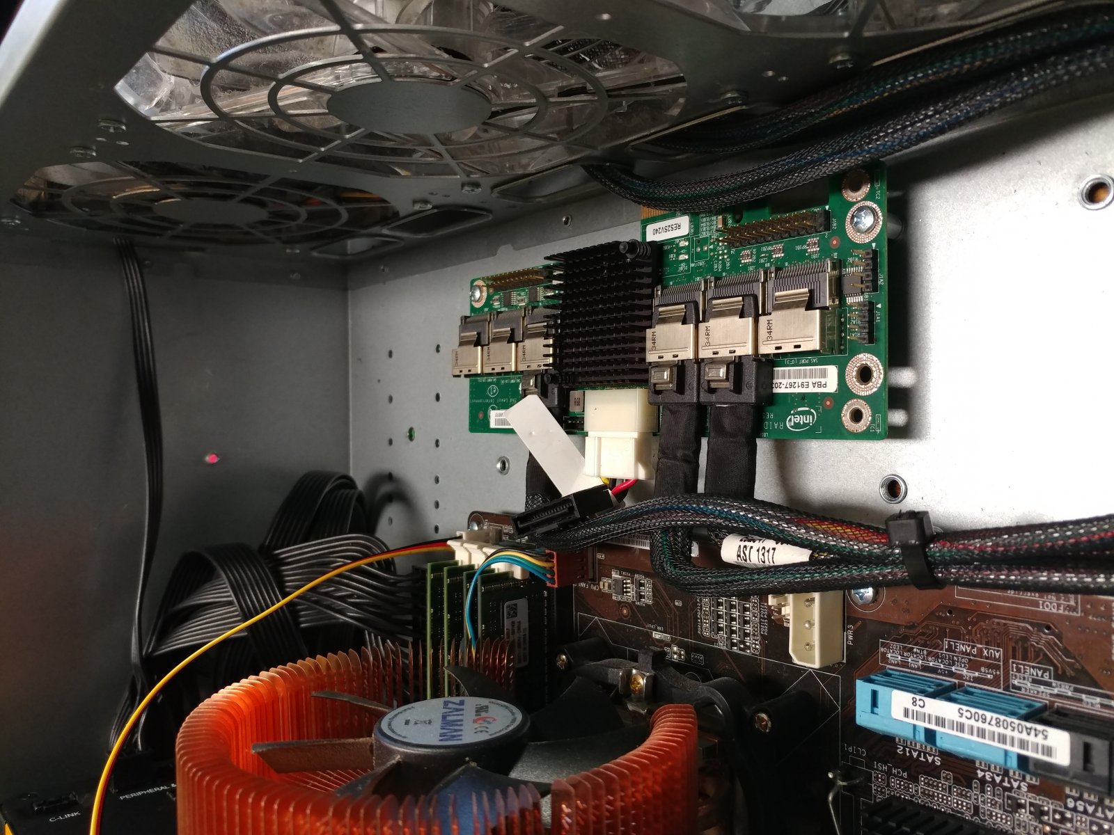

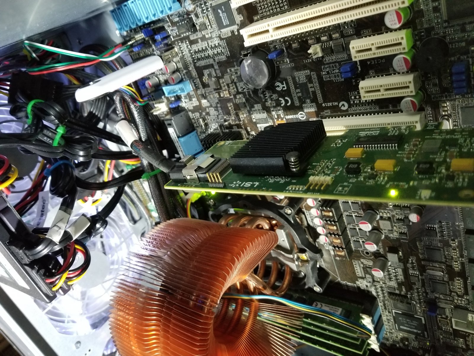

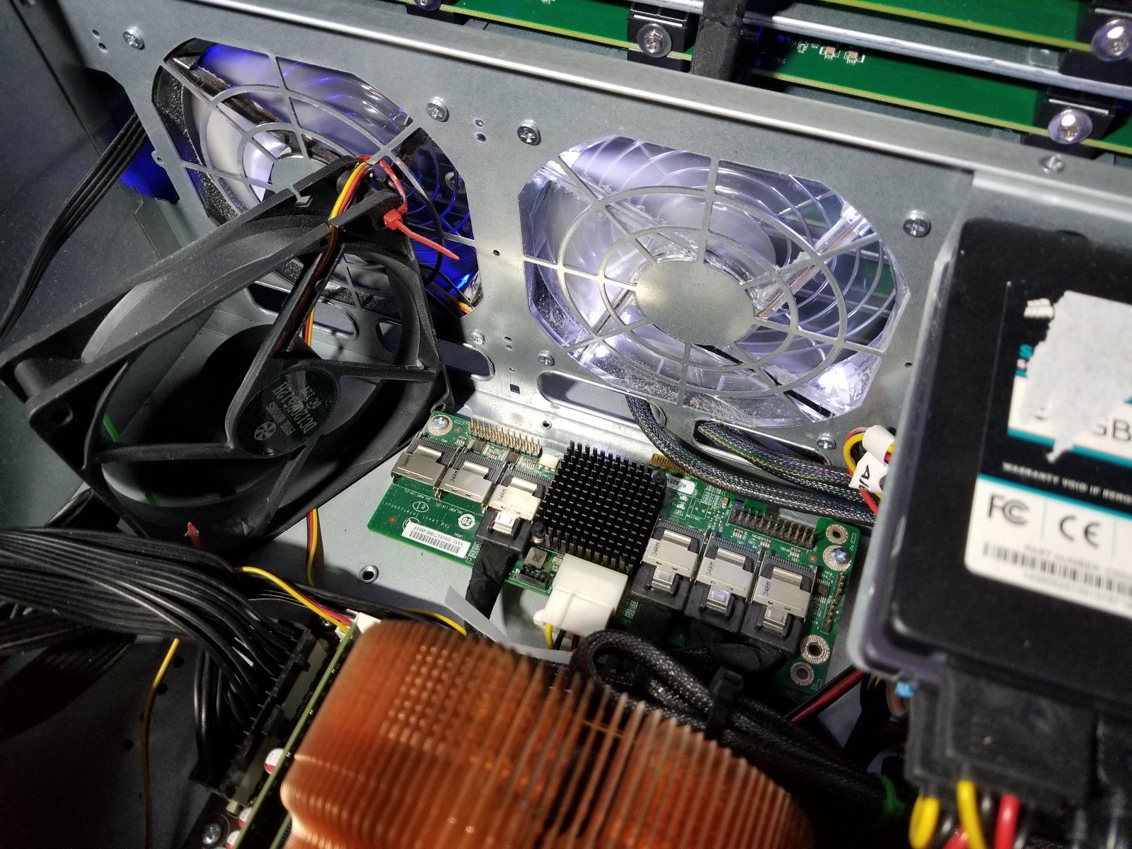

I have a 9211-4i that is connected to a RES2SV240 all of the drives connect to that 24 port expander. So all of the drives are on the same controller card being the 9211-4i.
Ignore the mess of cables in the case- I have not updated these pictures in forever. Most of the cable runs have been fixed to be cleaner.
