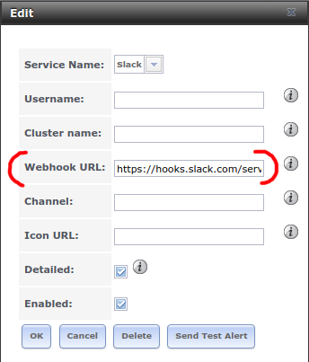

alx.balmus
Jan 27, 2018
All you need to set up in the Slack Alert configuration window in FreeNAS is the Webhook URL.
The Webhook URL behaviour and configuration can be done ont he Slack website. You can configure there the username, channel, and icon.

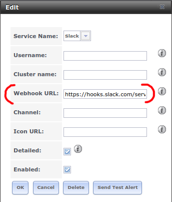

Prasanth
Mar 2, 2014
100
Thanks that was helpful..Looks to be working for me now.
