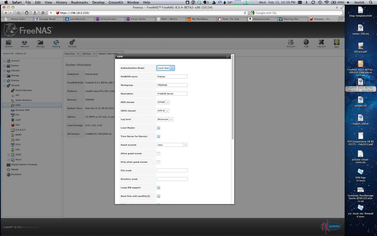

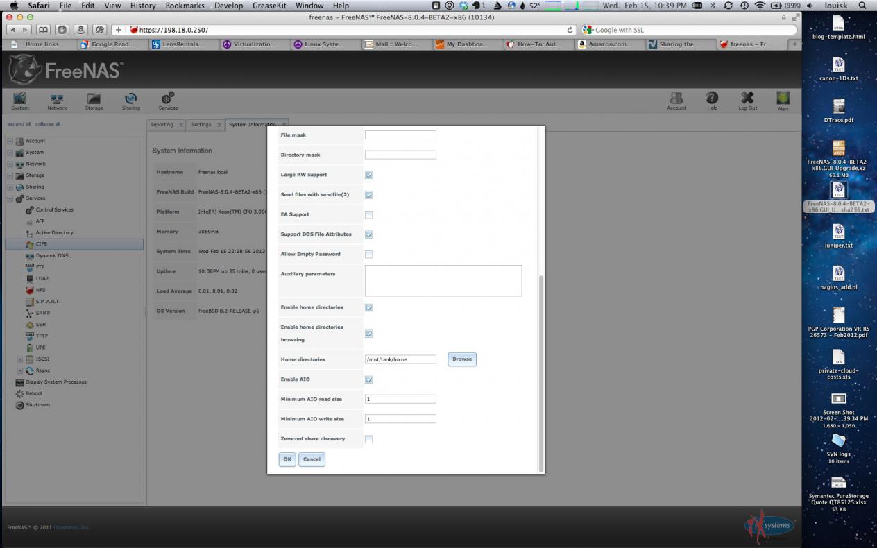

I've attached the CIFS prefs, but I don't think there is anything special going on there.

Thank you for the screenshots!
Hmmm, the only difference between my and your configuration is that I'm using the "Anonymous"-Authentication model and that I haven't enabled the "Large RW support".
Of course the "Anonymous"-Authentication model also means that my guest account is set to "guest" and that "Allow guest access", "Only allow guest access" and "Allow Empty Password" are all enabled.
Everything else is the same.
As far as I know the "Large RW support" has only to do with the performance of the NAS but not with my problem (?). So it seems that the "Anonymous" authentication model with "guest"-access are the troulemakers. Have you ever tried to access a CIFS share via Mac OS X when it was set to "Anonymous" access?
