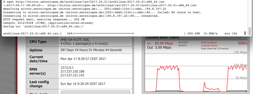

These are my latest results (traffic graph from my pfSense firewall, note the scale). The leftmost and rightmost peaks reflect the downloads with about 100 Mb/s download speed while the one in the middle reflects the download from a VM:
index.php
I did test this repeatedly before posting yesterday so there definitely was a problem. Now I can not even guess the reasons. I will observe this in the next time and if it reoccurs I will post again.
