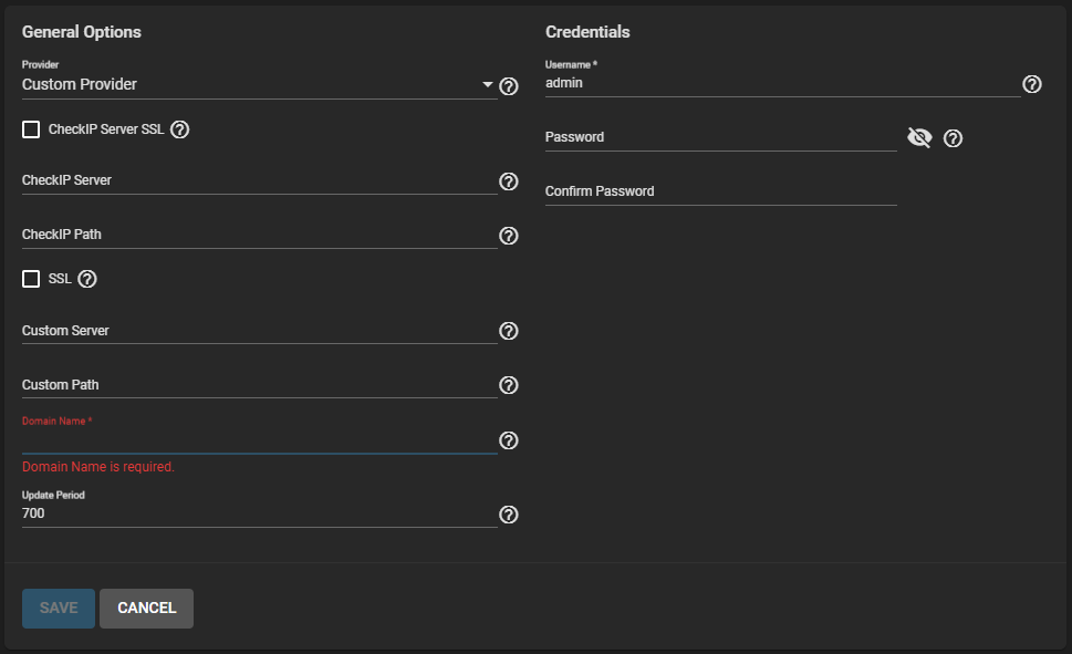

Please help setup access.
I have Mikrotik router and was able to setup DDNS on it. Mikrotik provides their own built-in DDNS service and after a quick setup I got my URL and able to login to router from outside. Link looks like:
TrueNAS does not have preset for Mikrotik DDNS and I have to use Custom Provider option. Not sure what exactly should I type in there. Can you please help me with setting this up. Thank you.
P.S. I didn't forward any ports yet and not sure if I need to.
If it's Mikrotik's DDNS service, and your Mikrotik router is using that service, you shouldn't need to do anything with it at all in TrueNAS--but I'm similarly wondering what your objective is. If it's "log into the TrueNAS web GUI from the Internet," than:

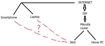

Sorry for asking "obvious" questions, but it's not obvious for me, since I'm quite new to all that. I have basic level of understanding networking, so not everything is obvious for me. But I'm trying to learn.
So the purpose is to have access to my files on NAS from my other devices over internet, not the local network. I do not have any problems accessing files on NAS from local network - it's working perfect, fast and I can access from Windows PC or Android phone with no issues. My next step is access to NAS over internet. Off course I'd like to make it secure so no one else can have access to it. I thought I can do it through Mikrotik DNS service, that is built in to my router and it is absolutely free instead of using services like noip.com or others similar. I do not have static IP at the place, where NAS is located.
As I can see, some of you guys recommend using VPN (instead of using DDNS??). If so, as I understand, there should be device on my local network running as a VPN server (let's say it's my NAS), and other devices can connect to it from internet. But I do not have static IP, and it is outside of my understanding, how other devices can reach my VPN server if VPN server has no static IP address?
Thank you all for your help.

15,504
Not instead of, in addition to. DDNS gives you a fixed address (the domain name), even if (when) your IP address changes. A VPN provides a secure means to access your LAN when away from home. They address completely different questions.
I think the suggestion is that you run the VPN server on your router, which appears to support operating in that way given the documentation link Samuel posted. Remote devices reach that VPN server using your DDNS domain name.
