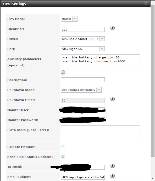

I just grabed myself a new APC UPS (1500RMI) and I successfully connected it to a server running new newest freenas version using USB (will try to grab a network management card in future). I can use upsc to get the current status of the UPS.
I just played with the configs and I set the overwrite function to set the battery.charge.low and battery.runtime.low values to 80 and 9000 (just for testing the shutdown on low battery without draining the whole battery). Afterwards I let the server run on battery and the bat droped below the 80% but the server did not shutdown.
Does one of you have any ideas what is wrong with my setup?

How did you configure the UPS service?

Wow, that was a quick response @Bidule0hm! Take a look at the attached screenshot for my configuration:

Should be ok.
Maybe the override doesn't work.

Hmm i thougth the same, but at least upsc does report back the correct (overwritten) value for the battery.charge.low value. Is there another way of settings the value? The current server is only drawing arround 40W, so I did not had the patience to wait for it to reach 10% battery charge. Otherwise I would prefere changing the value anyway to give me a bit more headroom for shutdown with my "production" server.
Is there anything I can try?

I am talking from memory here, so this may be rubbish. However, my recollection from the NUT homepage is that the 'override' parameters only change what the driver reports, not the settings on the UPS. (There must presumably be a use for this!) In which case you would have to use apcupsd on a linux or 'BSD box to set them, or APC proprietary software (used to be Powerchute Plus?) probably on a Windows box. Fortunately I think they are persistent. Though possibly not if you reset the UPS or change the battery.
However, FWIW, you can set 'ondelay' and 'offdelay' if you want to, through the dialogue box you used above and this does work at leas on my old SmartUPS.

Thanks @rogerh! I just did some more research on the overwriting and found out that I have to set the "ignorelb" flag as well. When this flag is set the driver ignores the "lowbat" status of the UPS and just uses the battery.charge and battery.charg.low values to determine when it should shutdown! After settings this flag the shutdown worked without any trouble!
My config now looks like:
ignorelb
override.battery.charge.low = 20
