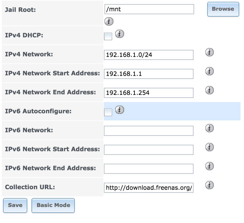

So in the first step, the configuration window has changed a bit. Where would I want to put the Jail Root? Under /mnt/one of the volumes (mnt is the main freeNAS server/directory, and inside of that I have the difference volumes/arrays/shares I've created)?
I attached an image of what the config menu looks like for me.
Edit: Oh, wait, I think I've got something.

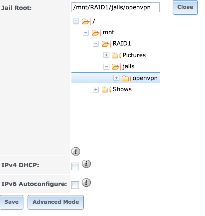

15,504
The jails should be in a dataset on your pool. Some folks set up a separate pool for their jails on an SSD (or a mirrored pair of SSDs), otherwise it would be on your main pool. The path would be something like /mnt/tank/jails/. The manual makes it sound like you'd need to create that dataset first.

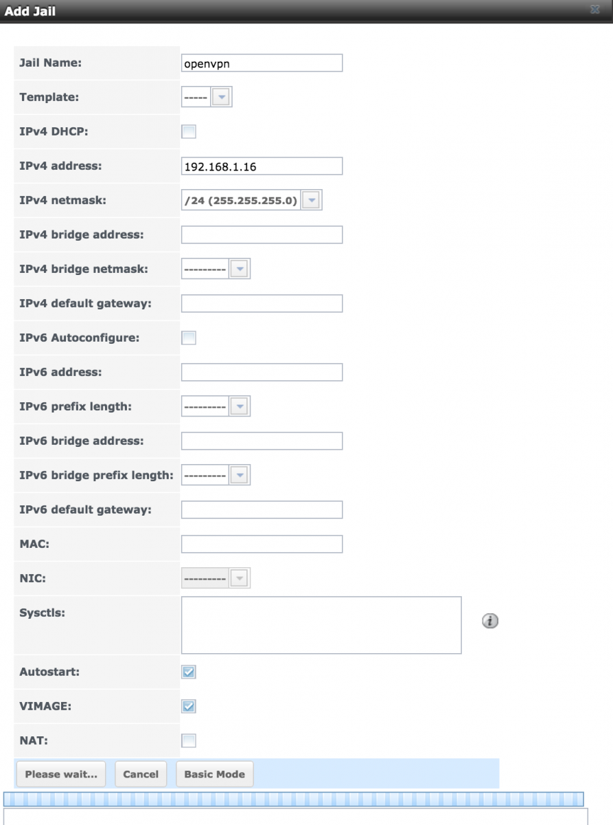

So like this? (see two screenshots)
And then, do I need to add any storage to the jail? or?

15,504
No, jail root is where all the jails live, and each jail has a directory under that. In your case, the jail root would be /mnt/RAID1/jails, and when you create the openvpn jail, that directory will be created for you.
As to whether to add storage, it's not something that's required for the jail to work, but I believe the guide I linked to tells you to do so. Check back with it to be sure, though. Again, I have no experience with that guide, so I can't help much with that procedure.

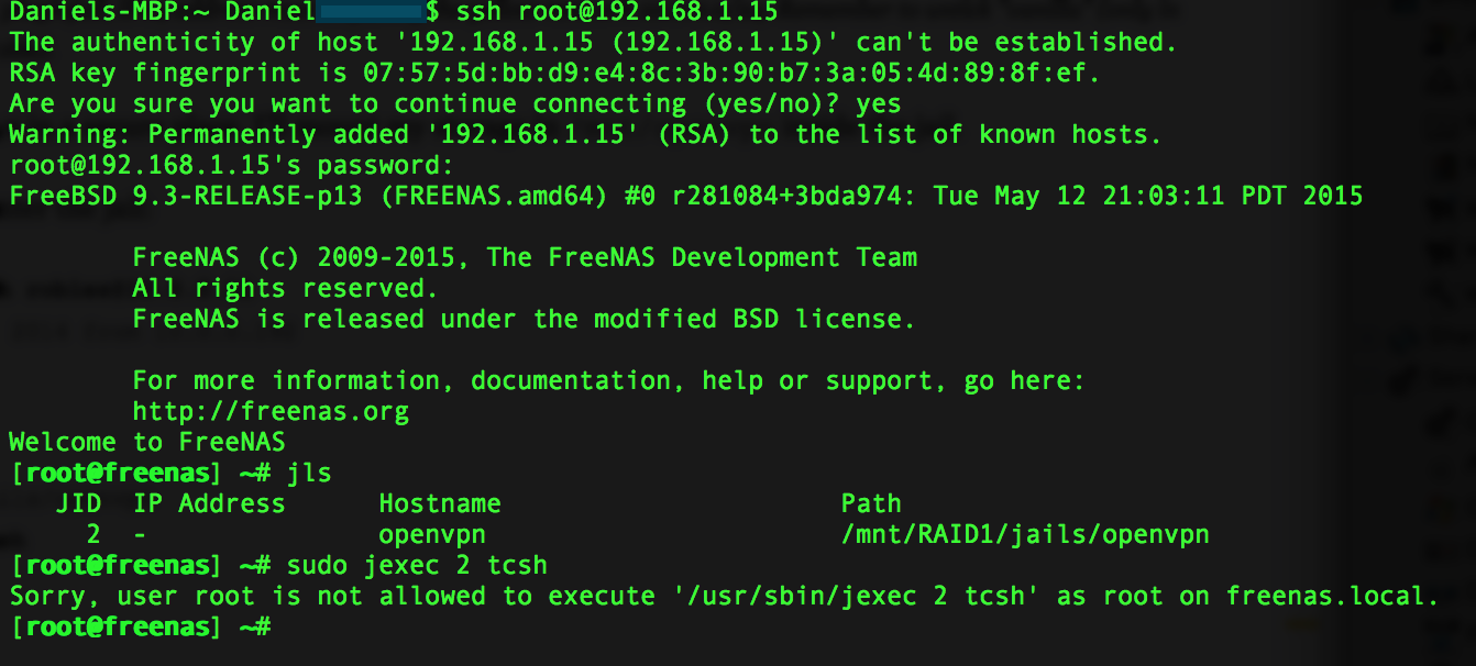

Gothcha
When I try to SSH in I get an error: "Sorry, user root is not allowed to execute '/usr/sbin/jexec 2 tcsh' as root on freenas.local."
Who should I be trying to connect as if not root?

pirateghost
Unintelligible Geek
Feb 29, 2012
4,219
Gothcha
You're already root. You don't sudo
