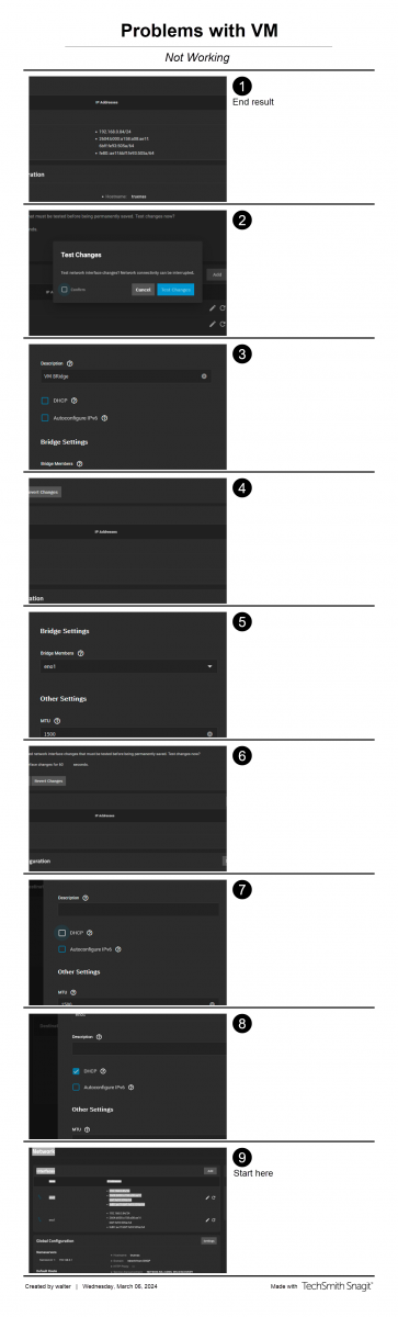

camsrv
Apr 12, 2023
This post helped me figure out part of my issues; but if anyone sees this and still has issues / I found using the console made it finally work for me.

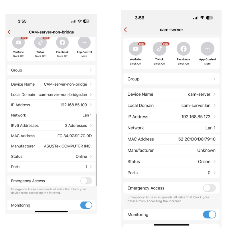

Also keep in mind that the bridge will have a new Mac Address, so if you have static ip configs on your firewall based on Mac addresses that was also breaking my setup until i enabled DHCP.
More info here
End result:
(Pictured above is after I enabled the Bridge, my network had two duplicate 'cam-server.lan' connections which I had to rename; and my ip reservation is also what broke it before since the Mac requesting that IP did not match up the old Mac Address until I gave in and enabled DHCP)
For the console method,
Select (1) Network Interfaces
Move the Settings (DHCP / Reserved IPs to the New Bridge)
Since my network uses DHCP I turned ipv4_dhcp to ON on the old interface and made sure the IP Aliases were empty.
(If you DON’T USE DHCP, keep track of your IP Aliases since you will need to copy them over to the bridge)
Then on my bridge network ‘br0’ I set ipv4_dhcp to ON; and if you don’t use DHCP copy your IP Aliases here from your old network interface.
Be sure to add your old network interface as Bridge Member!
Then quit and save, and if needed reboot!
