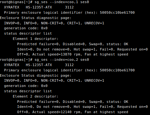

What can be done, can also be undone... let's figure this one out.

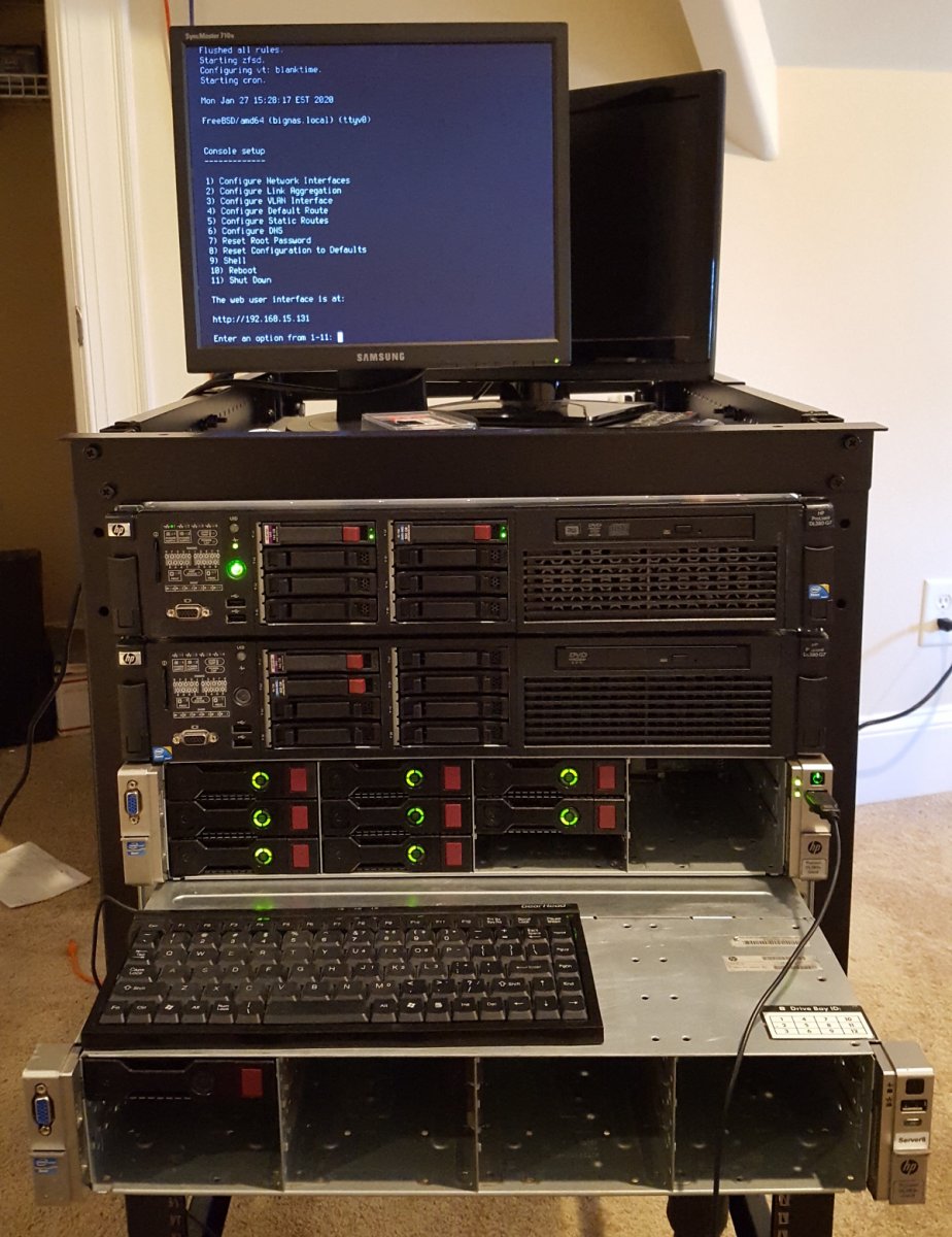

No... I sold it, too frustrating. Very well built box, but lacking fan control drove me to sell. I bought a DL380e G8 which is only 60dBa... tollerable even in close proximity.
