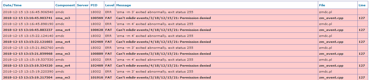

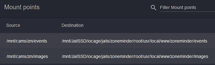

Thanks, I followed your instructions, but it looks like it has some ownership conflicts. new events are not getting recorded.
I can see the mount points were created for ZM, and they point to a new dataset on a diffrent pool. The owner is root, and group is wheel. I changed the ownership as per you indications with
chown -R root:wheel *
but no luck.
this is from ZM log

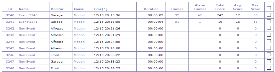

Also, I noticed new events are not being numbered as before:
Any ideas?
mvcad
Feb 25, 2018
116

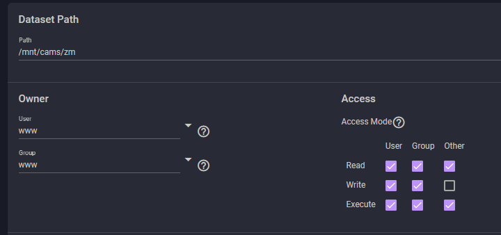

I figured it out, I set the user and group owner to www, and all is working fine. thanks for your help!

Could you advise where did you set this, please?
I did it through the GUI just by changing the permissions on the dataset where you are saving ZM data.

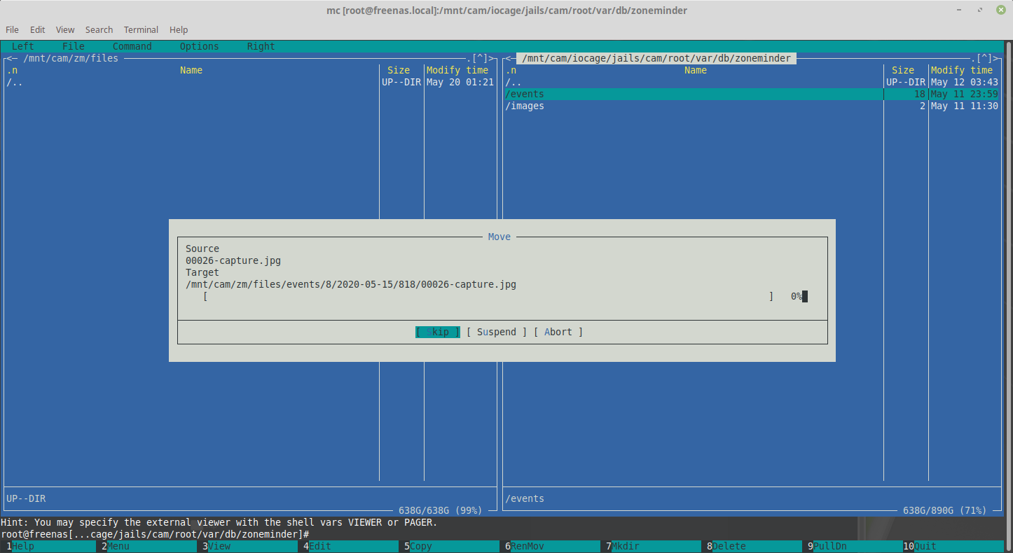

SOLVED - The elusive files were not located where ya'll were saying. They are here... I used my old friend Midnight Commander and found them. Since I had not noticed right away that ZM was using the wrong storage... I'm moving them with MC to the big storage drive zm/files/... that way I won't have lost everything when I start up again. The next magical trick is to create two mount points. Thought about using Zoneminder on both source and destination... thought perhaps the program would sent them to the right sub folder... but alas.. I just want to get this up and running.
Good Luck to ya'll from Newport North Carolina see the screen shot.

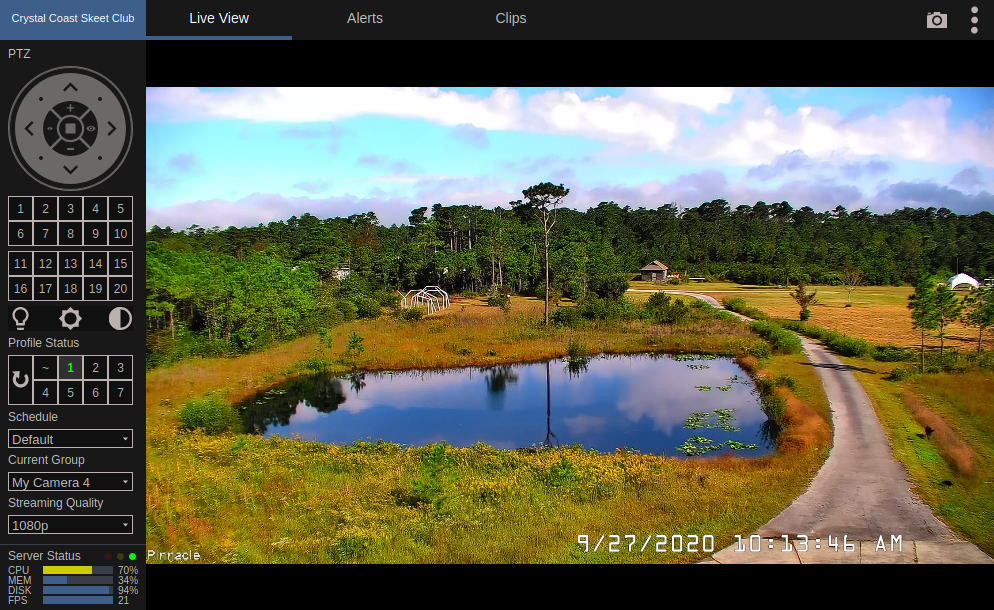

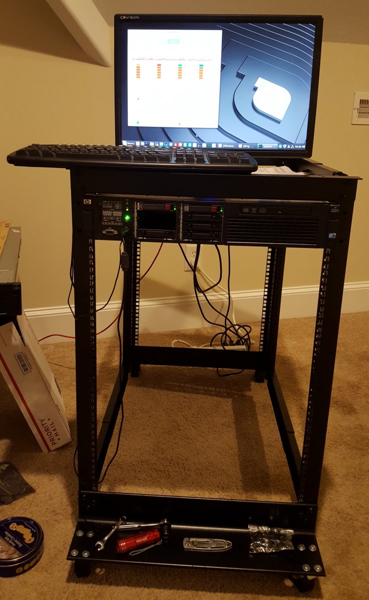

I tried using Zoneminder, but it uses a lot of resources converting real video into motion jpg. I decided that Blue Iris ver 5.x is a better mousetrap. I run my surveillance system on a DL-380 gen7 server. I use ESXI (a thin VMWare client) and run Windows 10 for Blue Iris. Have 4 cams on it now, and it can handle many more. DL380 has 24 cores and 32G of Memory.
I discovered that the cameras can be set to do mjpg, but the user interface on Blue Iris is very nice. I was not impressed with ZM's

Unless you just can't deal with a rackmount size server, they are a very affordable platform. Whether you choose DELL or HP they offer better cooling fantastic CPU's and Memory for a fraction of the prices that desktop machines cost. I've been using USED drives from sellers that warranty them for a year, and in some cases two years. I recently bought 14 2TB drives for under $300 with drive caddy's. I prefer HP myself. The equipment is really great.
