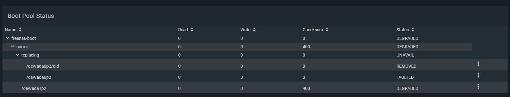

Ok so my new SSD arrived and i was thinking of atleast letting the bootpool try and resilver to that one. Why? Because i have split my SSD mirror into a bootpool and a fast storage area (for emby & potentially VM's although that doesn't seem to benefit from the fast storage). If i just do a reinstall on of the bootpool then i'll loose my emby data too which i'm not a fan off.
So my question then becomes, can i just do replace on ada1 and plugin the new drive in it's slot with a boot pool that looks like the picture i'm adding.

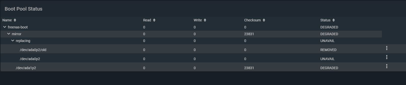

After a reboot the pool status now says something else. Don't really understand why. (the reboot was for a change of UPS)
Edit: I did a scrub on the bootpool to see what it said and it went back to UNAVAIL for my ada0 drive, does unavail mean that it can't see it? Because i can't find it in the documentation.

Think i'll try to replace the ada1 drive tomorrow and see what happens, as long as i backup first i should be good i think.
Jerren
Apr 15, 2020
84
Because i need to replace the ada1 drive i figured i should detach the old ada2 drive so the replace group isn't on ada2 anymore. But i got a problem that pops up: [EZFS_NOTSUP] Can detach disks from mirrors and spares only
Error: concurrent.futures.process._RemoteTraceback:
  File "/usr/local/lib/python3.7/site-packages/middlewared/plugins/zfs.py", line 247, in __zfs_vdev_operation
    op(target, *args)
  File "libzfs.pyx", line 369, in libzfs.ZFS.__exit__
    op(target, *args)
  File "/usr/local/lib/python3.7/site-packages/middlewared/plugins/zfs.py", line 256, in <lambda>
    self.__zfs_vdev_operation(name, label, lambda target: target.detach())
  File "libzfs.pyx", line 1764, in libzfs.ZFSVdev.detach
libzfs.ZFSException: Can detach disks from mirrors and spares only
  File "/usr/local/lib/python3.7/concurrent/futures/process.py", line 239, in _process_worker
    r = call_item.fn(*call_item.args, **call_item.kwargs)
  File "/usr/local/lib/python3.7/site-packages/middlewared/worker.py", line 97, in main_worker
    res = loop.run_until_complete(coro)
  File "/usr/local/lib/python3.7/asyncio/base_events.py", line 579, in run_until_complete
    return future.result()
  File "/usr/local/lib/python3.7/site-packages/middlewared/worker.py", line 53, in _run
    return await self._call(name, serviceobj, methodobj, params=args, job=job)
  File "/usr/local/lib/python3.7/site-packages/middlewared/worker.py", line 45, in _call
    return methodobj(*params)
  File "/usr/local/lib/python3.7/site-packages/middlewared/schema.py", line 965, in nf
    return f(*args, **kwargs)
  File "/usr/local/lib/python3.7/site-packages/middlewared/plugins/zfs.py", line 256, in detach
  File "/usr/local/lib/python3.7/site-packages/middlewared/plugins/zfs.py", line 249, in __zfs_vdev_operation
    raise CallError(str(e), e.code)
middlewared.service_exception.CallError: [EZFS_NOTSUP] Can detach disks from mirrors and spares only
The above exception was the direct cause of the following exception:
  File "/usr/local/lib/python3.7/site-packages/middlewared/main.py", line 130, in call_method
    io_thread=False)
  File "/usr/local/lib/python3.7/site-packages/middlewared/main.py", line 1084, in _call
    return await methodobj(*args)
  File "/usr/local/lib/python3.7/site-packages/middlewared/schema.py", line 961, in nf
  File "/usr/local/lib/python3.7/site-packages/middlewared/plugins/boot.py", line 214, in detach
    await self.middleware.call('zfs.pool.detach', 'freenas-boot', dev)
  File "/usr/local/lib/python3.7/site-packages/middlewared/main.py", line 1141, in call
    app=app, pipes=pipes, job_on_progress_cb=job_on_progress_cb, io_thread=True,
  File "/usr/local/lib/python3.7/site-packages/middlewared/main.py", line 1081, in _call
    return await self._call_worker(name, *args)
  File "/usr/local/lib/python3.7/site-packages/middlewared/main.py", line 1101, in _call_worker
    return await self.run_in_proc(main_worker, name, args, job)
  File "/usr/local/lib/python3.7/site-packages/middlewared/main.py", line 1036, in run_in_proc
    return await self.run_in_executor(self.__procpool, method, *args, **kwargs)
  File "/usr/local/lib/python3.7/site-packages/middlewared/main.py", line 1010, in run_in_executor
Did this pop up because i didn't detach the old drive before these problems popped up or is there another reason?
Jerren
Apr 15, 2020
84
So i'm a feeling a bit like an idiot stumbling around in the dark here. I tried to unplug the ada0 drive because i figured it kept saying unavail and couldn't be removed. So i shutdown the machine, unplugged the drive and then booted back up and detach the old drive. Shutdown again and plugged the ada0 drive back in only to see it didn't appear in the boot pool drive list anymore (which i think is odd since i removed the old one not the one that seemed to still be in use). Now it seems the machine still runs and is able to boot but to say i'm uncomfortable doing more is an understatement.
I considered reinstalling for a brief moment but i read in some posts that you should export disconnect your storagepools before doing that. However when looking at the "export/disconnect" it gives me an option to delete configuration of shares that used this pool. It seems i would not want that right? So when i reinstall, everything has their rights still? Or should i redo everything?
So currents status, i'm running on 1 SSD that has an increasing amount of checksum errrors and as a result a bootpool that's degraded.
Does anyone have clear tips or a guide somewhere for such a situation? I'm at a loss right now because i don't know anything about this procedure yet and as such i can't use other people's topics at the moment to try and compare them to my own situation.
At this point i think it's smartest i wait for someone to respond and not touch the machine untill some more qualified people then me jump in.
