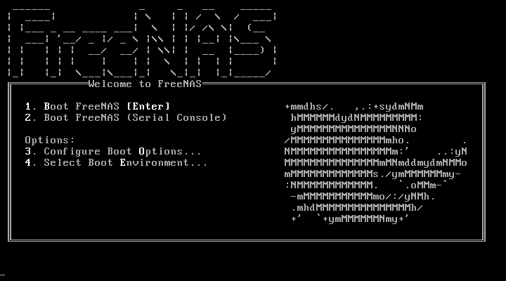

You could just reboot back to your 9.10 boot environment. When the boot menu appears, select 4.
Thanks, I was able to get it back up. Will that selection survive a reboot, or is there something I need to do to make it permanent?
Look in Sytem->Boot. Make sure your 9.10 environment is depicted with the "On Reboot" flag. You may also want to delete the 11.3 boot environment.
