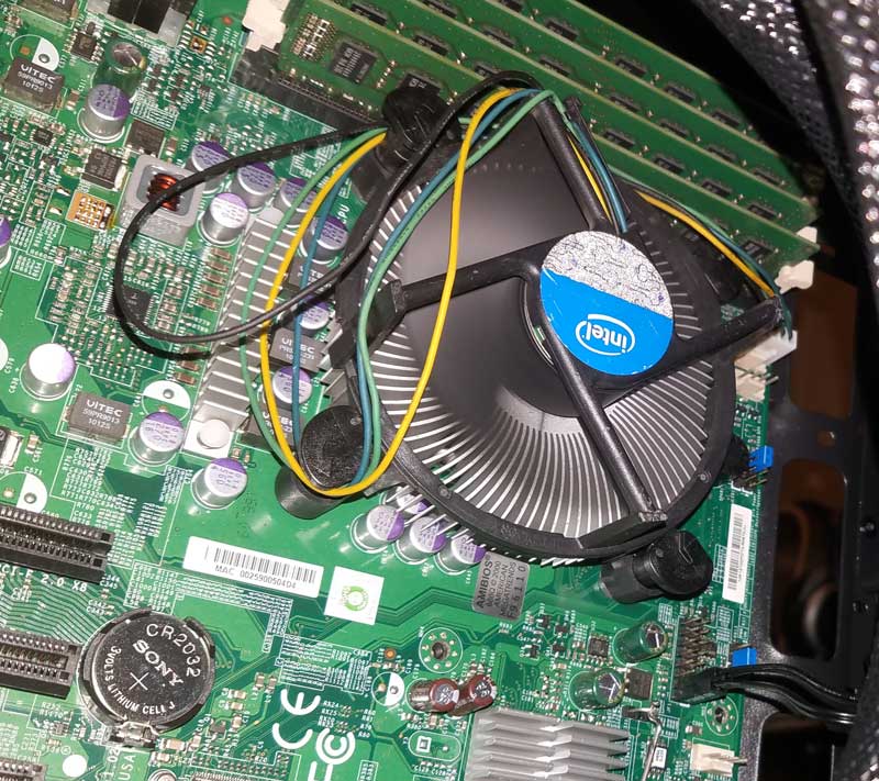

I have used several generations of Xeons on home servers and homelab servers and always just used the stock cooler. Unless you have problems with the sound (noise) and/or temperature I would not bother. Most of the time your CPU will not work all that hard. It's not a gaming rig. Though I must admit that the stock coolers are uglyI'm currently using the stock CPU cooler
Looks like you are nicely on your way.
I have used several generations of Xeons on home servers and homelab servers and always just used the stock cooler. Unless you have problems with the sound (noise) and/or temperature I would not bother. Most of the time your CPU will not work all that hard. It's not a gaming rig. Though I must admit that the stock coolers are ugly![]()
