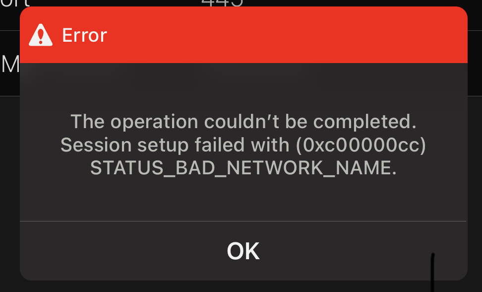

I have mostly made the transition to TrueNAS and SMB in general. As part of that process, I nuked my old pool and rebuilt it with a 3-way sVDEV, etc. That also meant redoing all the shares and that’s where I am currently failing.
I keep getting errors from PhotoSync as it cannot connect using the same exact credentials as before. I know the password login is good since I can browse the network volumes, yet, no transfer can take place. I tried using traditional permissions as well as the preferred ACL approach, yet I fail consistently.
so here is my plea: can anyone enjoying PhotoSync and TrueNAS happiness share how they set up their ACL permissions or traditional unix permissions? What does the command line show re: owners/groups? I’m not picky, I just want it to get to work again!
fwiw, I set my PhotoSync user to be the owner and the PhotoSyncuser group to be the group owner. Full permissions for both, recursive file permissions applied to directories and contents alike, etc. Yet I get SMB error bad network name which in the past was a permissions issue.

As best as I can tell, the client can log in successfully because I can browse among network shares in the iOS app. Presumably, I wouldn't be allowed to browse unless my login / password had been accepted by the server? Yet, I still end up with a BAD NAME ERROR or a 36 error when I try to upload images. I just reran the permissions today and noted one weird issue.
The parent directory is called PhotoSync and has two sub-directories that are also shareable - one is called PhotoSync_CvW, the other PhotoSA, one for each user. The subdirectories show a 771 permissions with the applicable user login as the owner of each as well as the PhotosyncUser group. Yet, when I drop down into PhotoSync_CvW, the directory listing ("..") shows a different account as the user owner . Just weird. I wonder if I need to destroy this dataset and start over.

I'm running U3 now and the latest error I get when trying to transfer is "36". I presume that is a permissions issue?
anodos
Sambassador
Mar 6, 2014
9,553
Possibly. Check output of `testparm -s`. May sure your share exists. If it does, run command smbclient //127.0.0.1/<share_name> -U <photosync_user_name> to verify that you have basic access to that share. If you can access, run "ls" to verify that you can list directory.
BAD_NETWORK_NAME errors usually mean either (1) share doesn't exist or (2) path for share doesn't exist.

This issue is now solved. @anodos was incredibly helpful, walking me through multiple levels of diagnostics to figure out what is going on. He identified that the PhotoSync iOS app seems to be dropping the underscore from the network share name, even if the name was selected from a list of browsable shares in the PhotoSync App menu.
The developer was also very responsive but initially was not able to reproduce the problem on his Synology. However, once he used the same share name as I did (PhotoSync_CvW), he was able to reproduce the error on his end too. This was made possible by the great help of @anodos by turning the SMB error collection setting to full (Services -> SMB -> Log Levels) followed by him looking through the debug log files once I had fired up PhotoSync on my iPhone, tried to setup SMB twice (which resulted in the Bad_NAME_ERROR), and also attempted transfers twice (which would throw a SMB 36 error).
So thank you, @anodos!
I was able to resolve the name issue by simply removing the underscore from the share name I use for PhotoSync. Now it synchronizes happily.
