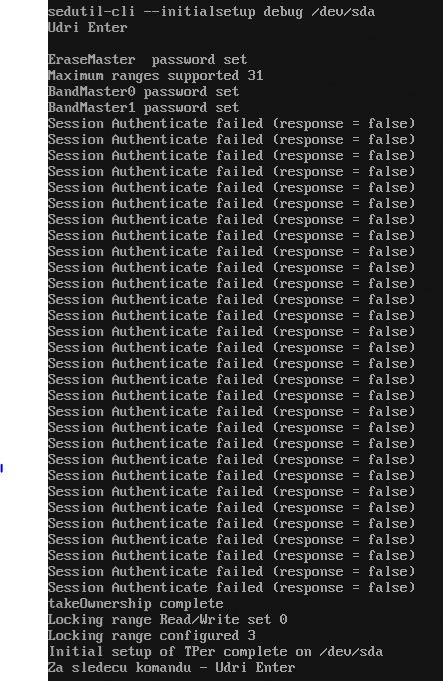

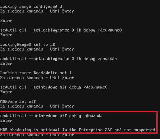

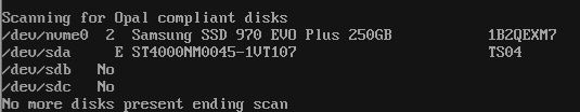

I have a similar problem, with a disc "Seagate Exos 7E8 ST4000NM0045". The problem occurs with the command "sedutil-cli --initialsetup debug /dev/sdc" output on "Pic1". When I start the scan command, I get the output on "Pic2". Also with the command --setmbrdone off debug /dev/sda I get a output "Pic3". Does anyone know how I can encrypt the TCG Enterprice hard disk drive?
Thanks in advance
