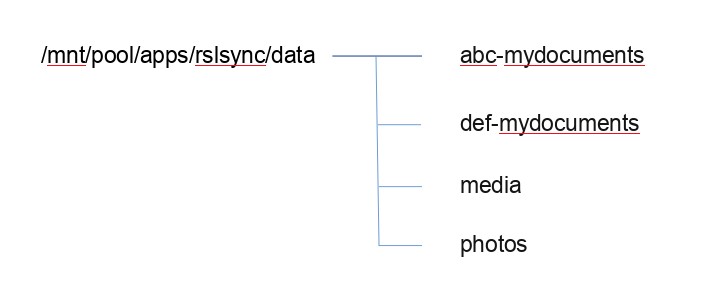

I was planning to have different shares in different datasets and pools.
eg:
/mnt/pool1/abc-mydocuments
/mnt/pool1/def-mydocuments
/mnt/pool2/media
/mnt/pool2/photos
In the jail, these would appear as:
/media/abc-mydocuments
/media/def-mydocuments
/media/media
/media/photos
At the same time, I want to make sure that any file or directories written to /media, that do not fall into an existing dataset, will be written to /mnt/pool/apps/rslsync/data. The reason for this was, when I was first experimenting with this jail, I failed to mount /media correctly; and when I dropped a share into it, freenas-boot filled up, and the system fell over - to the point where I couldn't even perform a configuration reset without assistance from support.
The alternative might be to make /media itself non-writable? But that didn't seem like a very good way to do it...
Thanks for any advice.

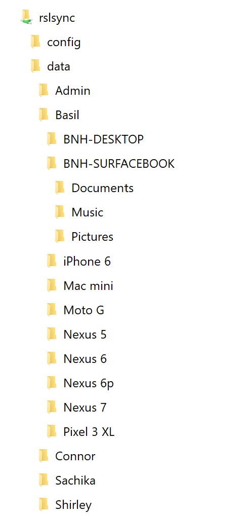

Extract from the install README:
  • DATA_PATH: Selective backups are stored in this path; defaults to $POOL_PATH/apps/rslsync/data.
Your backups are stored below the DATA_PATH within a specified pool.
You can create child datasets under this DATA_PATH and map those to shares if you so desire.
My personal preference is just to map the rslsync root to a single share and then restrict user access using ACLs e.g. selective backups for a user's device are stored under a user directory root within the DATA_PATH under the rslsync share. The user has read access to the backups under their directory root. The user's directory root is invisible to other users apart from an administrator.
I see. Does this mean it is not possible for resilio to access datasets that are in a different pool?
One option might be to add a second rslsync jail with a DATA_PATH that refers to a different pool.
