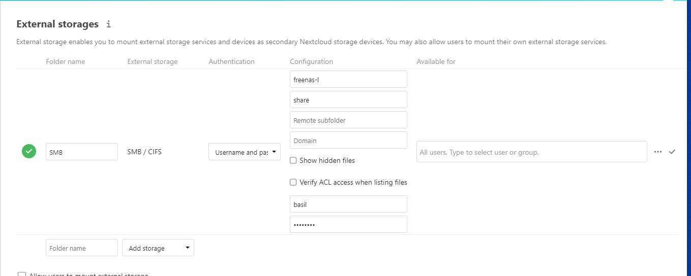

One question, I've mounted a few datasets to Nextcloud jail to be used as local external storage (using plugin app). Is it enough that user 'www' belongs to these datasets' group or must be datasets' owner?
Jan 4, 2014
1,644
I've only used SMB external storage. Authentication is via username and password.
