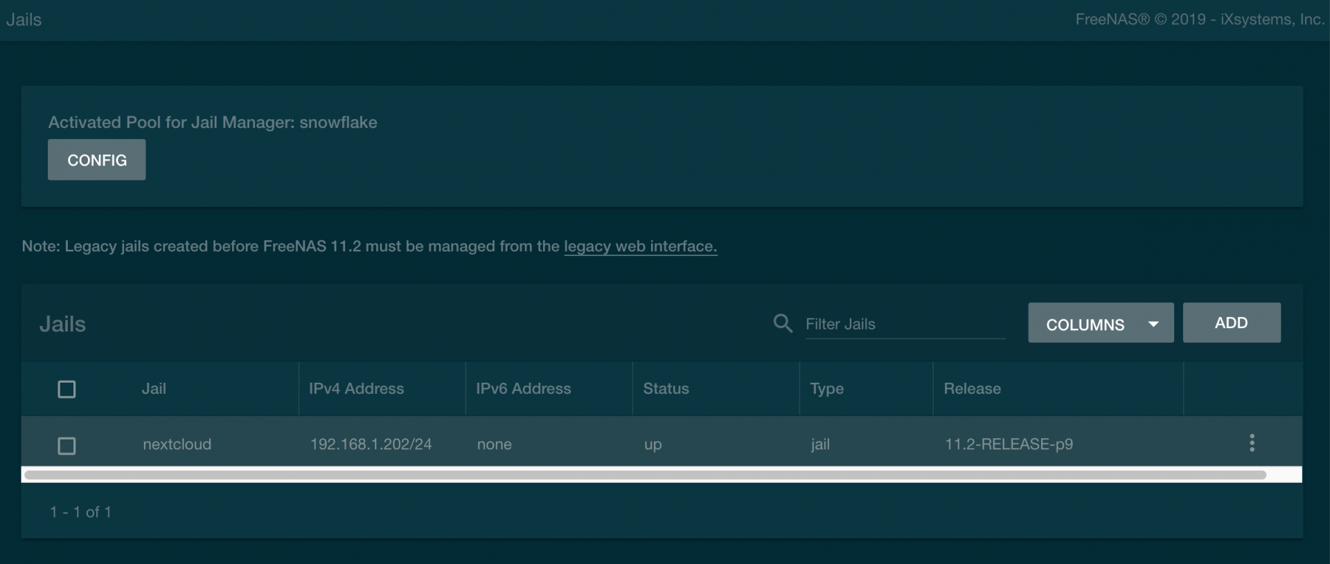

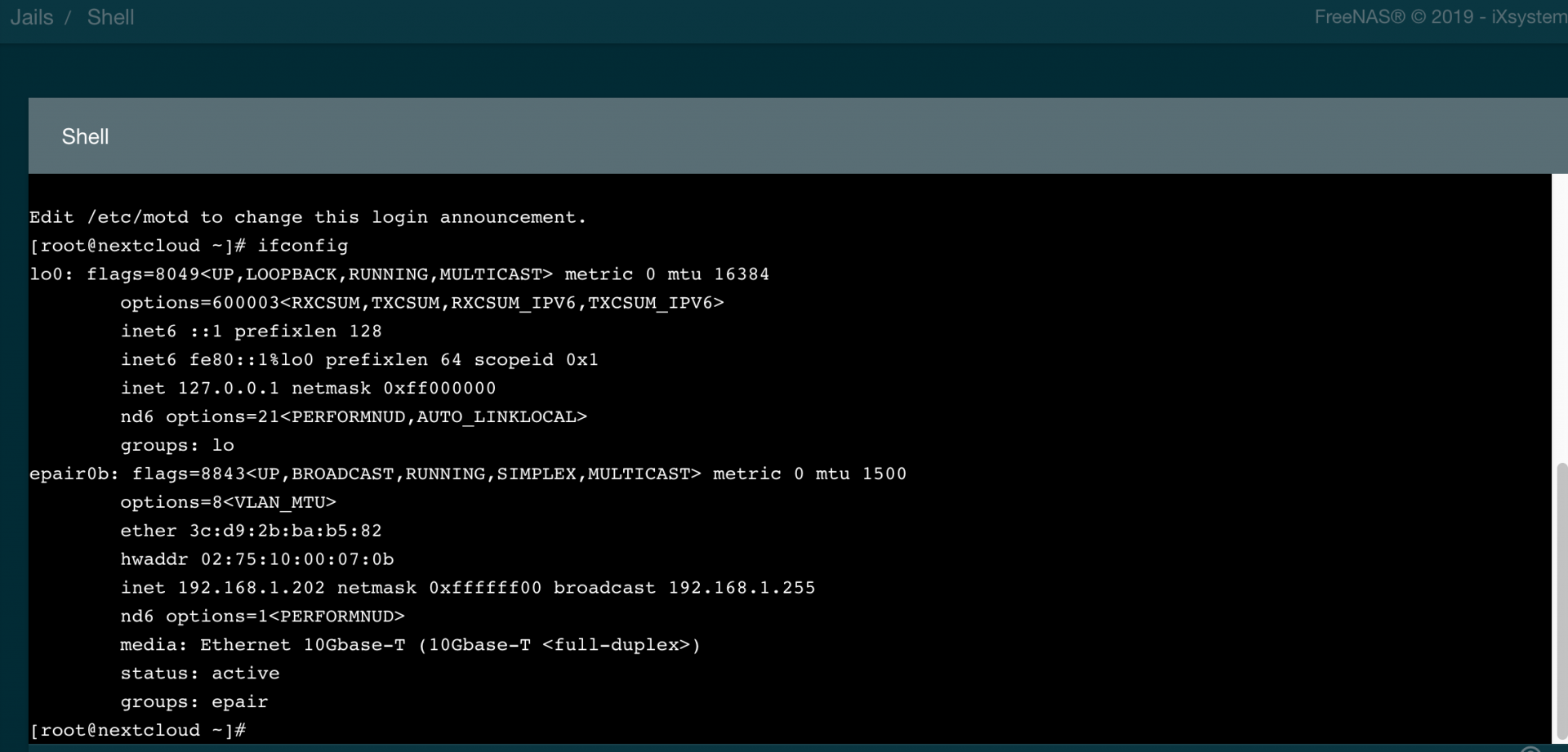

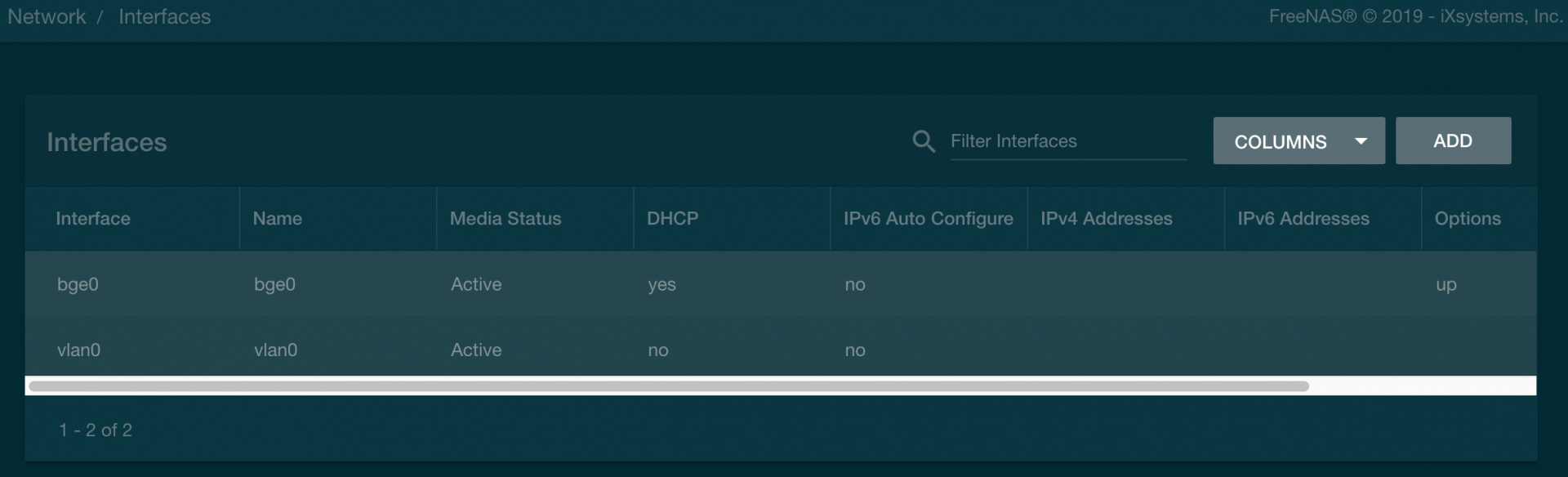

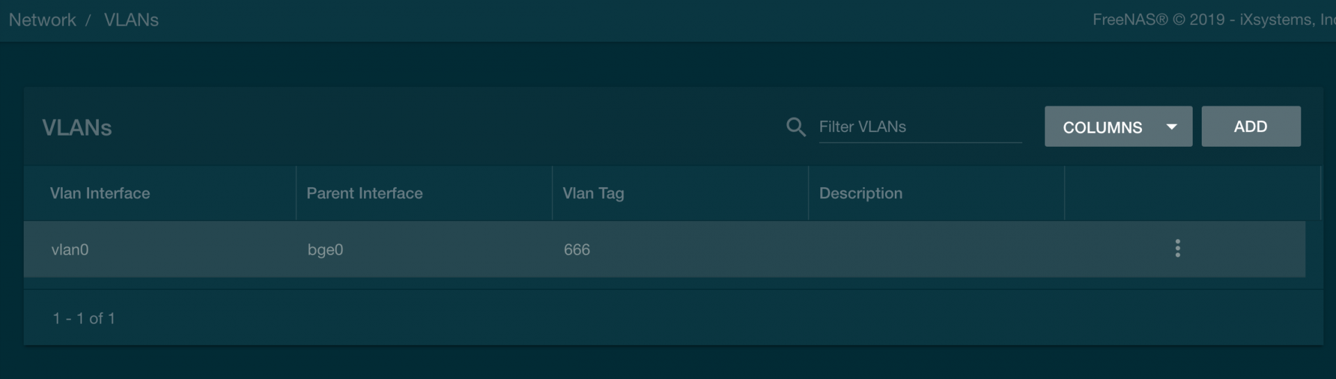

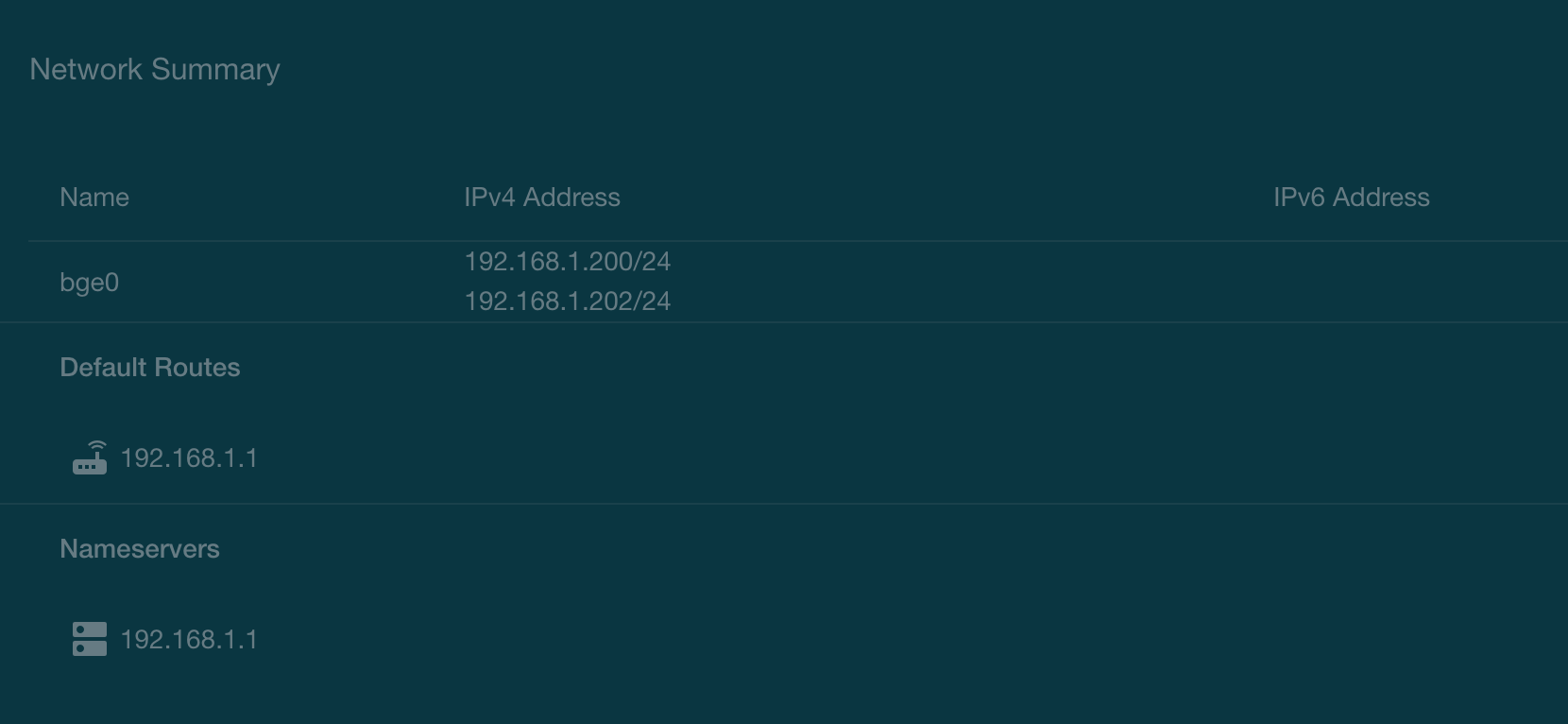

I am having a strange issue. I tried installing the script half a year ago but every time after script install was done i entered the ip in the webbrowser to access nextcloud and then it showed me the login screen of my freenas server.
now i wanted to try again with freenas 11.2-U3 and i still have the same problem.
here's my cfg:
JAIL_IP="192.168.1.202" # FreeNAS runs on 192.168.1.200
DEFAULT_GW_IP="192.168.1.1"
INTERFACE="bge0"
VNET="off"
POOL_PATH="/mnt/snowflake"
JAIL_NAME="nextcloud"
TIME_ZONE="Europe/Vienna" # See http://php.net/manual/en/timezones.php
HOST_NAME="xxxxxxxxx.com"
DATABASE="mariadb"
STANDALONE_CERT=1
DNS_CERT=0
SELFSIGNED_CERT=0
NO_CERT=0
TEST_CERT=""
also at my freenas dashboard it shows the new 192.168.1.202 ip instead of 200 like before running the script and creating the jail.
when i go to network adapters it shows both ip addresses with my bge0 adapter:
blowfish
Apr 22, 2019
3
thanks i'll try that. how can i get rid of all the iocage stuff, clean up db and files dataset and start from scratch?
blowfish
Apr 22, 2019
3

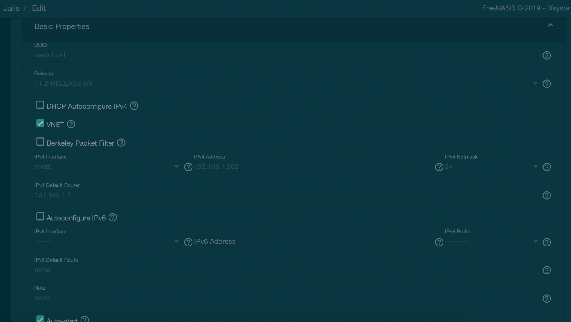

I'd suggest using vnet. Set the interface to "vnet0" and vnet to "on".
i did a re-install and reset the browser cache but cant connect to 192.168.1.202 (Jail). any suggestion? is there anything for vnet to adjust in freenas itself?
