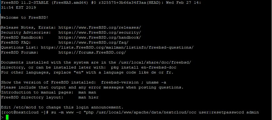

Ok I tried to change but once again the output is ">", see screenshot
hafnix
Mar 24, 2019
24
Yes, this way it works
su -m www -c "php /usr/local/www/apache24/data/nextcloud/occ user:resetpassword admin"
And itis in apache24
Thank you very much :):D:)
