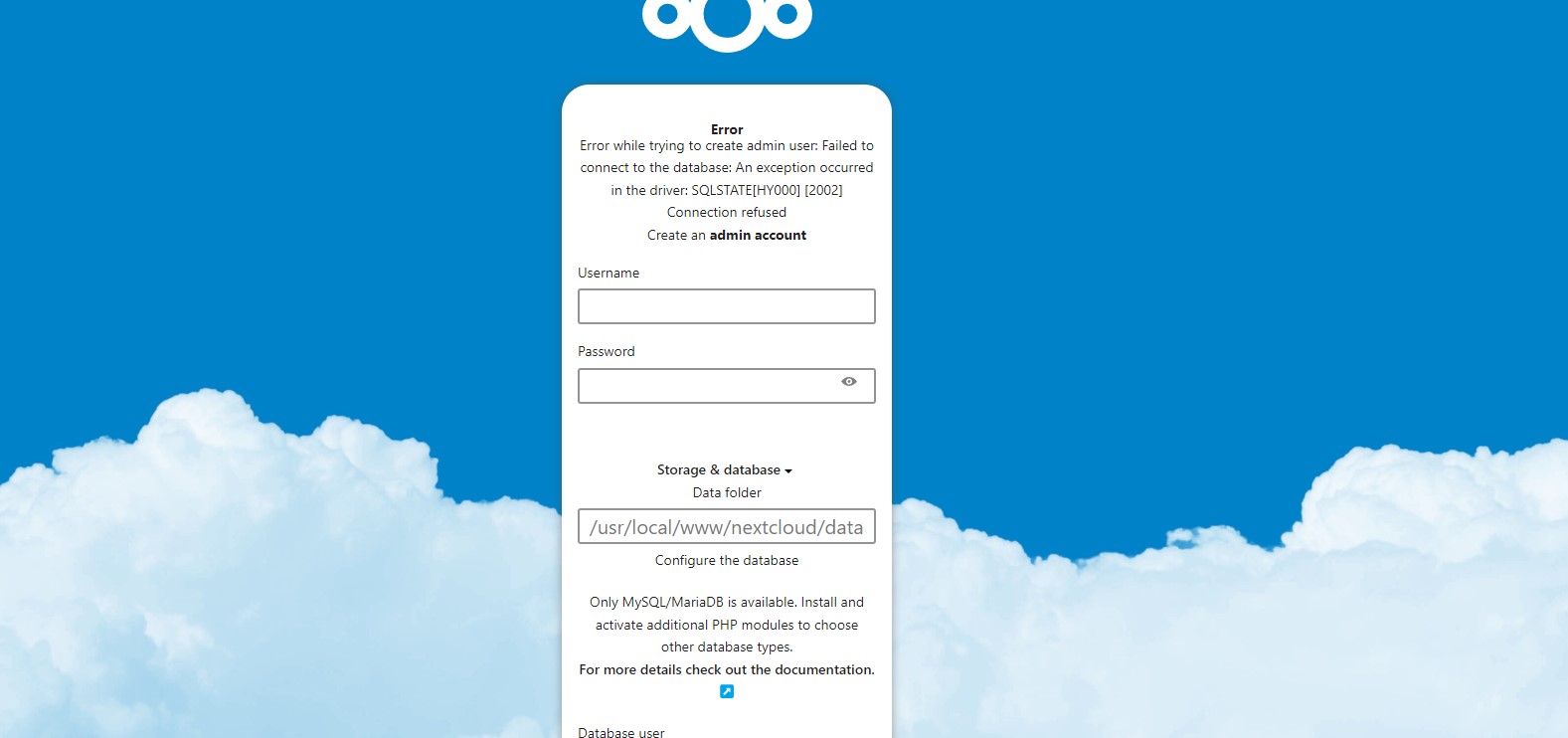

bnorman93
May 3, 2022
17
I have sucessfully destroyed my install of nextcloud and when trying to reinstall i am seeing a window i have never seen before and what i keep being told is to use my old mariadb password and database location which i have no idea where it is....
MariaDB respects hier(7) and doesn't check /etc and /etc/mysql for
my.cnf. Please move existing my.cnf files from those paths to
/usr/local/etc/mysql or /usr/local/etc. Sample
configuration files are provided in /usr/local/etc/mysql
and /usr/local/etc/mysql/conf.d.
The rc(8) script no longer uses /var/db/mysql/my.cnf for configuration
nor /var/db/mysql for logs and PID-file.
Ive tried everything i know to try and create this wndow
I got this when trying to use port 9000
Error while trying to create admin user: Failed to connect to the database: An exception occurred in the driver: SQLSTATE[HY000] [2006] MySQL server has gone away
victort
Dec 31, 2021
973
Try reading this.
Make sure to read it all. There are two steps to it.
1. Deleting the my.cnf file
2. Changing the value of 'db' in your config.php
Then you can reinstall.
