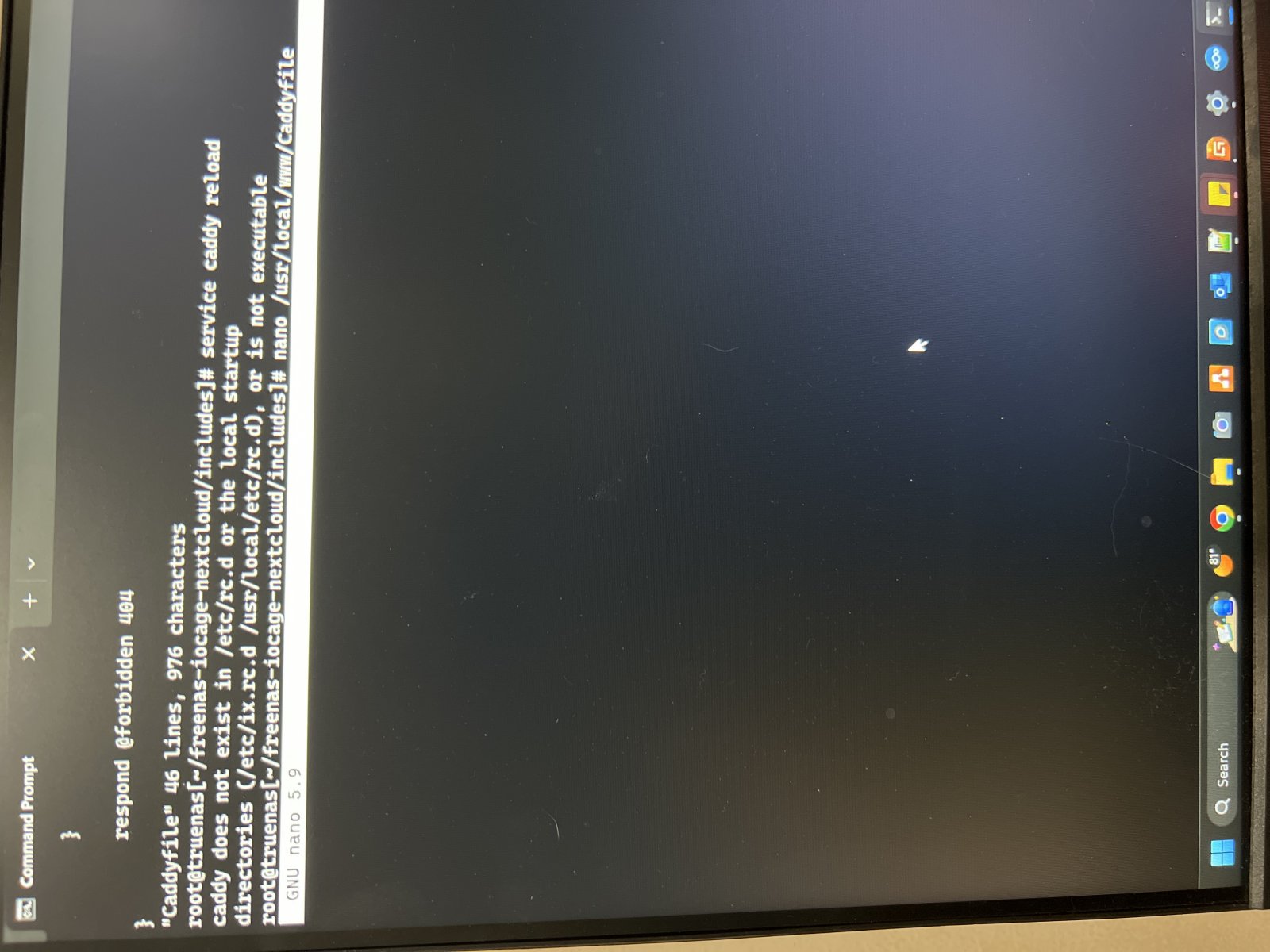

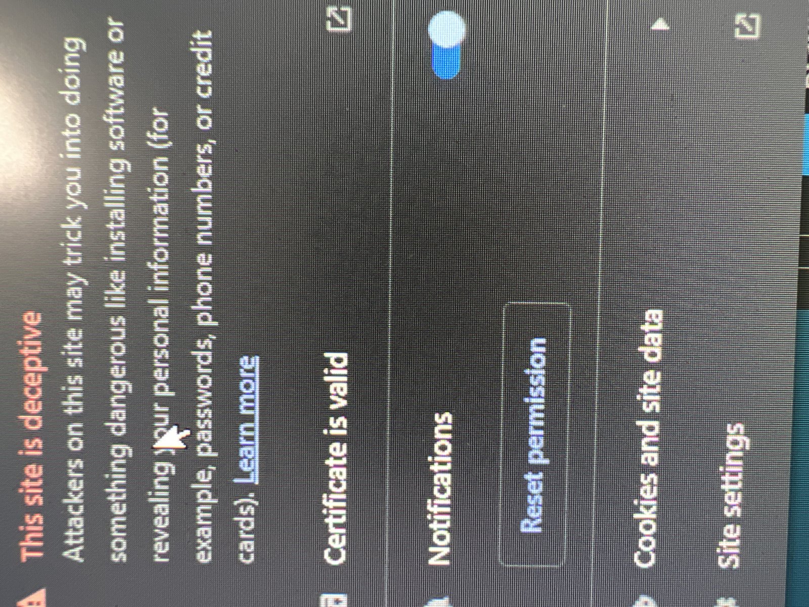

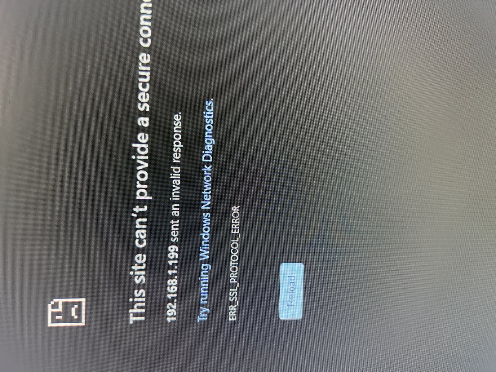

I can’t access the ip range on the local ip it’s says this, I seen where someone else was having this issue but they Resolved it I tried to message them but no reply yet

I'm sure my chiropractor will appreciate the crick in my neck from trying to read the sideways image. But the "this site is deceptive" generally means your domain name is listed in the Google Safe Browsing list as unsafe.
As to reaching your site by IP address, that isn't expected to work; it needs to be by name.
Sorry my phone rotated them for some reason and I was trying to mount the volume locally is the only reason I tried to use the ip couldn’t get WebDAV or others to work for me for some reason. I can’t find the config files neither like Nginx has I tried looking in Apache directory but still no success trying to get rid of the “dangerous” thing in the top bar but I have to edit a file that makes the webpage but I can’t find it.. it’s also not allowing me to turn on server side encryption you can click it but the button doesn’t do anything

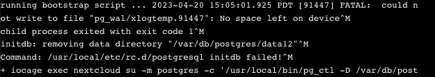

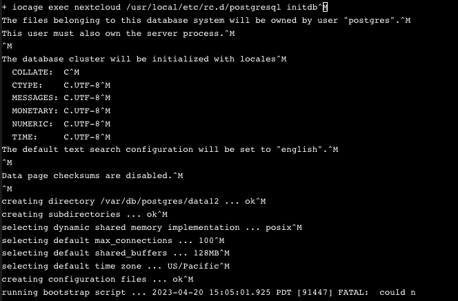

Creating the Nextcloud database failed, which caused the installation failure (which resulted in the screen you saw, rather than a normal login page). There should still be something further up--i.e., earlier--in the log file indicating what went wrong with the database.
a couple more data points
1. the Nextcloud plugin in TNCore brings up the app as expected (ducking low)
2. The other DATABASE option pgsql also fails for me
so once the script enters that section - line 456+, it breaks for me. I can't see anything flagging before that.
